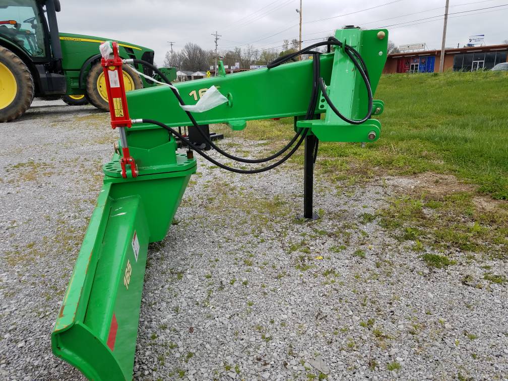

Industrias Americas makes a real good heavy duty rear blade. They also have box blades. Prices are about 50% of a comparable Land Pride.

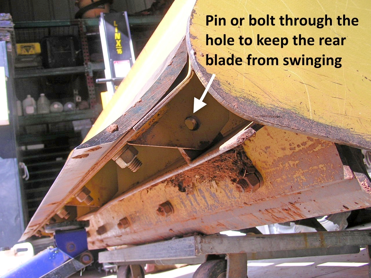

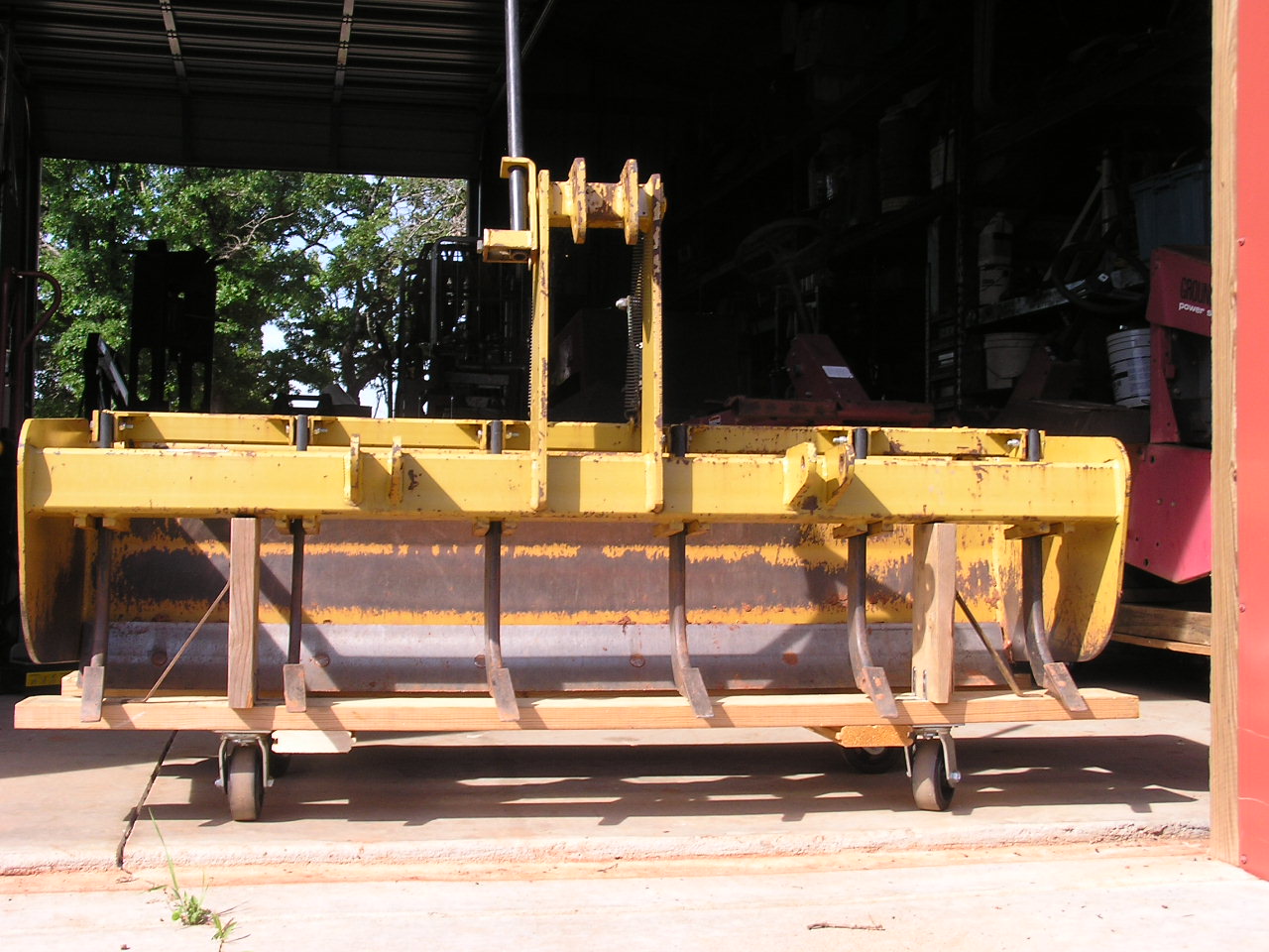

Look for one that is a high back model with a hinged tailboard. Mine also has a lever that operates the rippers, model GBS72R, weighs 647 pounds:
