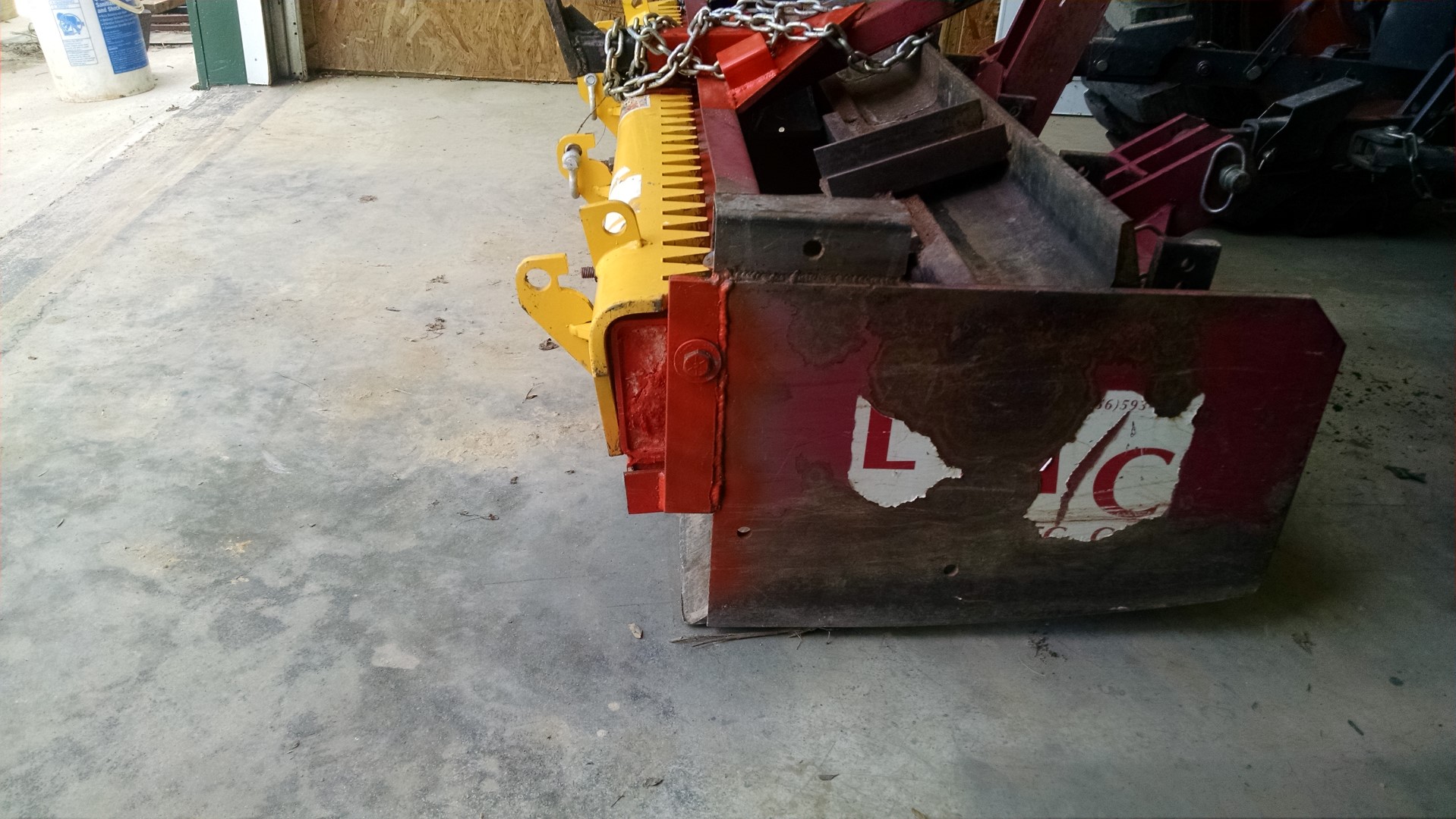

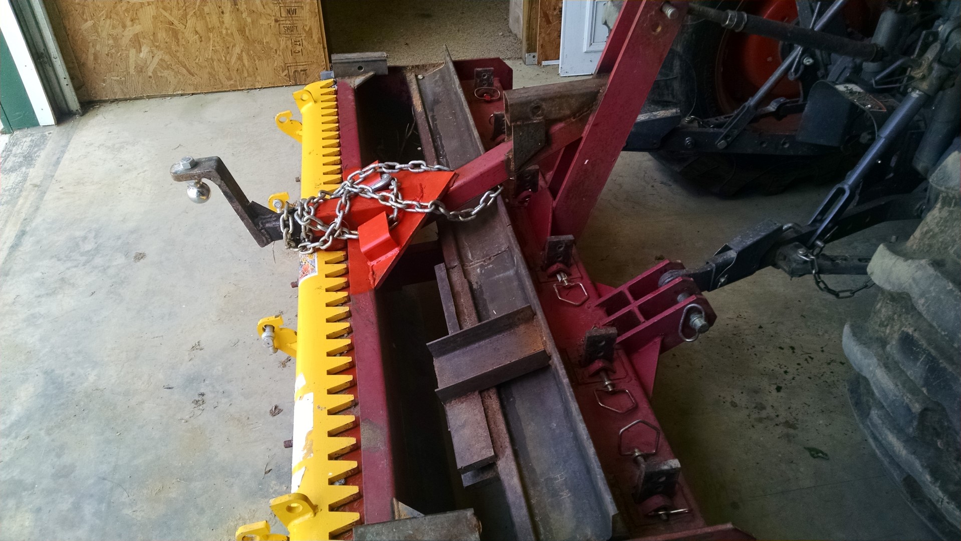

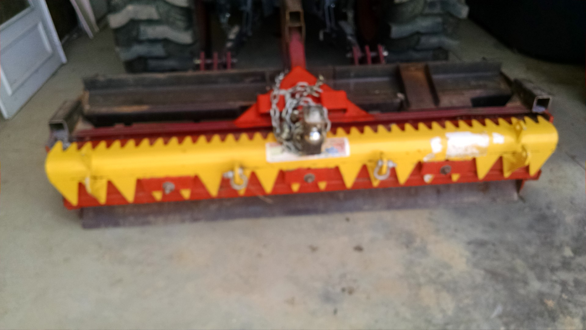

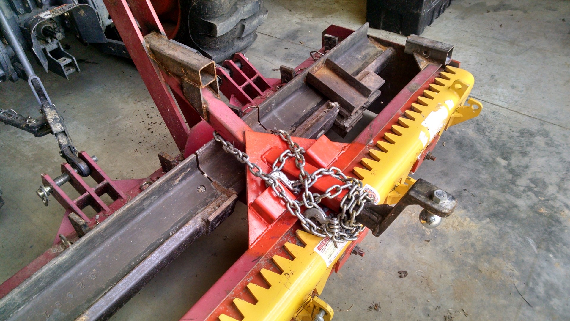

Speaking of weights, anyone have suggestions for adding weight to a BB? I have the EA 78" at 545# and I would like to add 2-300 # to it, preferably a method that won't take paint off or get it the way of scarifier adjustments.
I added an 8x8 steel tube, filled it with steel, lead and concrete and added it to the back of my BB. 410 lbs. I also incorporated some 5/8" bolts so it bolt my 110 lb Ratchet Rake to it as well for a total of 520 lbs. I also added about 6' of 130 lb rail (260 lbs total) but they turned out to be dirt catchers, so I took them off.
Pics:
