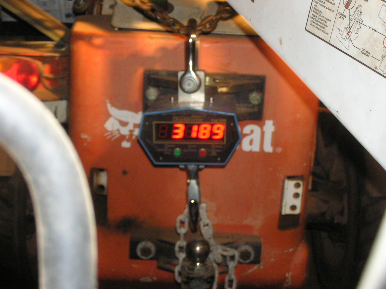

Tested ours with the crane scale, 3,189 pounds at this boom angle:
The bottom of the SSQA was about 6' high, with a chain holding the scale.
It would lift more weight at ground level with pallet forks.
