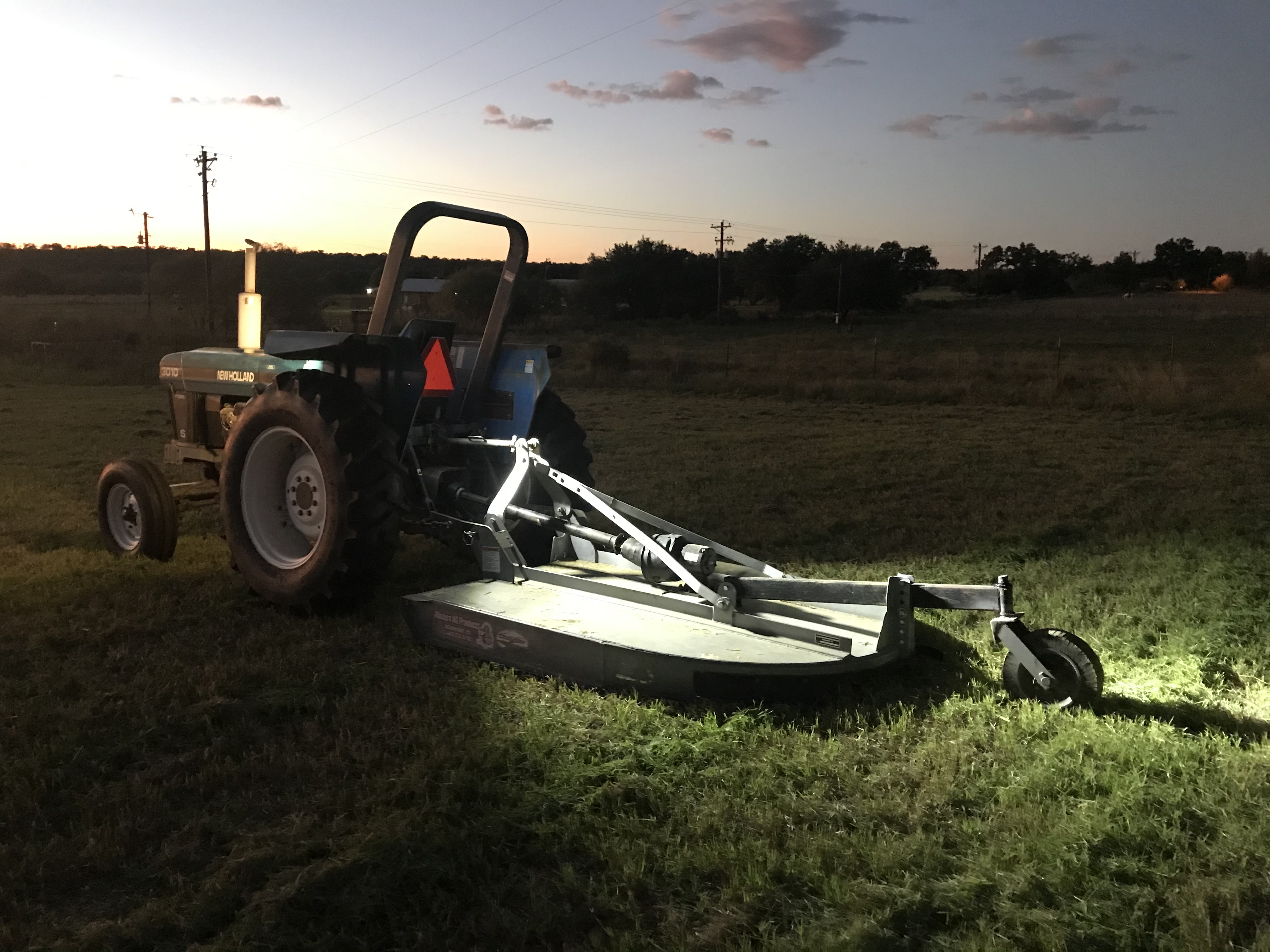

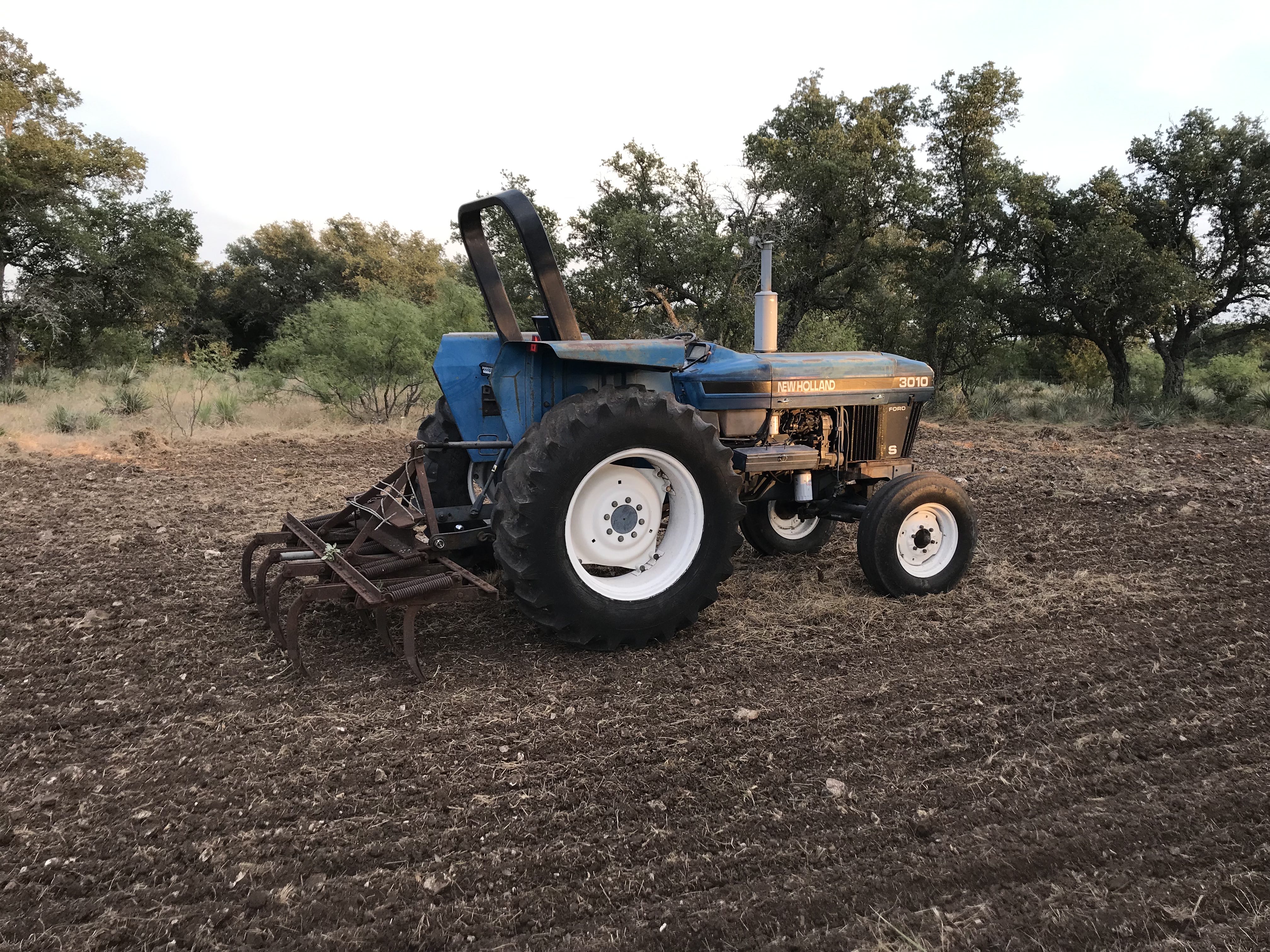

These are good workhorse tractors. My 97 Model 2x4 with 800 hours, and it’s been very reliable as they come. I have a 6’ modern ag shredder and makes the front end little light. Which I’m looking to buy 5-6 counter weights for it. But they are outrageous on the price. Overall a good solid tractor. IMG_0436.jpg
   / NH 3010S opinions? #6
These are good workhorse tractors. My 97 Model 2x4 with 800 hours, and it’s been very reliable as they come. I have a 6’ modern ag shredder and makes the front end little light. Which I’m looking to buy 5-6 counter weights for it. But they are outrageous on the price. Overall a good solid tractor. View attachment 643807
Have a neighbor who has a sprayer tank mounted on the front end of his tractor. Made sense with running hoses to rear mounted boom but noticed he keeps it on there year round. Then realized he used it for front end weight. Filled when he needed weight and if not drained the tank.
   / NH 3010S opinions? #7
That’s not a bad idea. Hopefully I can find some used ones or I just end up making something.
