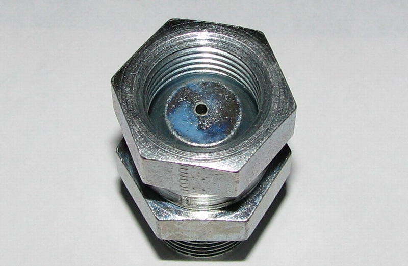

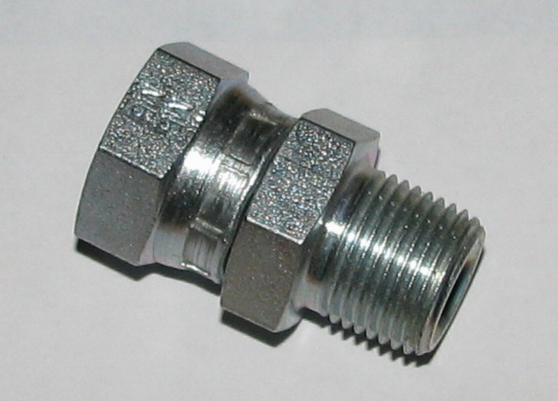

The remotes on your tractor are designed to provide full flow to the remotes. In your case, that's probably 8.5 gpm when the valve is wide open. You can feather the valve to a small extent. You'll hear the engine loading as the valve is moved off center because you are closing down the open-center system to route flow to the remote. I used a single fixed 0.030" orifice in my system and 1/4" hoses. You only need a restrictor orifice in one hose. I'm able to feather my remote lever and my single cylinder grapple can be manipulated nicely with just my remote lever. It does take a soft touch on the lever, but I'm extremely satisfied with my control. I'm just not sure what you mean by your restrictors causing erratic operation.:confused:
Here are photos of my orifices. I buy these for $4.95 each at my New Holland dealer.

When you shut down the orifice toward zero flow the grapple becomes very jerky. I believe now that the grapple I procured is too highly leveraged with the cylinder (small cylinder move, large grapple movement). If I am to use this grapple I believe I need something to isolate the full tractor pressure/flow rate from the grapple circuit other than a straight restrictor. I had tried a .030 orifice on my first try with unusable action. My hoses are probably too large (1/2" and 3/8"). But thanks for your input----
/ NH 3045 Remote Hydraulics Question #9
Can you show a picture of the cyl geometry? I would replace the hoses with 1/4 in, and put a restrictor in the circuit, like jinman did. If your remote valve is to large for the tractor flow, You will not have much feather. Maybe switch to a 10 GPM valve.
