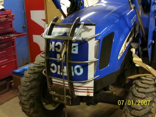

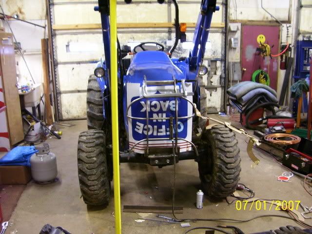

#11
as we begin to tack things together, its important to do so on the tractor to ensure the proper fit. but this also means that a custom made aluminum heat shield is in order...hehe.
here things are beginning to take shape.
and with the additional top and bottom pieces, our new holland exoskeleton is really starting to look good.
and a side view
a folded open view

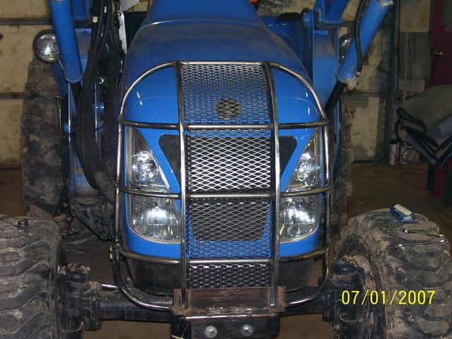

#12
next the addition of some expanded steel...
welded in place...
and the almost finished project...TRACTOR BLING
still have to get the latch attached, but will have to continue that tomorrow.

Looks like a face guard for a hockey player.
Great job! It should do the job. Are you going to paint it NH blue? Let us see the final product. I'd like to know how your hood latch idea works out.

we've been trying to decide if we should go black or nh blue. i'd rather it be black so it was less noticeable and easier to repair if anything needed to be straightened or replaced. as soon as we make the final adjustments and get the latch on, it'll be off to the powdercoater.
