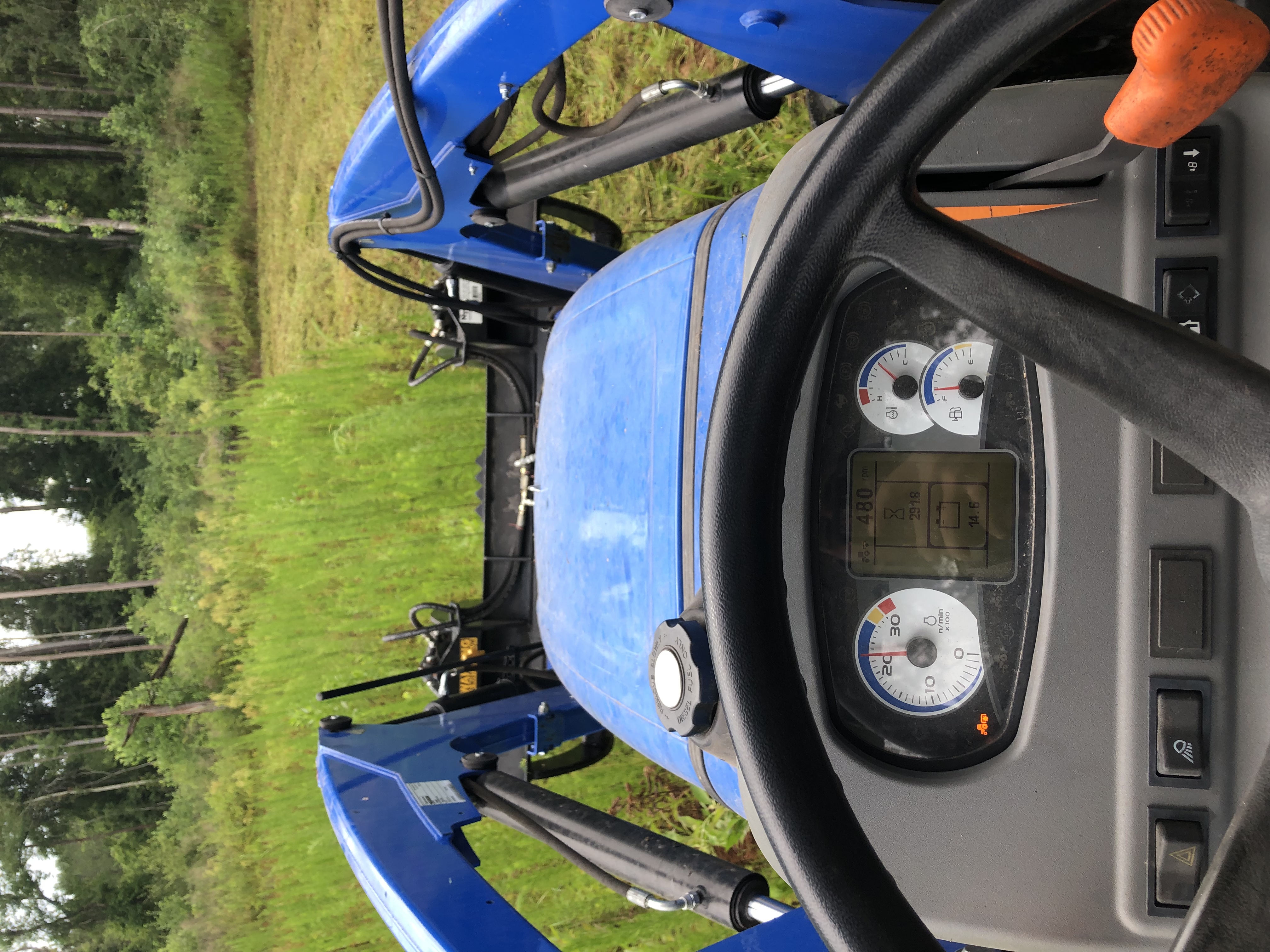

What would I do different? First, if you get a 3rd function see if you can get it where the plumbing is not as exposed as mine is coming out from under the tractor. If you look at the picture with my tractor hooked to the mower you can see the big silver elbow sticking under my step. Also, make sure the new unit has the new ecm flash's you seen us mention in the thread before you leave with it. Outside of that, it's everything I wanted.

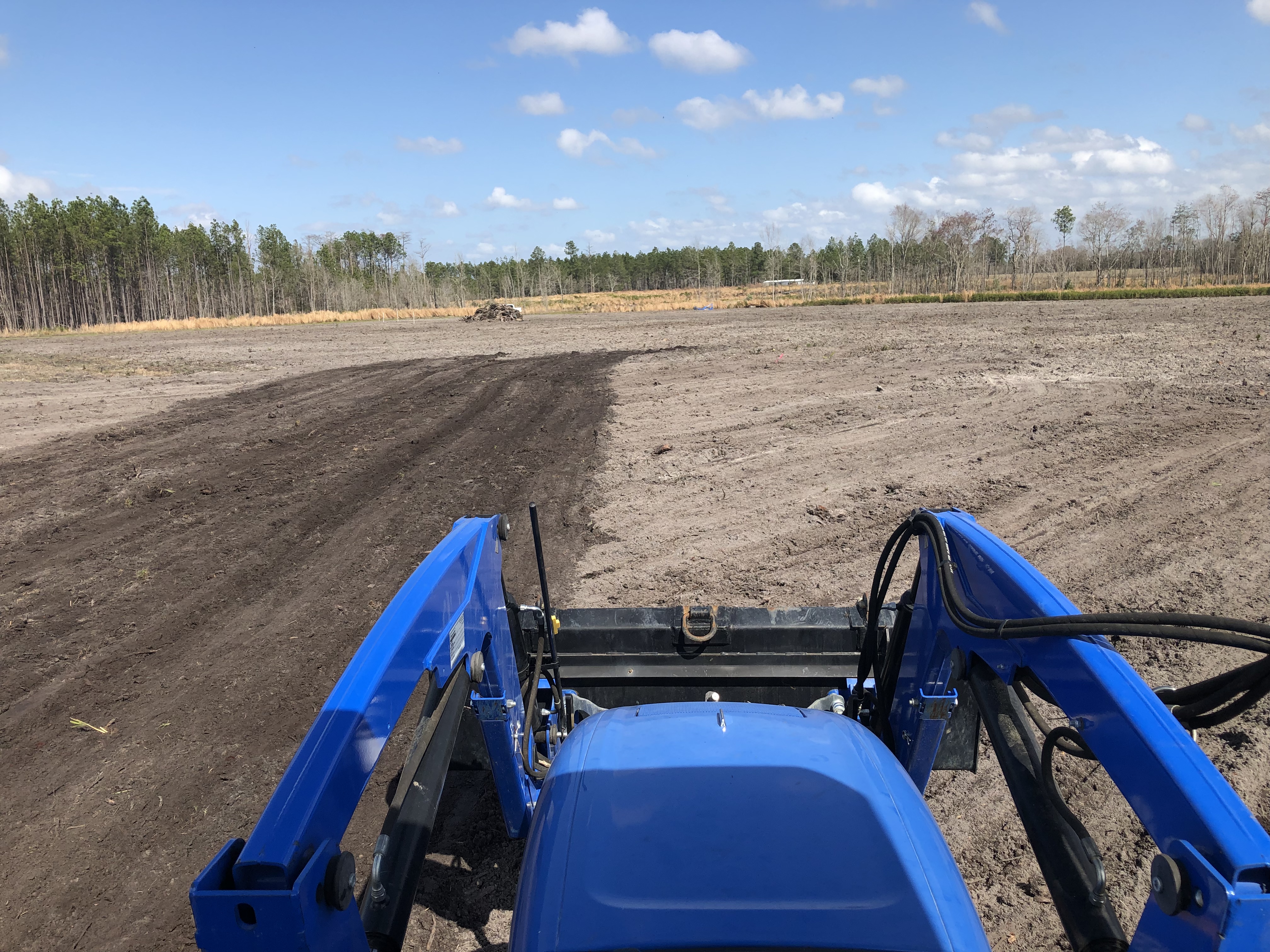

#24

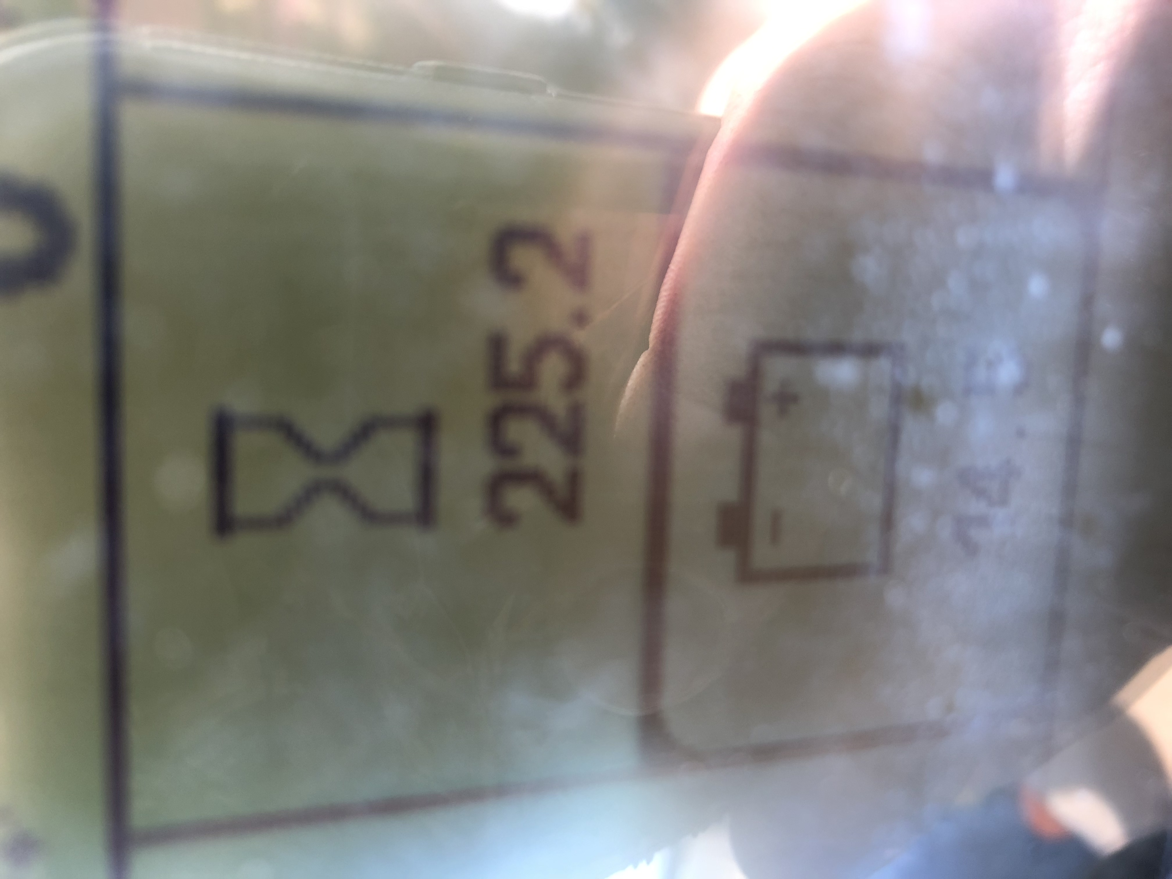

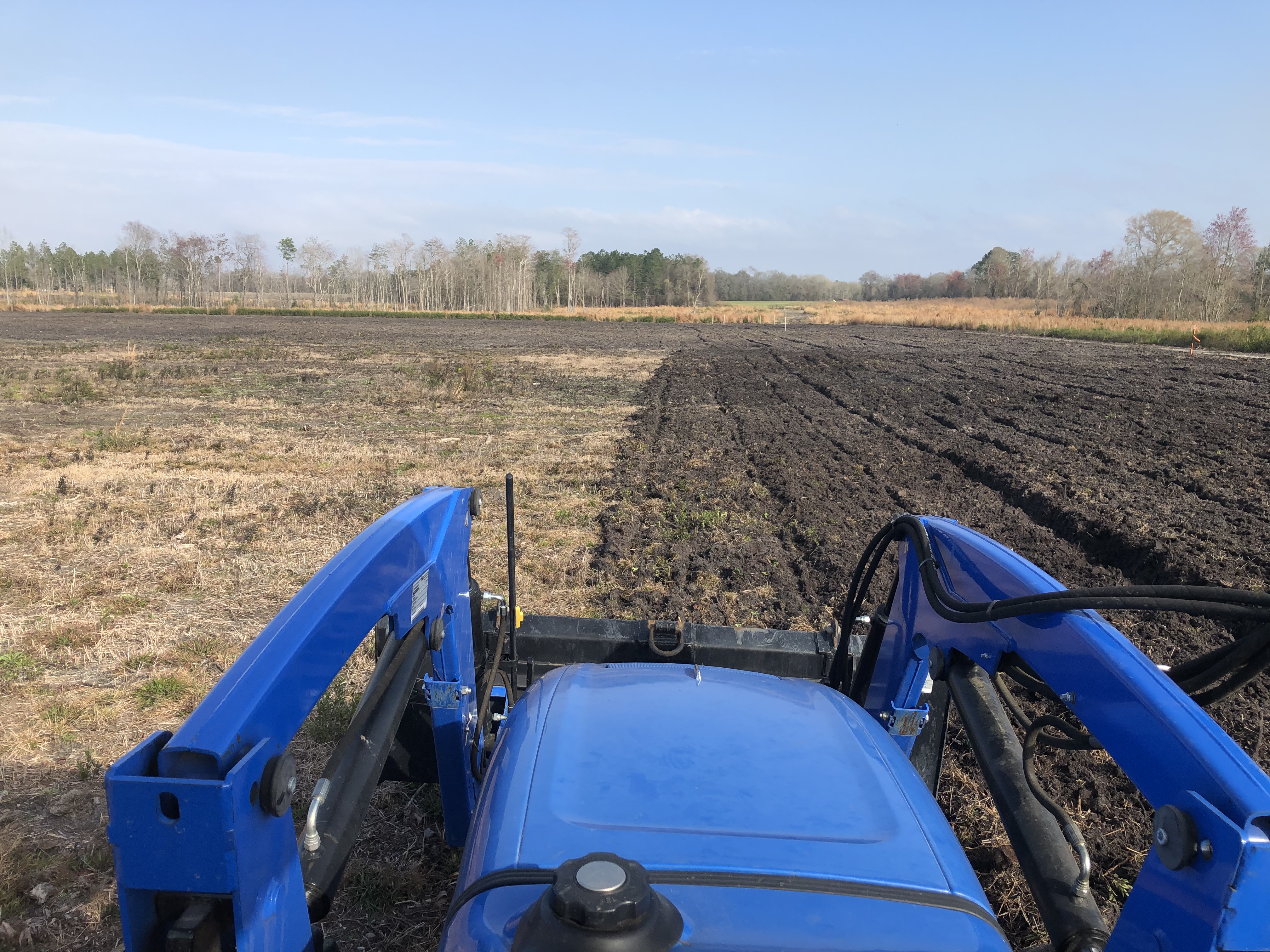

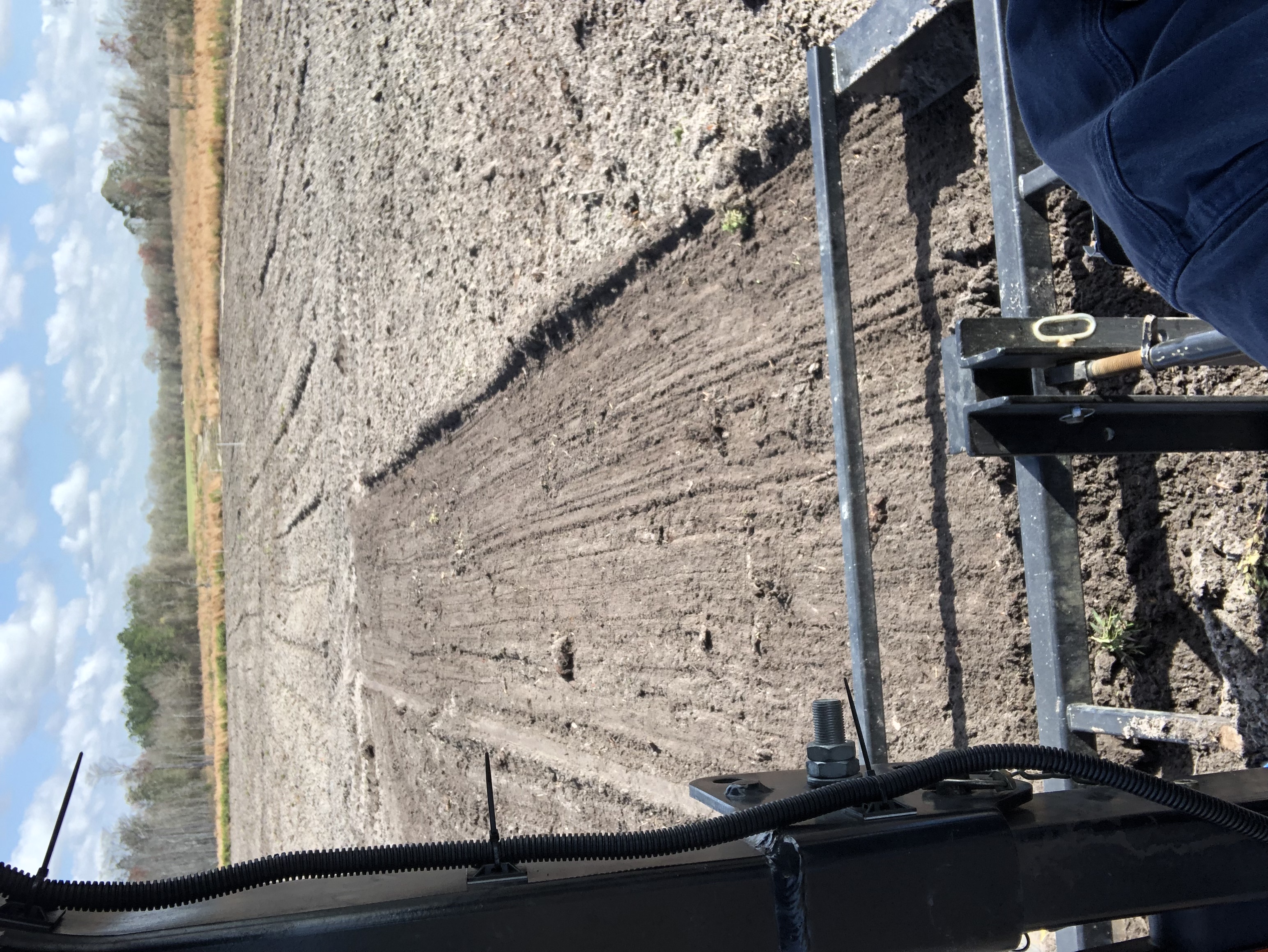

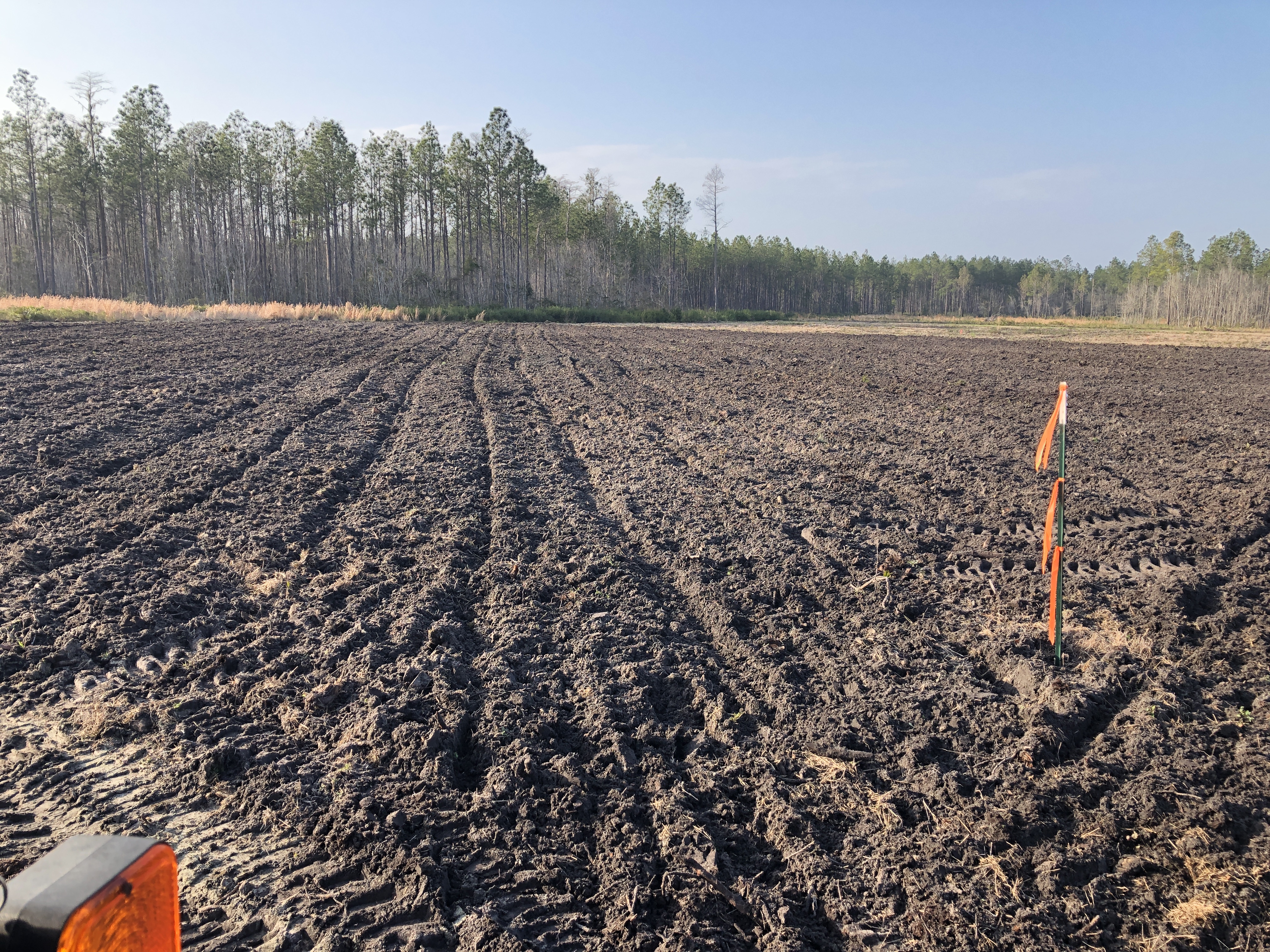

Just an update. Tractor is up to 231 hours now, included a picture while I was disking and leveling some new grounds we are putting into pasture & was at 225 hrs. Only issue is a button was glitchy on my 3rd valve function but has been fine lately. I’ll have that looked at when I carry it in for the recall flashes I still haven’t got. Lol
