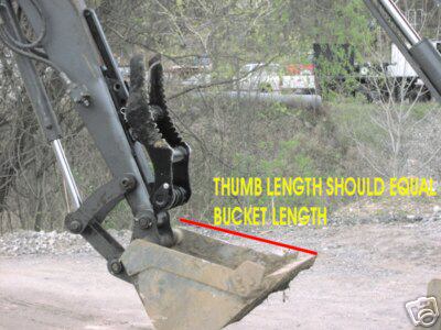

Sky,
Check this static thumb out. There is a good size reference when shopping for yours.
