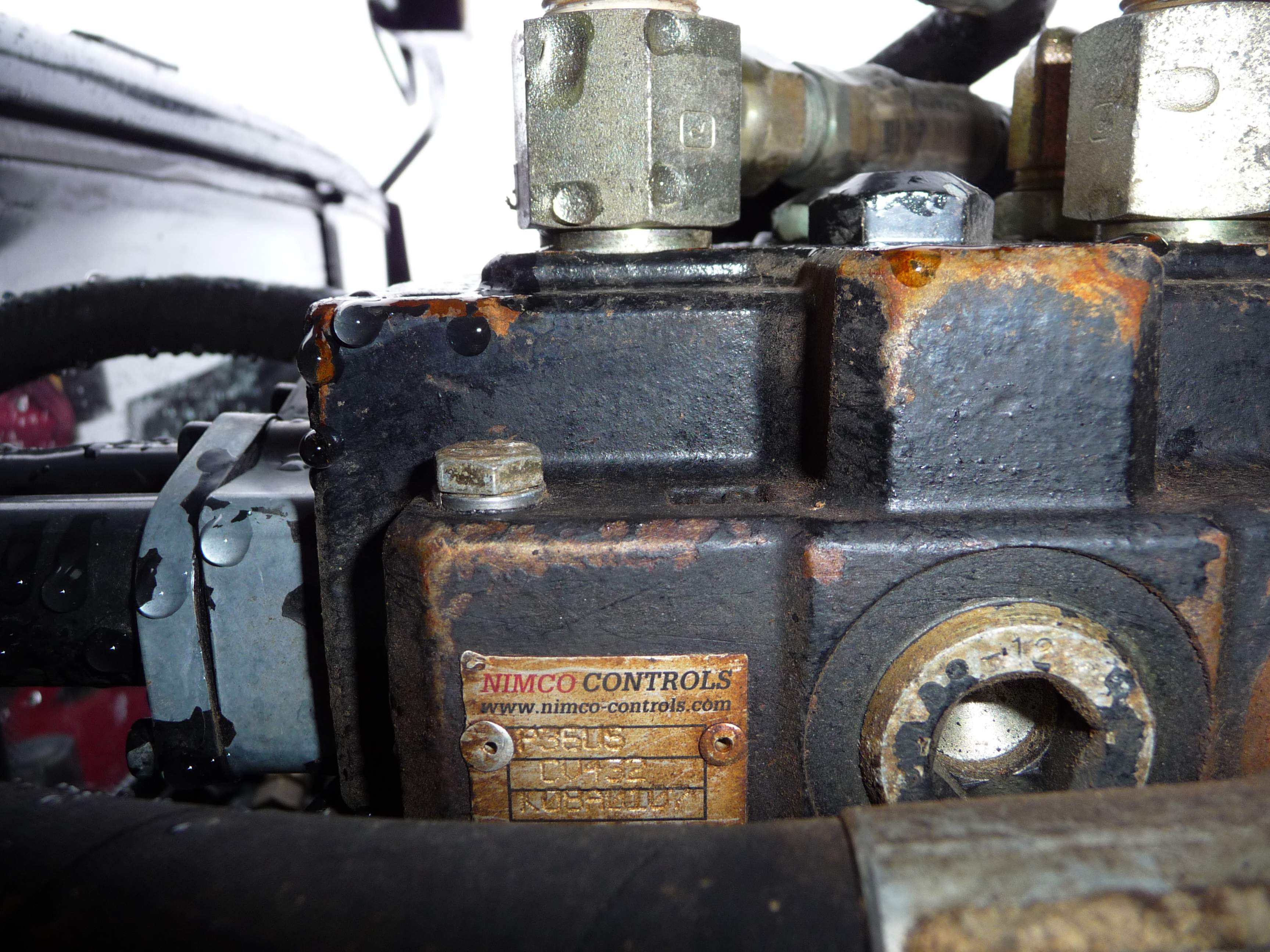

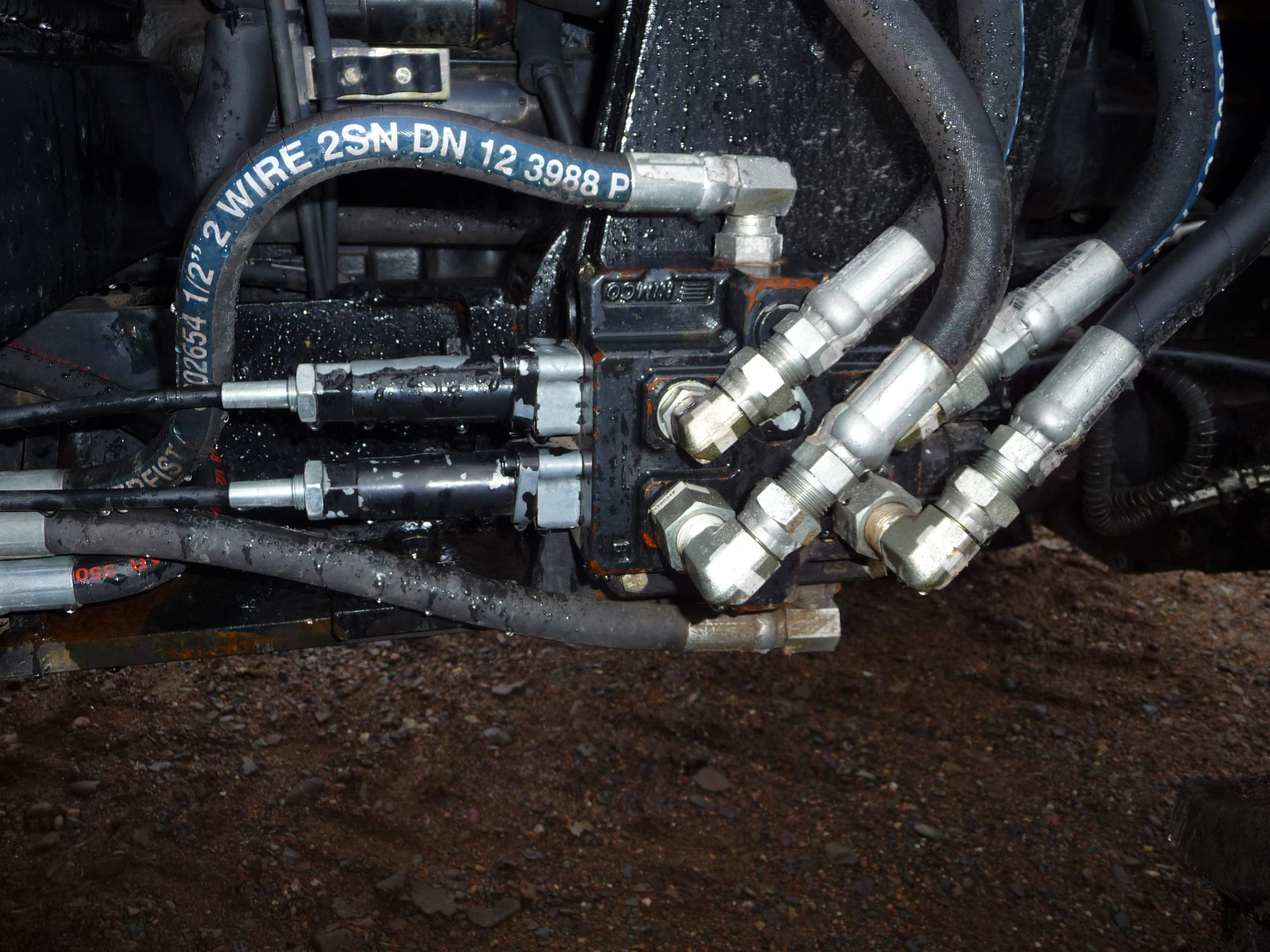

Hi Folks
Currently my loader is operating slower than it should, the CV432 control is first after the pump and before the remotes and 3pt hitch hydraulics, however there is a flow divider block in the pressure line just before the CV432 valve.
Is the Nimco CV432 an open circuit valve ?
Does it have an internal PRV, when I look at the valve on my tractor and compare to the same valve on the Nimco website the valve on the site has an external PRV showing just above the cable connection points, mine appears to be just a threaded in plug ?
I would like to remove my flow divider but I want to be sure that the CV432 control valve I have is going to bypass the pressure when my loader reaches the end of cylinder travel.
Thanks
Troy

Zoom image Request Brochure
CV432
The CV432 is designed for medium to large loaders and for open center and series flow operation with minimum spool leakage.
Flow Range 100 Lpm or 26 Gpm
Pressure 320 bar or 4600 psi
Port Size BSP ス or SAE 10
Control Manual, Hydraulic or EHP
Option HPCO, Quick Coupler Unit
The valve is open center.
I believe there is a relief valve in the bottom left of the picture by the spool control.
That is a 26 GPM valve.
What is the pump size in GPM on this machine.
If your relief on your valve is a threaded plug, then they are using the relief on the hyd block for the protection to the circuit.
Why so you want to remove the flow control from the circuit?
Can you show another picture of the whole loader valve, and all sides of the hyd block with relief valve in it?
