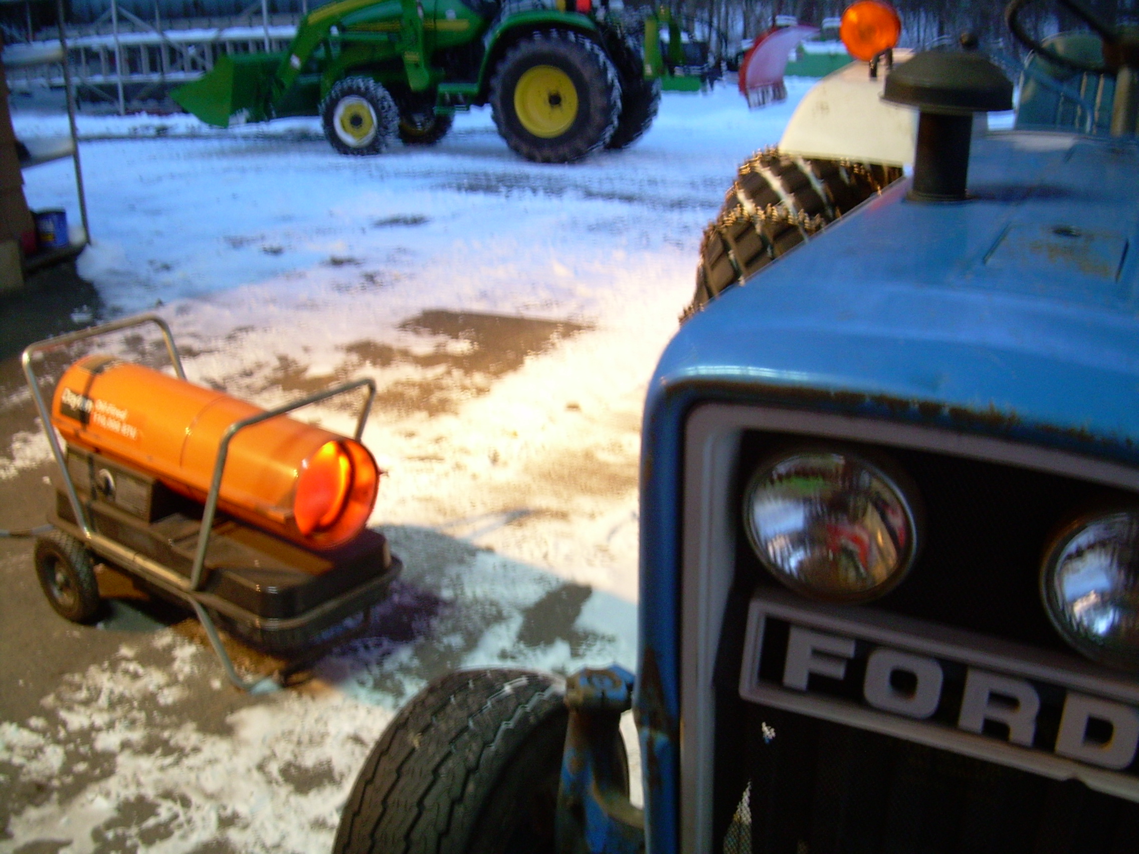

I also don't think the heater will do much for hours. If there's any place you can set it to heat the intake without melting wiring or tubing that would be a lot faster.
What caused the glow plug failure? With them all dead I think of a common failure like a relay or the ignition switch. If that's it you can jump from the battery to the wire that feeds the glow plugs.
For only a time or two it doesn't have to be any fancier than a heavy enough piece of jumper wire. Hold one against the starter cable terminal and stick the other into the connector of the relay socket going to the glow plugs or a glow plug contact if they're exposed.

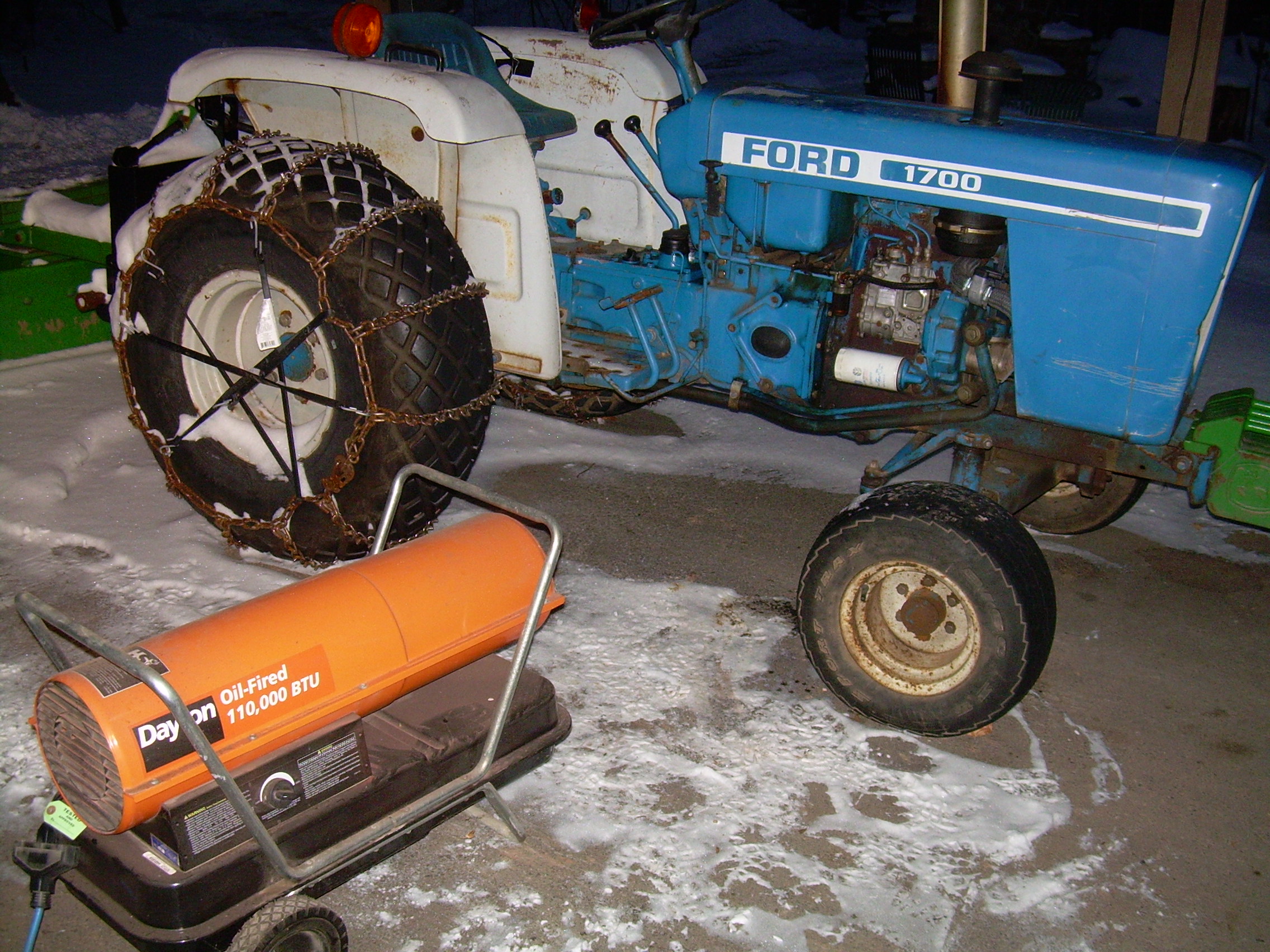

This works in 10 minutes!

No doubt - it might just be a loose connection - I did remove/reconnect them to access my brake adjustment bar a few months ago. If it is a relay failure, I'll likely replace it with a solid-state device. If it is a controller failure, I'll either build a new one or just put in a push-button bypass.
The problem is that they are nestled under the dash, and dash removal is a PITA, especially when it's in the single digits. I'm just looking for a stop-gap measure to use in the meantime until I have time to attack it. I've started my tractor down to ~20F, and it starts OK w/o the glow plugs (maybe 10 seconds of cranking), but I think I might have some trouble if it is closer to zero.

I did not have a block heater on my BX 2200, and I did the same thing as JB 4310-I pointed the kerosene space heater at the tractor in an unheated garage, and the tractor spun over and started up like it was summer after 15-20 minutes.

I use a 1500 watt heater to fire up a older tractor no cover.just put on a cinder block for 30-40min fired right up.saved my starter and batt.need longer than 15

I have a one lung diesel on a piece of equipment. No glow plug. If I have to leave it in the cold, I take a 1500 watt heat gun and point it into the air box. I have to crank it for a while but it has always started that way. A jumper cable to the battery helps spin it better and that helps even more.

Warm intake air makes a huge difference for starting a cold diesel, don't know all the science behind it but...
On the Cummins truck engines there is a heater grid in the intake that preheats air for starting and warming up, you will see the lights dim as it cycles on and off, there's also a fuel heater as well.
Idealy you would have a block heater for the engine mass and some type way to heat both air and fuel.
On a tractor you get by with a 110 volt AC block heater and glow plugs. the glow plugs will warm the combustion air a little and help fire off the cold diesel.
The warm air into the intake would definetly help and could be the difference between starting or not as long as fuel system is not frozen, you could leave the dryer on after it starts for a while to help keep it going.
