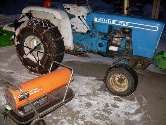

Until I fix the glow plug issue, I was planning on just draping a sheet over the front of the tractor and cranking up a 1500W ceramic heater/fan that blows heat under it. There is no fire hazard, so don't worry about that. I figure 15 minutes of that should have the motor toasty. Any comments?
This method will work well. Might take more like an hour or two though. Note that the hydraulics etc. will be warm and maybe even the tractor seat!:thumbsup::thumbsup:
   / No glow plugs - heater #25
This works in 10 minutes!
That's why I tried the sali heater, even though I have the lower rad hose heater.
I just wanted to test and see how the forced hot air would work in a pinch, if I forgot to plug in block heater or extreme cold, fuel gelling etc.
This heats the whole package in probably the shortest amount of time. Including entire fuel system.
Yes and even the seat, which on this machine is like sitting on a rock when it's cold, especialy when it absorbed some water and froze solid :(
JB.
