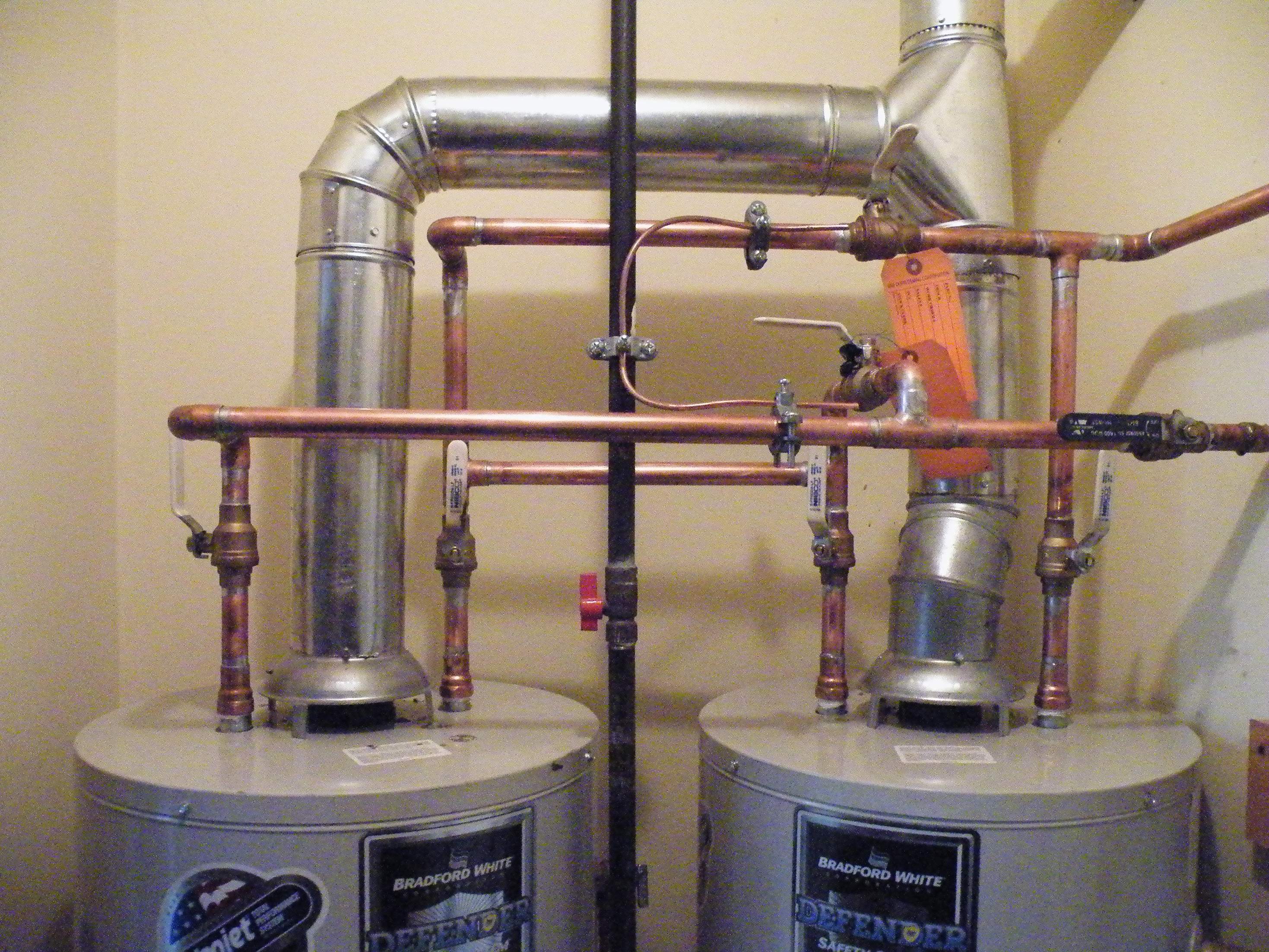

I changed out a electric 80 gallon for 2 40 gallon gas heaters.
Nice set up Murphy, please don't be offended.
As a plumber here is what I would have done different.
Used Dielectric unions in place of the 3/4" female adapters.
Since you had room, I would have put the ball valves up higher so the next change out there is plenty of room to cut and sweat in a coupling.
Anyhow it looks great.
