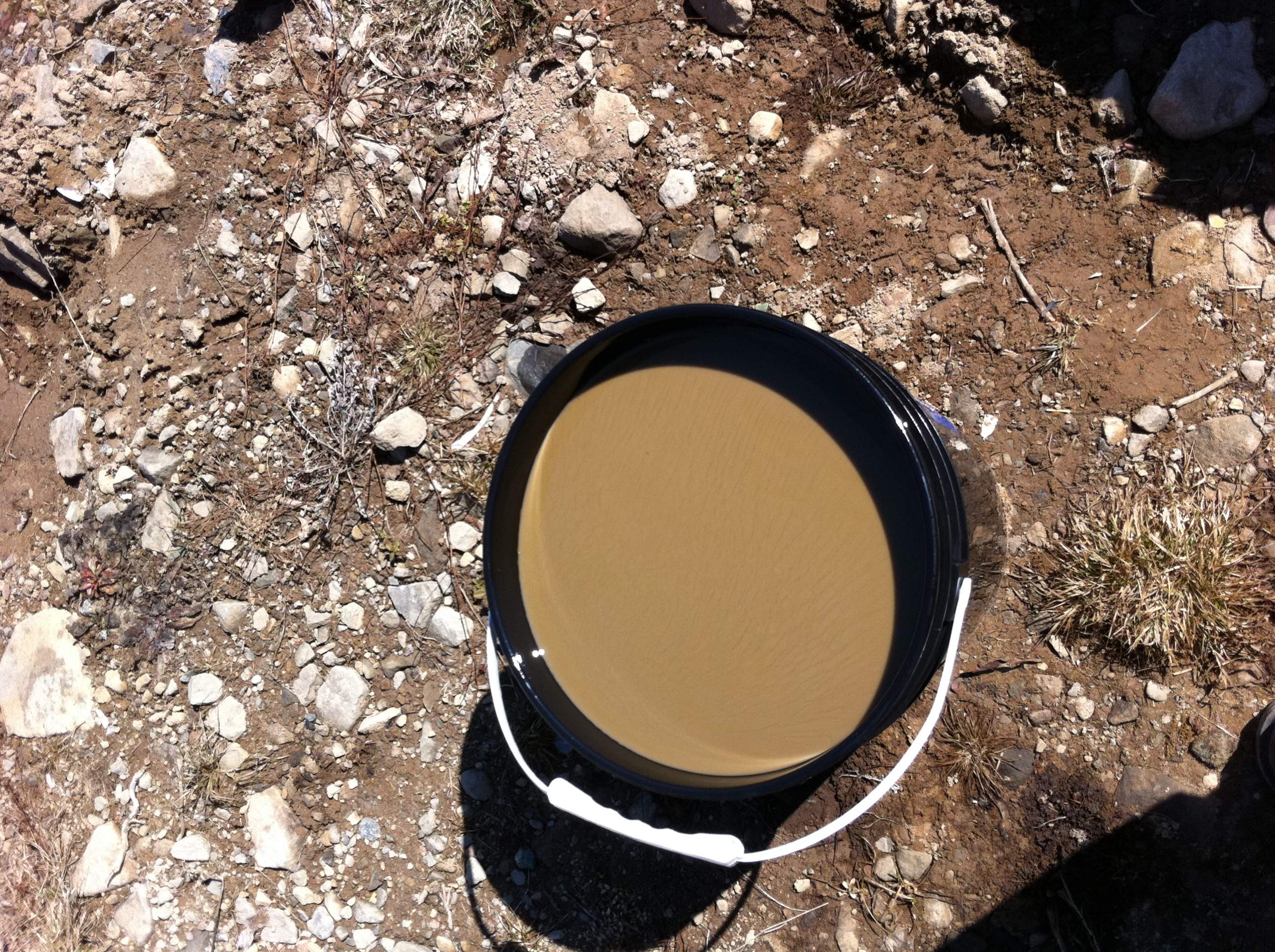

I did put some air through the test port, with no change. I'm in the process of changing the fluid in the tranny, trying to get has much of the contaminated fluid out. I think I had too much in it, It calls for 18L I had about 20L+, doesn't help. anyone guess why the tranny lost it's pressure completely. Did anyone ever take the 2 lower pressure regulating valve bolt and bypass valve bolt off without removing the tranny?
