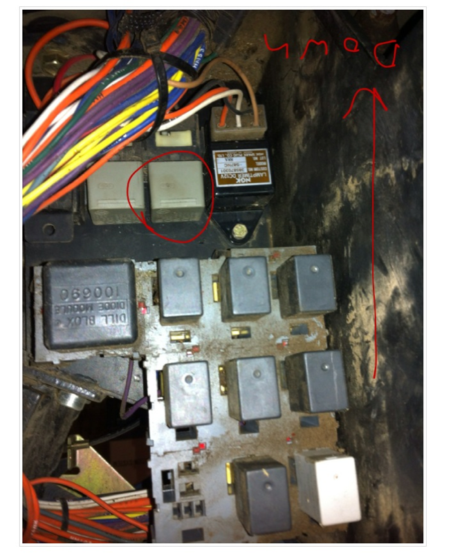

Fishpick, the next time you are out in the barn in the freezing weather, is it possible to take a cell phone photo or regular photo of your relays and post it? A photo would help us be sure we are on the same page and talking about the same relays. Your headlight relay is a heavy duty relay. It's likely different from the hazard lights, blinkers, or rear worklight relays.

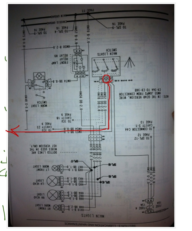

Jinman - Ok, here's the schematic from the manual AND the photo I just snapped. On the schematic I circled the most simple test case on the switch - setting 1 - light the dash and the rear lights... Follow the red line and you will see it never it's the relay... But still want light the rears. Now, actually if you follow ANY of the lines from the rotary switch - NONE pass anywhere near the relay. The relay appears to be reserved for the use of the work lights only. And the work lights work.
Now, for the photo of the relay panel... When I pull the circled one, the work lights die... So that's the light relay... But see above and the schematic pic.

After that last post I thought I'd make crystal clear what's what...
The red circles are parts of the circuit that have voltage as expected... So all 3 positions on the rotary and the front work lamps at the lamp and at the 4prong plus under the hood.
Now, the blow circles are where the test for low/high beam fail on the front lights at the 4prong plug... But according to the schematic that wiring harness between the switch and the plug has nothing in it and although I haven't cut it open its in great shape and the wires should be fine.
The red circles with the blue lines, well, that's the wires from the switch to the dash panel... They test out with 12v at the plug into the panel... But the dash never illuminates at setting one and the high beam indicator light never comes on on setting 3...
There's about 50 other marks I cold put on here when I have tested... The point is there's 12v at the switch, not 12v on the other end of the wire that comes from the switch and the massive wrapped harness is all that between those two points. The relay has nothing to do with things...

Bob, you are right. Your tractor is a different "beast" from mine. The key to this problem is the area of the connector where you have the blue circle. I'm gonna talk about the normal beam here because we need to work on a single circuit at a time.
As you said, the relay on your tractor controls only the work lamps that are controlled by the work lights switch and the relay. Your headlights show to be powered directly off the switch. The switch connector pin #3 is headlight power and is a dark blue wire (I'm not sure of pin #3 because it is blurry). That exits the light switch and goes to pin#1 of the connector you circled in blue. From there, it goes to splice #15 (SPL-15).
Now, the wacky part of this is that all the wires leaving the switch are dark blue. You want to follow the line marked "HH-52". I would normally say to check your ground circuit, but the work lights use the same ground path through splice #17. If they are working, ground must be good. Pin A of the light connector should be ground and pin B should be the +12 vdc. If I had power coming out of the switch, I would be tempted to run a jumper up to see if the lights work by bypassing the harness completely. I can't tell for sure what pin on the switch HH-52 is attached to because the diagram is blurry when I zoom in to read the number, but I think it is pin #3.
