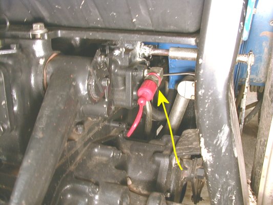

<font color="blue"> One thing that's got me is that the grapple is on the first remote, but so is the backhoe, so I have to change a quick connect from the backhoe line to the grapple line to switch which one I use. </font>
This is the same way my BH is plumbed on my TC 29 D. Generally this is not an issue as this 1st remote is for your 3-point hitch. Once you have the BH attached, you don't want to inadvertantly raise the 3PH as it would run into some resistance real quickly. However, in your case, the grapple is plumbed into this (which raises a question for me - can you not use the grapple and the 3PH at the same time when the BH is not attached? Hmmm...) Now, with your additional remotes you should be in good shape, except that the hydraulic line for the grapple is not long enough to reach the quick disconnects for the 2nd and 3rd remotes, assumming they are located behind the seat like mine are. So, other than this little bump in the road, you are ready for some fine tractoring.

On my TC-40D my backhoe is actually connected to a power beyond port. Which looks to me like nothing more than a plate with a tapped port where the remotes would normally be mounted. When this connection is made it overrides the 3-point lift mechanism.

<font color="blue"> On my TC-40D my backhoe is actually connected to a power beyond port. Which looks to me like nothing more than a plate with a tapped port where the remotes would normally be mounted. When this connection is made it overrides the 3-point lift mechanism. </font>
We may be talking about the same thing. As a tractor neophyte, I don't always use the right terminology. The quick attach I use for the back hoe (that disables my 3PH) is located on the undercarriage close to the vertical support of the FEL, a place I find somewhat difficult to access.
We may be talking about the same thing. As a tractor neophyte, I don't always use the right terminology. The quick attach I use for the back hoe (that disables my 3PH) is located on the undercarriage close to the vertical support of the FEL, a place I find somewhat difficult to access. </font>
That is one of the 2 connections required. The second connection point is a quick coupler in the rear of the tractor (see attachment) where your remotes would normally be mounted.
