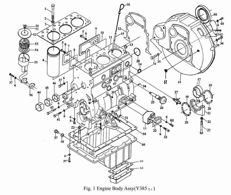

Sorry it has been so long since I posted this question and I know everyone wants to know the outcome. Last night was the first chance I had to work on the tractor. I pulled the oil sump cover off and there was a washer lodged in the pump impeller that stopped the pump from turning.
After removing the filter screen and the bottom filter housing I counted all the hardware and none had falled off, so this washer was a freebe from the factory thrown in for good luck, but not for me.
The single bolt that holds the pump shaft assembly to the block is very ugly to get at. I needed to do some custom grinding on my 13mm box end to get in there. After about 2 hours of fumbling at this bolt it was backed out.
Now here is the problem- Does anyone know how to easily remove the pump assembly. The tab on the pump that the retaining bolt fits through is located in an indent of the block and it cant be lowered as it contacts the sides and bottom of the indent. I am not sure if my engine is of a different configuration (380YDS) but the block is in 2 parts, the lower area (oil sump) is attached to the engine block. This oil sump mating surface(joint) is where the oil pump retaining bolt is attached. The only way I can see to get it out is if the block bottom is separated. This would mean the complete dissasembly of the front end of the tractor since the front frame is attached to this area of the engine block.
Please Please Please tell me I am wrong and there is something I am missing as this would be a 20 hour job to replace an oil pump.
I still dont know the condition of the gear on the cam shaft until the pump is removed.
All help is appreciated

From your description, I am assuming you are talking about the notch in the side of the oil sump(#60) located just below part #37(oil pump retaining bolt?) in the attached picture. I am assuming you removed part #64(cover plate) to gain access to the pump? You may have to remove part #60(oil sump). I will look at my tractor when I get home so I can see what you are talking about IRT removing the sump.
Just to confirm, the pump assembly does not have enough play in it with the bolt removed to either slide or twist away from the sump sidewall to allow the tab to clear the notch?

I have not been able to find a parts breakdown of my engine. My engine parts book has the picture you attached but is differnet than the supplied engine configuration. My oil pump retaining bolt is internal and does not also provide suport for the sump(#60). On my engine the oil sump is the same shape as the block and is used as the integral part of the front frame extenders. Therefore I cannot remove it like a typical oil pan, I would need to remove the entire front end of the tractor and possibly split it to do so. Also my oil sump cover is only a cover and when removed exposes the entire engine from below.
Maybe they put a different engine configuration in this tractor
The pump will drop only about 1/2" before it contacts the notch and will only twist slightly from side to side before coming in contact with the block wall.
I will try to take a couple of pictures to make this easier to see.
I have attached a link to a 30hp engine that is more like the way my engine block is constructed.
http://www.farmprotractors.com/FarmPro/parts_engine/30CylinderBlock.pdf

I crawled under my tractor this afternoon and mine is just as you described yours(sump cover covers the whole bottom of the sump). I also see your dilema. I didn't realize the forward frame rails attached to the sump when I was under there checking bolt tightness a few months ago. I thought they were bolted to the side of the engine block.
Unless there is some way to slide/twist the oil pump assembly inward to get the tab to clear the notch in the side of the sump, I don't see any other alternative to separating the sump from the engine block. This operation appears to me to be a pretty tricky one, perhaps more so than splitting the transmission to get to the clutch.
How much more clearance do you need(how much is the tab protruding into the notch in the sump wall) to get the thing out?

It is a hard spot to see the tab, but it looks appox 3/4 inch would get it out. This is only a guess as it is hiden by the pump.
