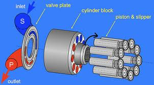

Hydraulic shop thought something significant must have gone through that pump to tear it up so badly. My job would become to make sure there is nothing still in the system to hose me again.
When the significant stuff went through the pump did it go through the barrel and get caught between the face of the barrel and the valve plate?
Did it look like it went where the red and blue oil goes in the pix?.....or did it look like the piston slipper/shoes were torn up instead?
