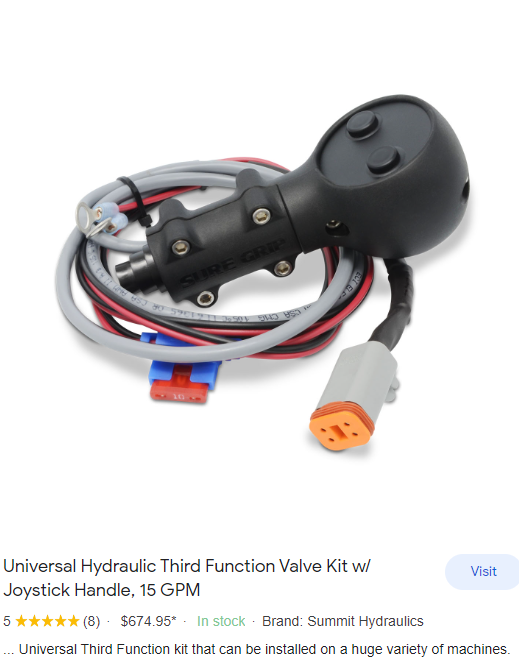

Are you saying you weren't trying that????
What were you trying?
Did your "mechanical neighbor" test anything out after he was done? Or explain to you that you need to hold the button and move the joystick?
Did your neighbor mechanic tell you whether he set it up to divert the lift/lower or the curl/dump circuit??
A diverter NEVER needs a two button joystick. Because a diverter has only ONE solenoid. SO at this point I have lost all confidence in "your neighbor mechanic"
OH, and also.....it looks like its plumbed wrong......but hard to tell from the pics because I cannot see what the ports are labeled. A closeup would be nice. But guessing about 75% sure this is the issue....incorrect plumbing
Like he said, only had seen two button type. So, if he'd only ever seen two button, one button may throw him.

some do have two button ... Not sure why or what it dose... maybe a activated and disactivated ??
''Kit includes joystick handle that replaces your existing handle and has 2 integrated momentary push button switches so you can open and close your cylinder with a push of a button
  • Ergonomic design with 2 momentary push button switches''
Yes, like on a skid steer. Open, close for boom circuits.

I haven't had a chance yet to try it but I think that the moving of the joystick will work. Last night after seeing the replies I recall the RK person telling me that you have to use the curl/dump function when I bought the kit months and months ago but I forgot about it. I guess they don't expect anyone to buy the kit and install it themselves because it comes with no instructions other than a photo of the plumbing of the new hoses. Nothing about the operation of the valve.

Thanks to those that responded about using the button and the curl/dump function in conjunction. This afternoon I walked over to my neighbors and we gave it a shot. Perfect......... He said yestertday that it has to be something very simply. The third function joystick was added as standard equipment on later models of the RK tractors so there's no mention in the manual as to how the button functions. Even the new online manuals haven't been updated to mention the button. As I mentioned in my second reply, I remembered during the night that the RK guy told me you have to use the curl/dump function but that was close to a year ago and I had forgotten.

Since the lines feeding the valve have to originate from either the curl/dump OR the lift and lower hoses....and NOT from a main pressure line.....that is the reason it's called a diverter. And the reason the joystick still needs actuated WHILE pushing button.
Since you mentioned it as a diverter.....and since it ties into one of the joystick functions.....I assumed either you or the neighbor understood how it was supposed to work.
When I asked the question "weren't you trying that".....was because I was kinda surprised you weren't. And initial look at the pics.....my thought was wrong plumbing. Because MOST diverters have the top ports as the ones going to the grapple. And the side ports are supply....and normal function out. But I say "most" because not all are that way.
In any case.....I'm glad you got it working and it's water over/under the bridge now.
But I gotta ask.... which functions of the joystick are diverted that now operate the grapple?
Also.....if open/close are backwards from what you prefer for operation.....just swap the two hoses going to the grapple

LD1, the dump/curl function is what's diverted to the grapple. I had no idea this was a diverter valve until after I purchased it and saw the valve labeled as a diverter. The TYM label on the box definitely says third function kit. Even knowing it wasn't a true third function I most likely would have bought it anyway since it contained all the fitting and hoses cut to correct lengths.
   / No pressure to grapple #19
Myself I would prefer a diverter over a third function. The diverter is controllable, the third function is just on or off no modulation possible.
   / No pressure to grapple #20
And don't feel bad about misconception. There are a lot of TBN members that don't know the difference.
I'm used to the quickness of my 3rd function. But Lou is right, control is much better with a diverter. What you lose is the ability to do all three functions at once.
