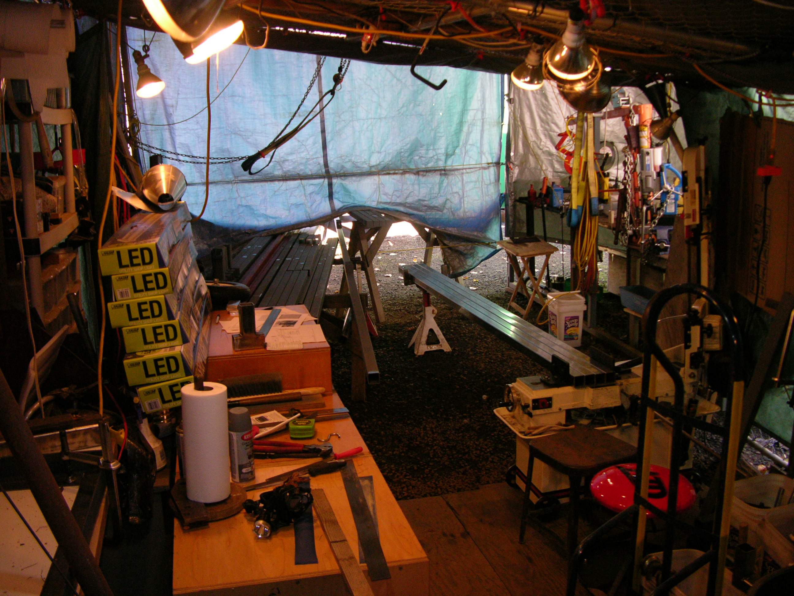

Yup, don't remember WHERE I "xerox-enjuneared" the idea but finally got around to drawing it up - and when you add the mod Bruce posted (post#4) it's even cooler -
When I get the 24'x24' roof finished (steel tube and fiberglass) over the 20 foot container (temporary mini-weld shop, see drawing) I'll likely build at least 4 of these, 2 for the inside tig/mig table and 2 for the outside one.
The Tig/Mig table will get a small dedicated bench grinder for tungstens and a vise, the outside table will get the bigger vise and bench grinder, which will ONLY be attached to the outside bench when it's being used.
This setup will (hopefully) get me thru the winter with at least PART of the teensy bit of sanity I can still lay claim to til I get the new (second) 40x60 shop in and powered, then the container will probably become a compressor/storage area behind the new shop... Steve

That's a great idea how to tighten up a receiver. I'd thought of using a bolt like TxDoc but I like your idea soooo much better. As soon as I read it, I thought "cool, just have to make 2 cuts, one in each plane"....then Bruce suggested the compound angle cut.
I'm thinking particularly with a vice, your want the bottom piece closer to the vice and the top one to be the inside end as that would give the best support for beating on it.
   / No-Slop Vise Mount for Steel Bench #18
Geez, Steve you're just WAY too organized. We can only assume you have plans drawn up for your PRE temporary weld shop for use while building your temporary weld shop.......
The 160 sq ft layout looks good though! When you're all done with the BIG shop I'll fly you up for a well deserved 'vacation' helping me reorganize mine. :)
Terry

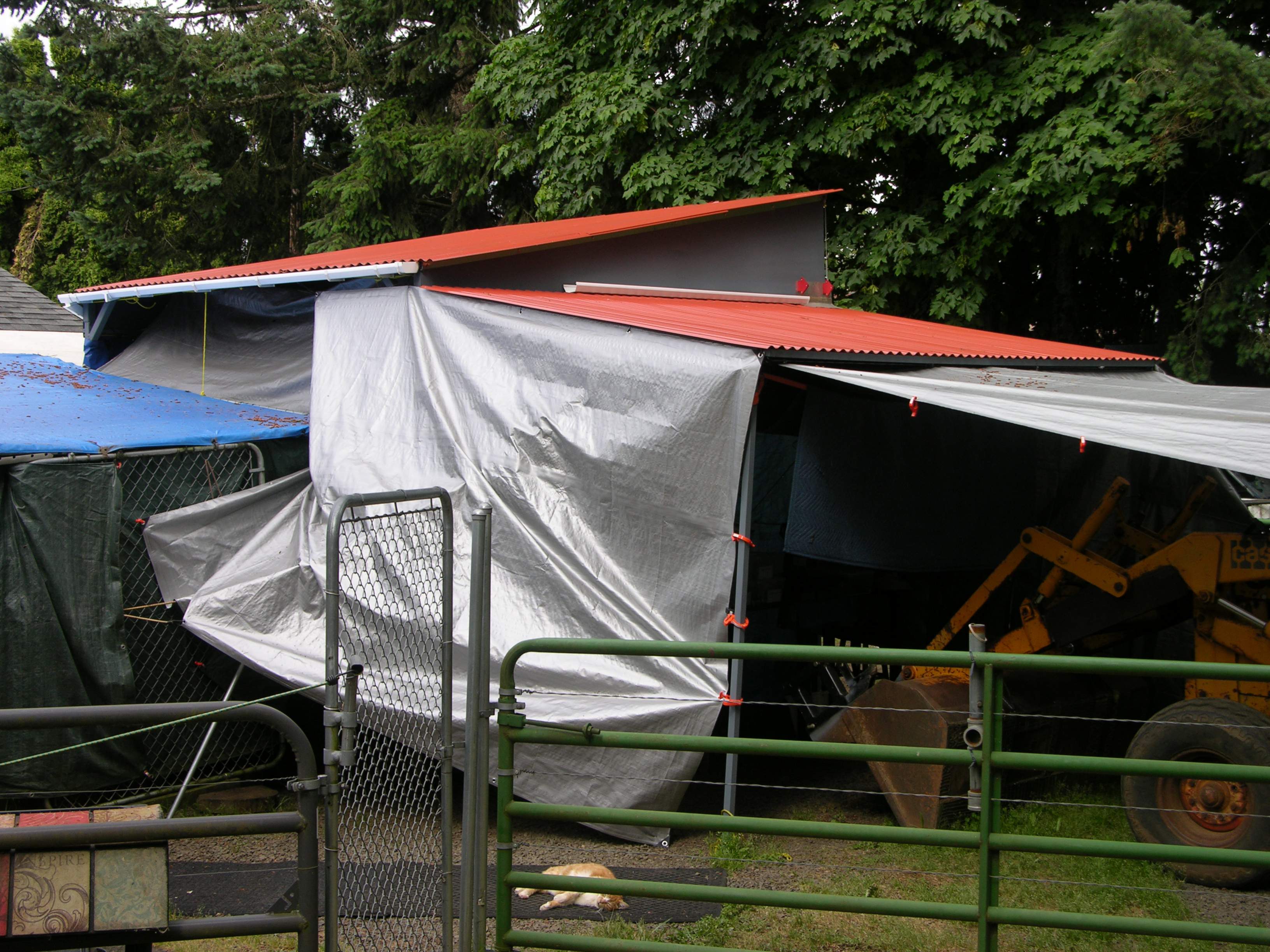

"We can only assume you have plans drawn up for your PRE temporary weld shop for use while building your temporary weld shop......."
Terry, this is my pre-pre temp weld shop "annex", all that 2" square tube is just PART of the components for the container's roof frame - the half that'll be over the container will attach to the corner sockets and be bolted/welded in place and will lift off (loader) by removing 4 5/8 bolts - the outer half will be in 3 8'x12' modular sections bolted together while hanging down from the brackets on the container half, then raised into place with the loader and the outer posts bolted in place.
When the whole shebang is no longer needed there, the container AND its half of the roof will become a wind break for one of the main entrances to the new shop as well as a compressor/storage room - the 3 modules of the outer roof will get re-connected end to end (instead of side to side) and become a "mini-machine shed" for the 50' boom manlift.
The other pic is the OUTSIDE of the pre-pre temp weld shop "annex" - the smaller roof folds down against the side of the 12x12 section, then you drive the backhoe into the 12x12, pick it up and drive to where you wanna move it (assuming you have at least a 14' wide path to get there :rolleyes:)
I'm thinkin' that, by the time my new shop's ready for biznez you'll prob'ly get off pretty cheap for air fare - how much can it cost to send a 5 pound URN??!? :laughing: 'Course, the DOWNside of that is the amount of actual HELP you get may be minimal :D...Steve
