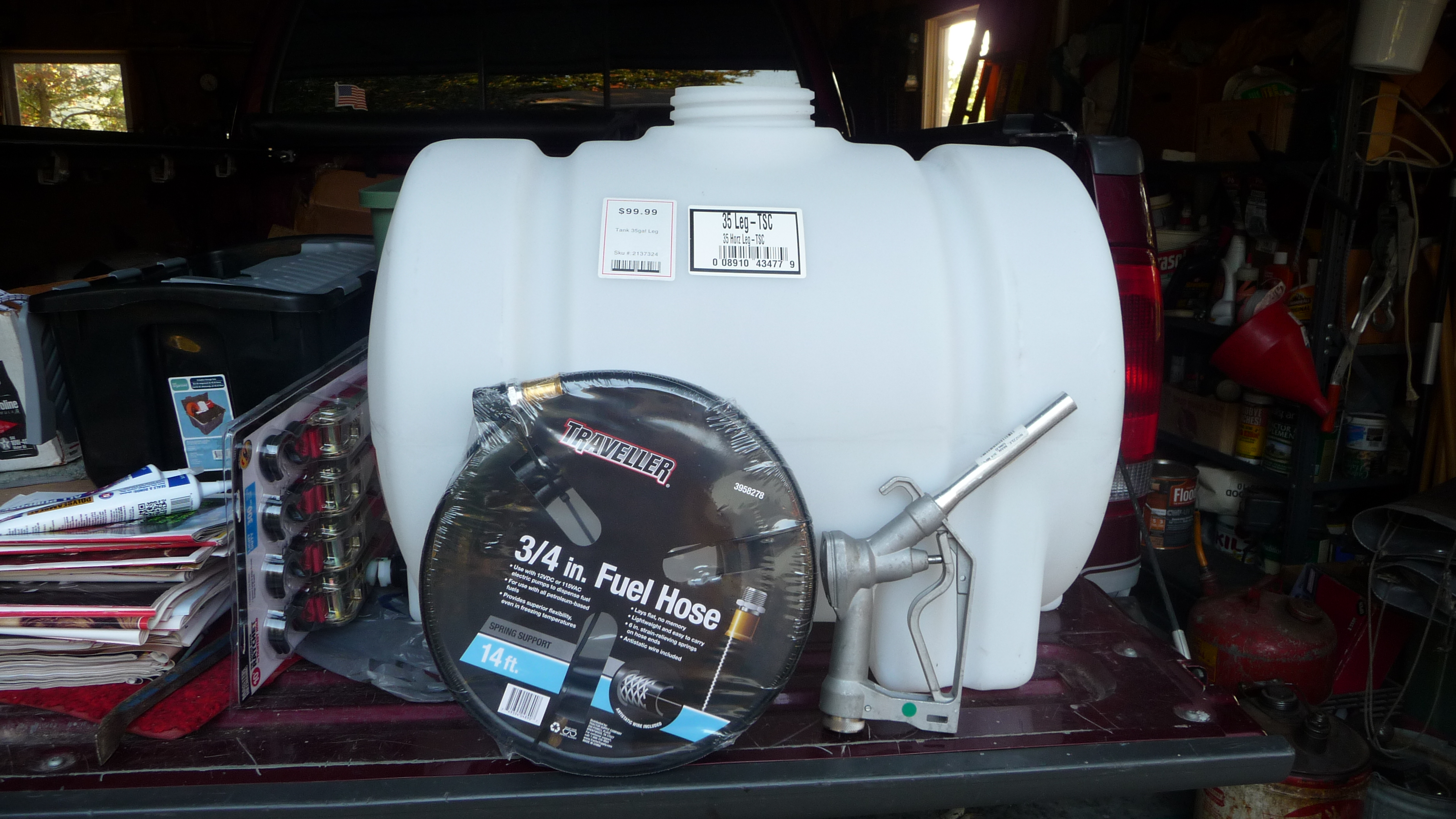

Those vents are a great find. I instead drilled a hole and threaded the first drywall screw I found into it. It really takes a rather small hole to serve as a good vent. By the way, the autoparts stores and Tractor Supply offer very plain flexible spouts to fit the stupid ventless jugs sold these days. Replaces all that garbage & complexity with a simple flexible spout but you still need to drill for a vent that the Feds have decided to protect us from. For relatively small operation diesel I also came up with a 35 gallon pesticide tank ($99 at TSC) and attached a 3/4" gas hose and nozzle. Ended up with around $150 in the whole rig but it has been very useful. Requires gravity OR a small pump. Photo attached. P1200661.JPGBecause it was not intended for fuel, you have to find fuel resistant gaskets for the outlet or it will leak on you.
