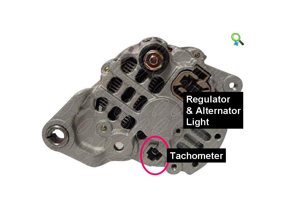

Does your alternator look like the one in the attachment? Are you saying that there is not a connector attached to the back of the alternator where I labeled it "tach" and having two wires going up to the instrument panel. The only thing I can imagine that might be around those wires is a filter coil to remove static interference, but your description seems to be something very different.
BTW: According to the info I have found, your LX665 uses the same alternator as my NH TC45D and many other compact tractors. However, the mechanization of your tachometer might be from some other source. I'm doing a bit of assumption because my tach is driven directly off the connector shown below on the back of the alternator.
BOGUS INFO ALERT!
Dang it! I looked at the wrong connector. The tach connector is a single wire directly below and sligtly to the left of the labelled connector. On my tractor it has a pink wire going to it. The incorrectly labelled connector is for your alternator charge light on the dash and the voltage regulator sensing lead. Sorry about the misinformation.

I was going to pull my tach wire out of my alternator and look at it, but it is buried behind the exhaust shield and I couldn't get to it without completely removing the alternator. I'm not sure what the connector looks like, but my schematic shows it is attached to the P terminal (the single terminal in the last photo) and the Repair Manual says that this terminal has a pulse output that is 1/10 of the alternator's rpm and is used for speed detection and the tachometer.

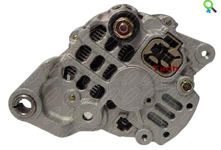

I viewed a picture of your alternator (or was it a stock image?) and have included 2 photos of the back of mine. While similar, it appears as though the terminals are mirror images of one another, or pretty close to it. The YELLOW/GREEN wire combo on mine is what you labeled as TACH and the PURPLE wire on mine plugs into hole adjacent to the YEL/GRN plug. It does not have a spade connector, but rather just a snug fit into a rectangular 3-dimensional hole. the PURPLE wire seats but it is rather taut (perhaps too taut) and maybe broken or similar. Hope this helps you because you're definitely helping me. Thank you!

William, thanks for the photo. I looked up the part number for your LX665 on the internet (messicks.com) and they showed the same alternator configuration and part number as mine. That alternator you are showing is similar, but definitely different. The illustrated parts breakdown online also is exactly the same as mine.:confused:
I do suspect the purple wire is the tach output and maybe it just picks up the rpm by induction as you said. I think you are on the right track. If it's tight, the additional stress from a vibrating engine would only make it worse.

Here is a photo of the alternator labelled correctly. This photo is from a vendor's site and is not mine. I just copied it here, but my alternator looks like this one.
EDIT: It might be a mirror image of the real alternator. They easily could have this image reversed, but there is a lot of separation between the two connectors on my alternator and not close like yours.

Well, here's the problem: I don't have a wire going to that post and I was wondering why it was empty! Now, all I need to do is crawl around looking for the wire and when (I hope) locate the thing, just attach it. Sounds easy enough. Your last picture cleared things up for me. Will report back when it is located (could be tomorrow).

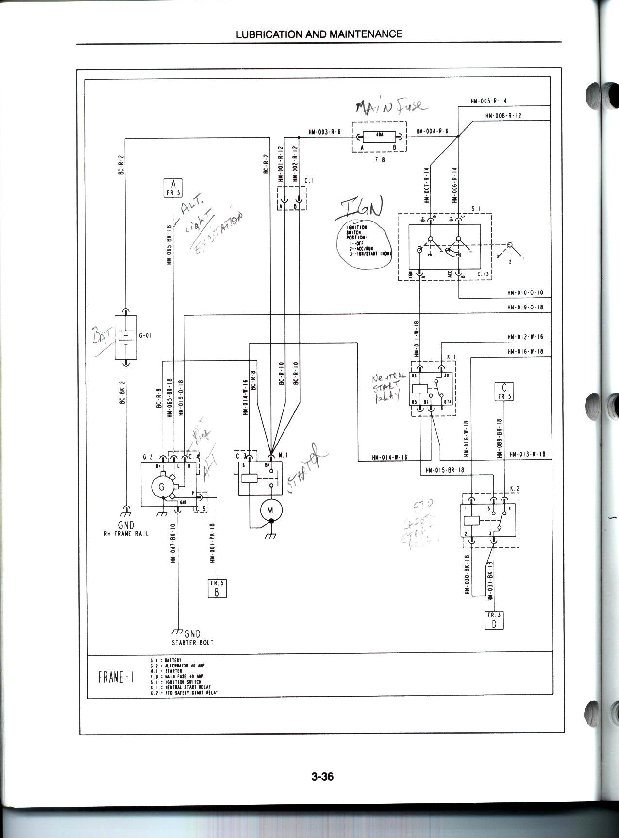

William, I just read that you said your alternator has nothing connected to the tach output. There's a chance that the digital gage is mechanized differently. They could have a pickup/transducer installed directly on the flywheel somewhere. That's why it's so important to find your manual and look at the schematic. I could be totally taking you on a wild goose chase because your machine could be different.
The schematic would clear that up right away. I've attached an illustration of my schematic (one page only) that shows my alternator. The wire going from the P terminal to the box labelled "FR 5, B" is the tachometer wire and it goes into the instrument panel on Frame 5 and to the tach circuit. If you had something similar it would ensure that your search for the missing wire would not be a wild goose chase.

I feel obligated to come down to Texas and help you with that project after all the help you have given me! I hear what you're saying - maybe that's why there is no wire on the spade plug. I will look for my manual and hopefully together with all of your info be able to get it working. Not before Sunday, however. I'll report whatever I find, and if you need some help, just ask. Thank you so very much for all your help and assistance. It is indeed greatly appreciated.
