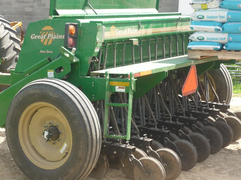

   / No-till drill opinions......... #3
Here is my vote.:cool:

   / No-till drill opinions......... #4
Great Plains is a great drill. The advantage the Haybuster has is their 107 10' drill has the tires on the inside and you can legally pull it down the road. A 1006NT Great Plains Drill is 12'7" wide and is a bit wide for the roads here in the east.

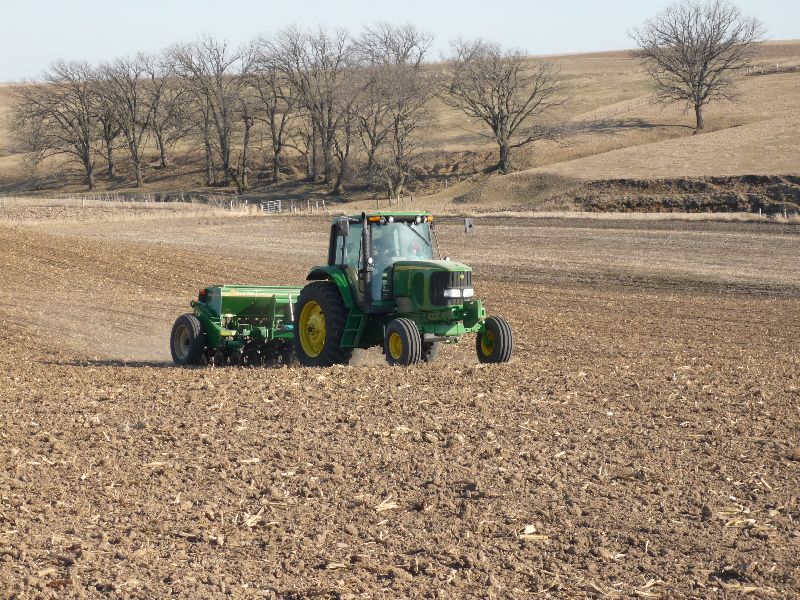

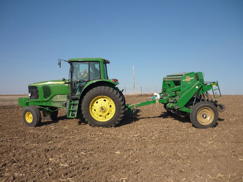

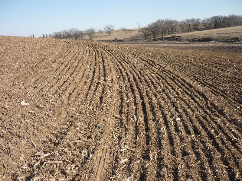

   / No-till drill opinions......... #9
Yes
What are your soil types and primary crops planted with the drill? Any issues? How heavy does the drill pull? How is your drill configured - fertilizer, native grass options, etc. (I wasn't paying that close of attention when the salesman was talking about the native grass box, I'll admit I was already mentally figuring depreciation and returns)?
We have a clay soil but probably not as heavy as yours.
The drill has worked perfectly. It has grass boxes.
We plant alfalfa/grass and oats, soybeans and winter rye or tritical.
The oats and beans are typically planted in tilled ground and the winter rye is no tilled into existing hay stands or into ground that has been V ripped after taking corn silage.
We pull it with a JD 7210 or 7220 and they just play with this drill.
The drill really couldn't work any better as far as I am concerned.
Here is few action shots from April.
