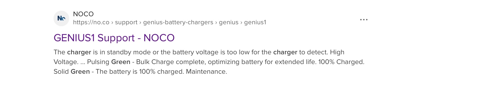

I had a 1 amp NOCO connected for a week without checking on it and it was green pulsing today so I don't know if it would ever go solid but I'll check that someday.
It's the factory size for the F-150 2010 and the battery is actually a AGM from O'Reilly's.
   / NOCO Genius question #45
pulsing green means its done, it does not go solid.

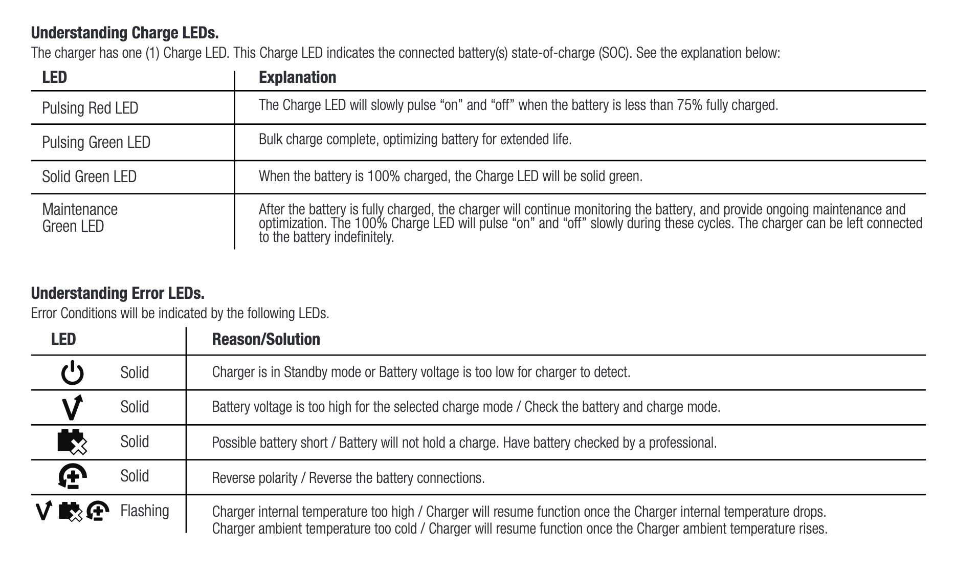

From the NOCO Genius1 user manual:
Apparently it is otherwise, it is red till it is fully charged, then pulsing while de-sulfating and how they say "optimizing", and then solid green for just monitoring to replenish if the voltage drops
