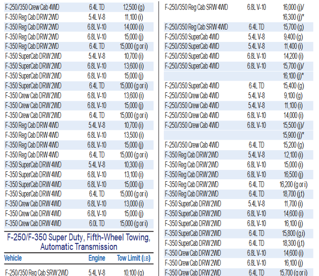

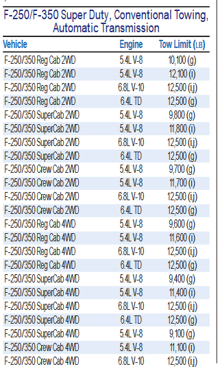

My truck is rated to tow up to 12.5k and trailer is 12k. (6.4 diesel 4wd supercab)
Looks like Gooseneck/5thwheel is up to 15400lb (single rear wheel, 6.4 super cab 4wd)

So that chart says “conventional” towing.
Is there another chart called “5th wheel” towing?
Yes.
My truck is a 2022 f350, conventional towing is 20k, 5th wheel is 21700. Basically a wash cause goosenecks are usually 1000lb heavier.
I’ve made it a hobby to skirt the cdl for the last 25 years. Fdot. Current truck is 11400 and trailer is 14k, but it’s aluminum and has a payload capacity of 12050.
https://www.ford.com/cmslibs/conten..._Ford_Super_Duty_Pickup_Towing_Info_Oct20.pdf

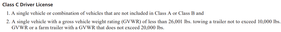

It has been a while since I was in the police academy, but I try to keep up on DL requirements to keep myself out of trouble. Each state will have its own laws, but most have adopted the federal FMSCA requirements for CDLs or they don't get federal highway dollars. CDLs come in Class A, B, or C for those drivers operating a commercial vehicle. There are also a Class A, B, and C non-CDL license. In Texas you can use a Class A or B non-CDL if you are driving certain exempt types of vehicles classified as commercial.
The FMCSA regs only cover CDLs, state law will govern non-CDL licenses. Where people get into trouble in Texas is the definition of what a Class C license allows you to operate - a single vehicle less than 26,001# GVWR pulling a trailer not to exceed 10,000# GVWR or 20,000# GVWR if it is a farm trailer. The below 26,000# GCVR does not come into play. Pull more than a 10,000# GVWR non-farm trailer in a non-commercial use with any pickup or SUV and you need a different class of license according to the statute. That seems to be a common statute in many states from the stories I have read. But where I live, you see lots of 2500 and 3500 pickups pulling dual 7,000# axle trailers and not get stopped. Most officers don't mess with it unless you are obviously loaded past the 26,000# GCWR limit - YMMV where you live.
I had a Class A non-CDL for driving fire apparatus. I let it go to a Class C after I retired but in hindsight I should have kept it for pulling my own trucks and trailers. Fortunately, Texas law allows for me to use my new GMC 3500HD at 14,000# GVWR to pull my Sundowner 15,900# GVWR horse trailer and my two Big Tex 15,900# GVWR trailers, all with farm tags, with my Class C license.
I watched the video about the guy without a CDL having to drop his trailer and get his buddy with a CDL to come get it after being stopped. He was over the 26,000# GCVR limit and the trailer was well over 10,000# GVWR. He tried to say he was not commercial. Officer didn't buy the non-commercial use story, his truck was registered to his company. Even if he had gotten by with the non-commercial excuse, he was pulling a 16,900# trailer with a Class C license. Either way he had to park the trailer and get somebody else with a proper license to come and get it.

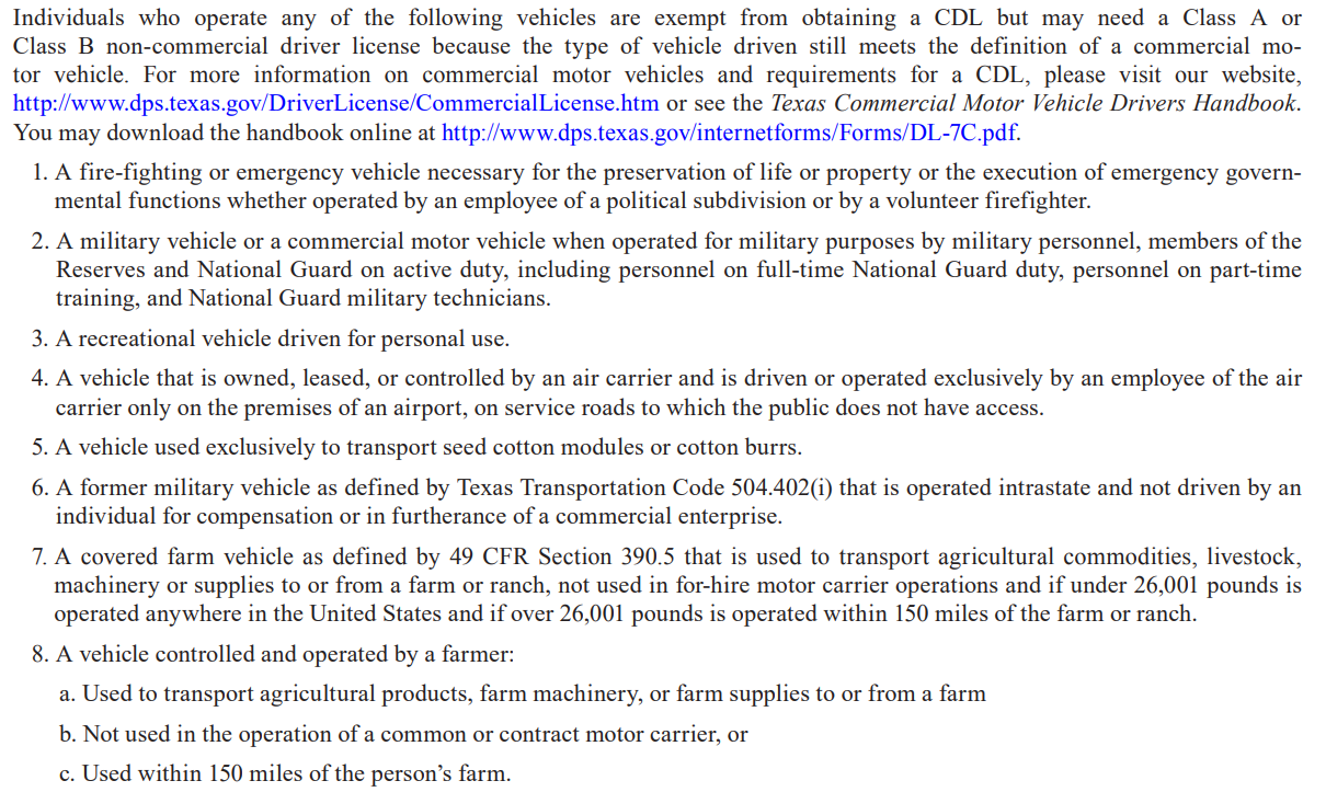

These are from the Texas Driver's Handbook.
These are the exempt vehicle types:

Illegal for commerce. And it’s 26k and 1 pound. 26k even is non cdl.
Ok fine over 26k, the number wasn’t the sticking point. The fact that there are gaps for being non-commercial and legal exist was.
   / Non CDL F250 towing 12K trailer across state lines ? #48
Correct, the problem is some states don’t have a non-CDL class. They offer a class “c” OR a commercial license. Now how do you legally tow a +10000 trailer or drive a +26000 combined?
