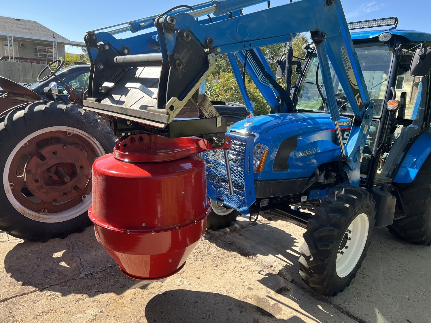

I picked up the stand mixer at a yard sale for $50. It had a bad electric motor that I replaced with a $150 hydraulic motor. I had the blank SSQA plate laying around so the whole rig cost $200.
I made a SSQA plate to mount my 3pt cement mixer in the FEL and attached a hydraulic motor.

Nice job, it looks very heavy duty.(y)
Be sure to splash a little paint on it before using it.

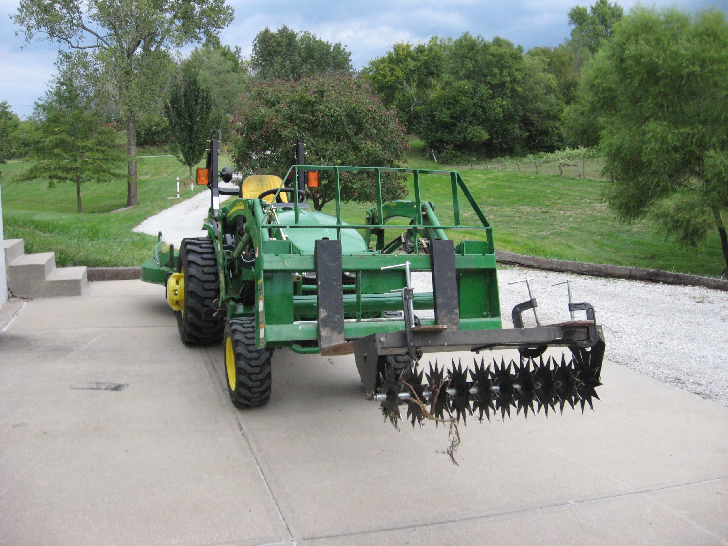

I sometimes clamp and old Brinley spike aerator to my pallet forks to rough-up ground for overseeding small areas.
   / Non Traditional Projects (What have you done with your tractor?) #95
I really like this idea
You have to be really careful with it. Just the weight of the loader and forks is almost enough to pancake the implement even without any downforce.....

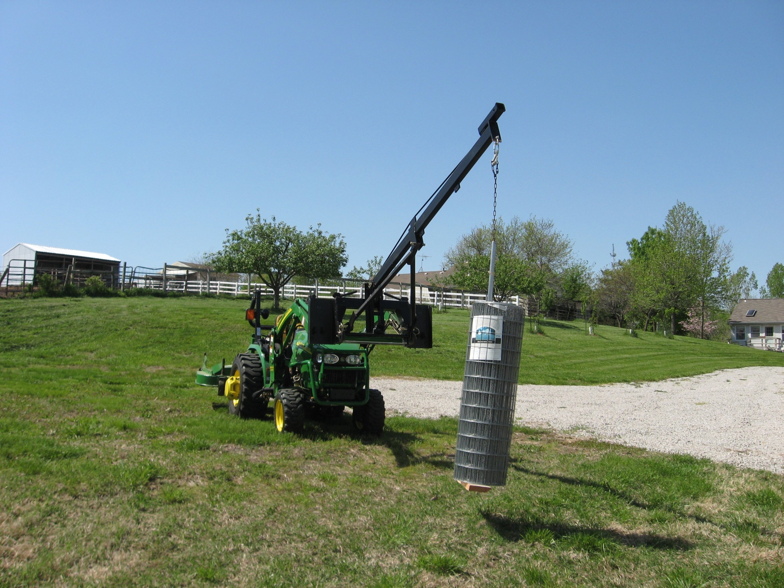

Another one, I have used the boom pole with a chain and piece of pipe to unroll fence wire.

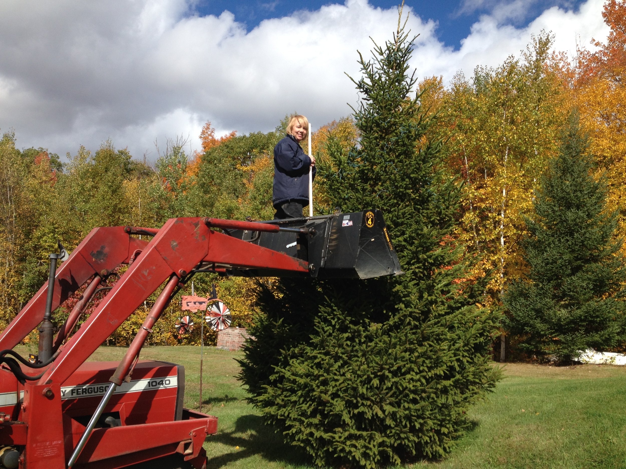

Good Afternoon,
I know not recommended but we have used it for Christmas lighting on one of our pine trees !
You can blame me, not my wife ! 😉

   / Non Traditional Projects (What have you done with your tractor?) #98
She knows that she's safe up there. It's a Massey!!!

If you use a swivel hook when hanging the fence wire, it rolls off much easier. Cam

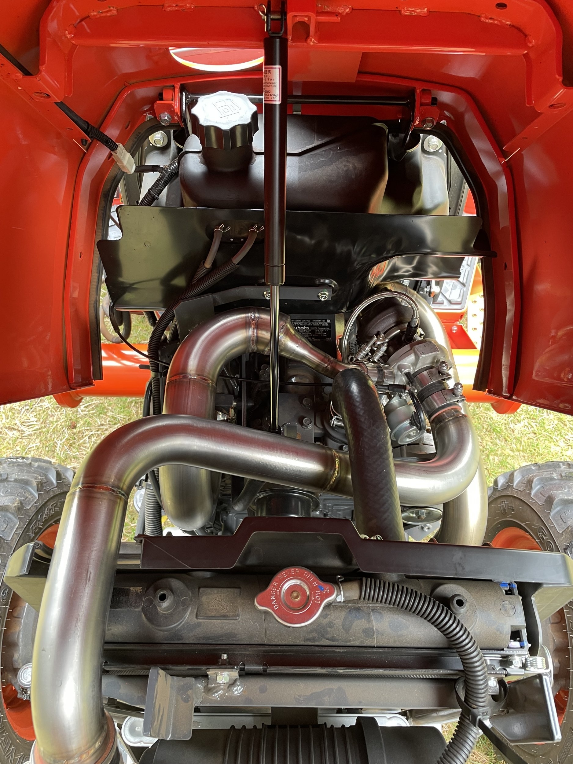

Turbo!
Kubota L2501 HST (Factory)
Engine Horsepower - 24.8 HP
Engine Torque - 70.2 LB-FT
PTO Horsepower - 19 HP
Turbocharged Kubota L2501 HST Engine Horsepower - 44.1 HP
Engine Torque - 109.8 LB-FT
PTO Horsepower - 35 HP
