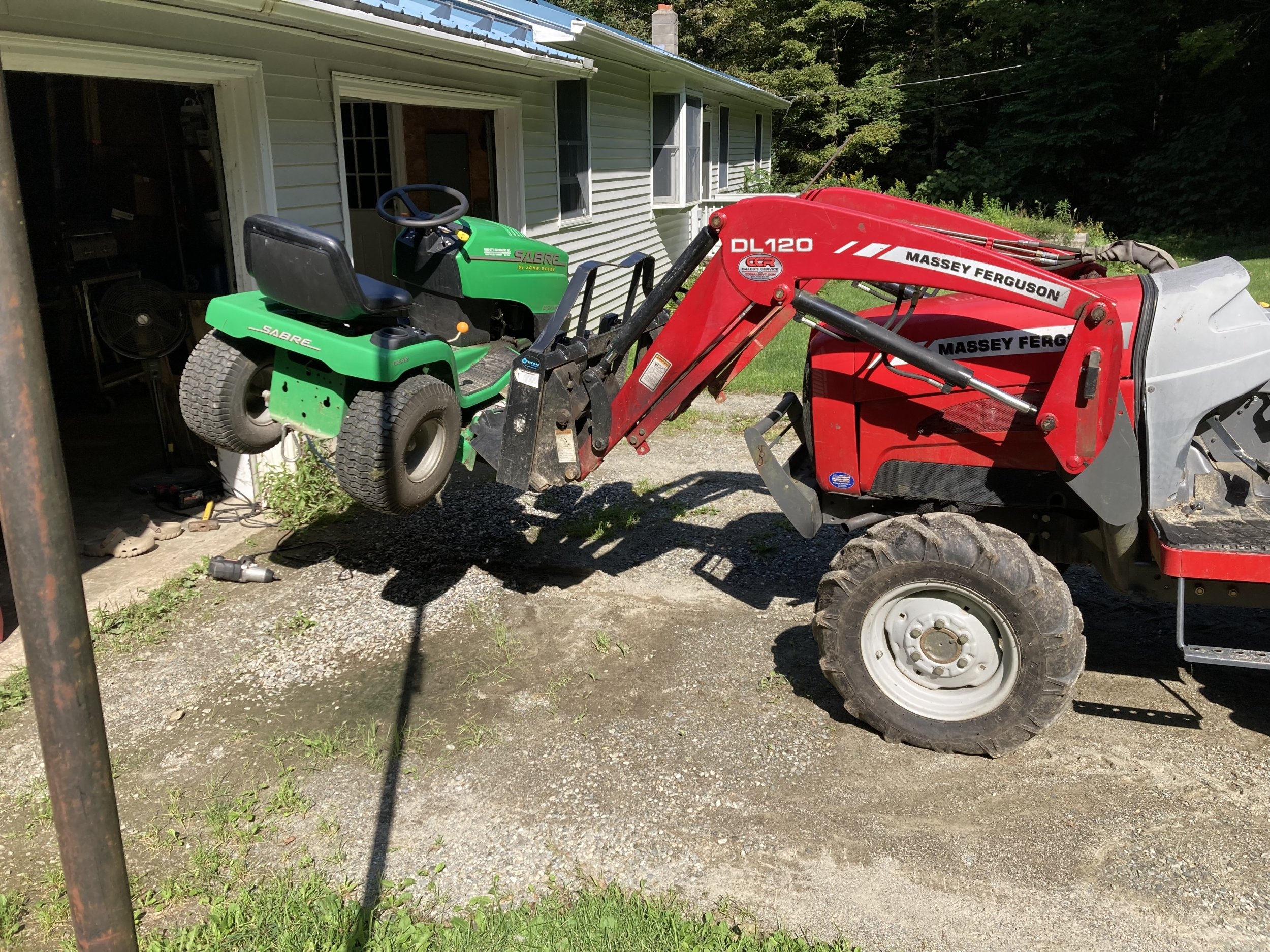

How about a red machine fixing a green machine? Makes changing the mower blades very eas.

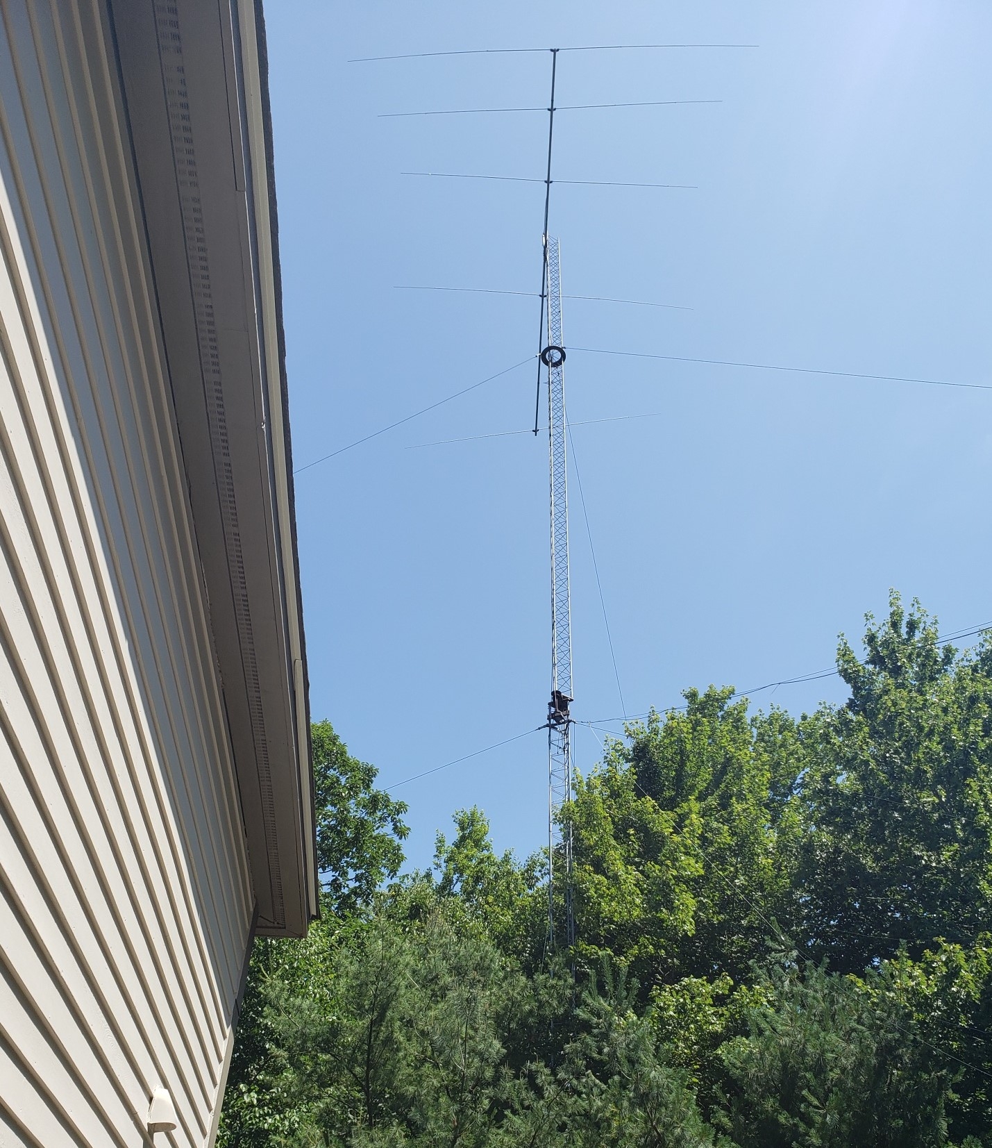

I used the tractor as a come along years ago to put up my 120' tower. Had a pulley at the base of the 1st 10' section that was set in 3 yds of concrete. The rope went up the tower to the gin pole pulley and then back to the ground. The next section to go up was just pulled up and lowered onto the existing section and bolted in. Move the gin pole up to he top of that new section. Repeat until 12 sections up.
My 16 yo son operated the tractor and I was on the tower. Tractor did all the 'work' including pulling the gin pole up each section.

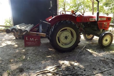

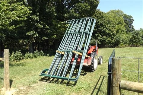

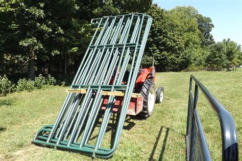

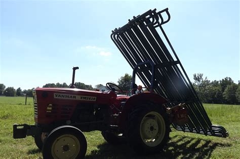

When I first got the tractor, my DW asked just why. I told her it saves me from back breaking work. She said prove it. In 15mins I got this odd idea. I still do it today. I can move so many cattle coral panels with ease and haul them a few acres to setup on the other side of the farm.
and with those same skid boards on the box blade, I can haul the thick and heavy wooden fence posts too.

the tower after it was erected. There is a bearing at 60'. The top 60' rotated.

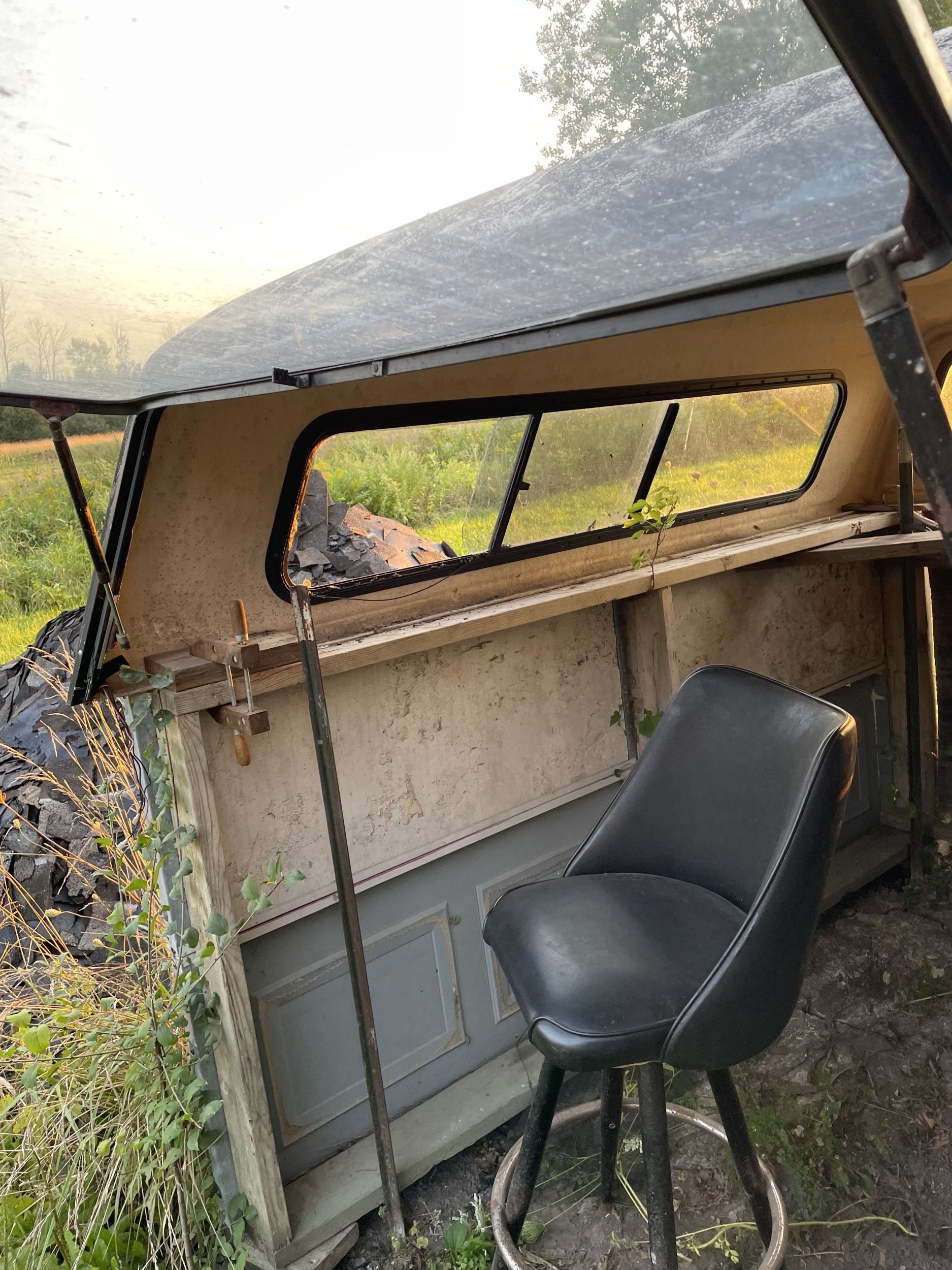

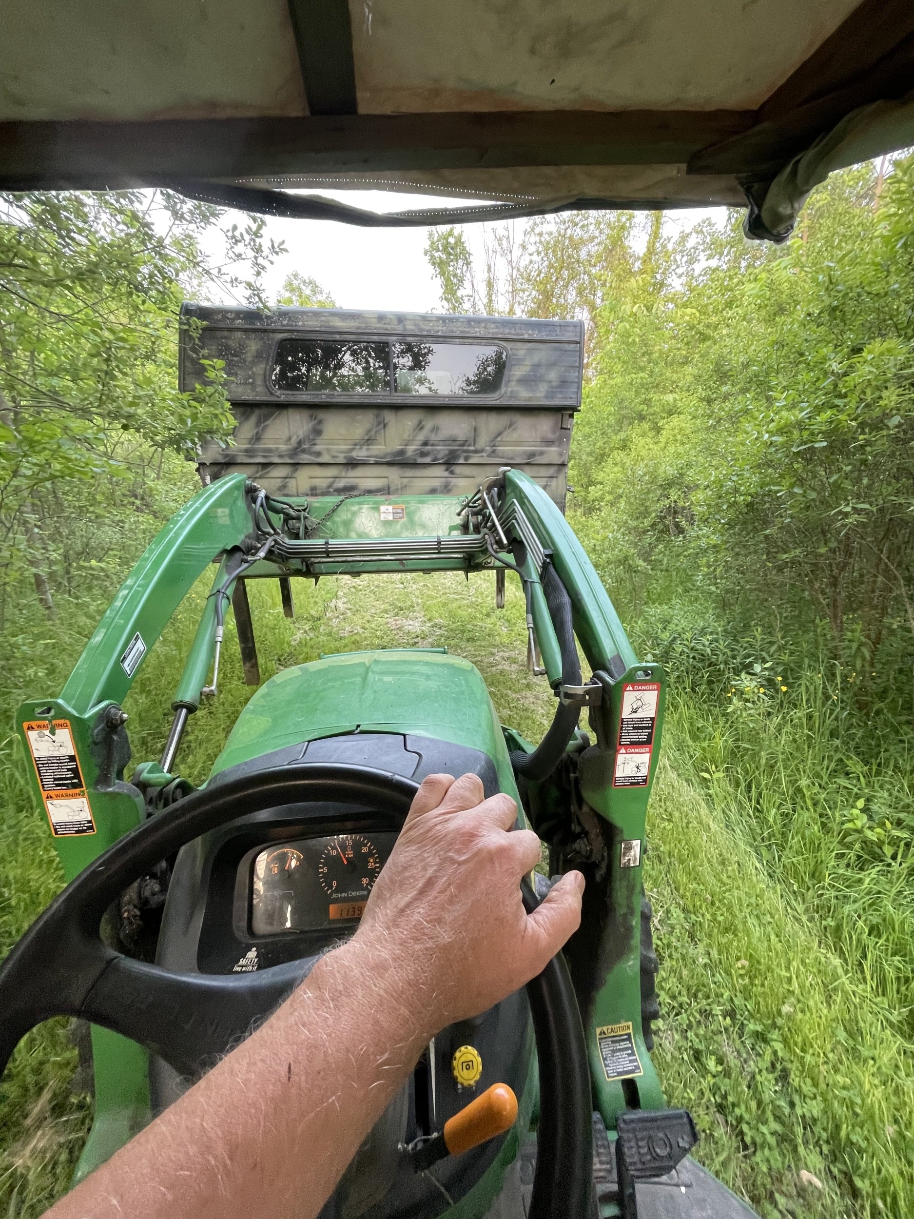

I made a couple of 3 ft long forks, from 3” x 1/4” x 3’ long angle iron, which I bolt to the bottom of my tractor’s heavy duty bucket. Each attaches with (2) grade 5 bolts, a 1/2” thru existing 9/16” holes in the cutting edge aligned with the loader arms, and a second 3/8” bolt thru 7/16” holes that I drilled thru about a foot back on the bucket (about 2’ of the forks extend out front).
I made several different wood “fork extensions” which fit inside the angle iron sections and are held on with a single 1/2” carriage bolt. I use the medium length ones (4 ft long) for moving portable hunting blinds:
