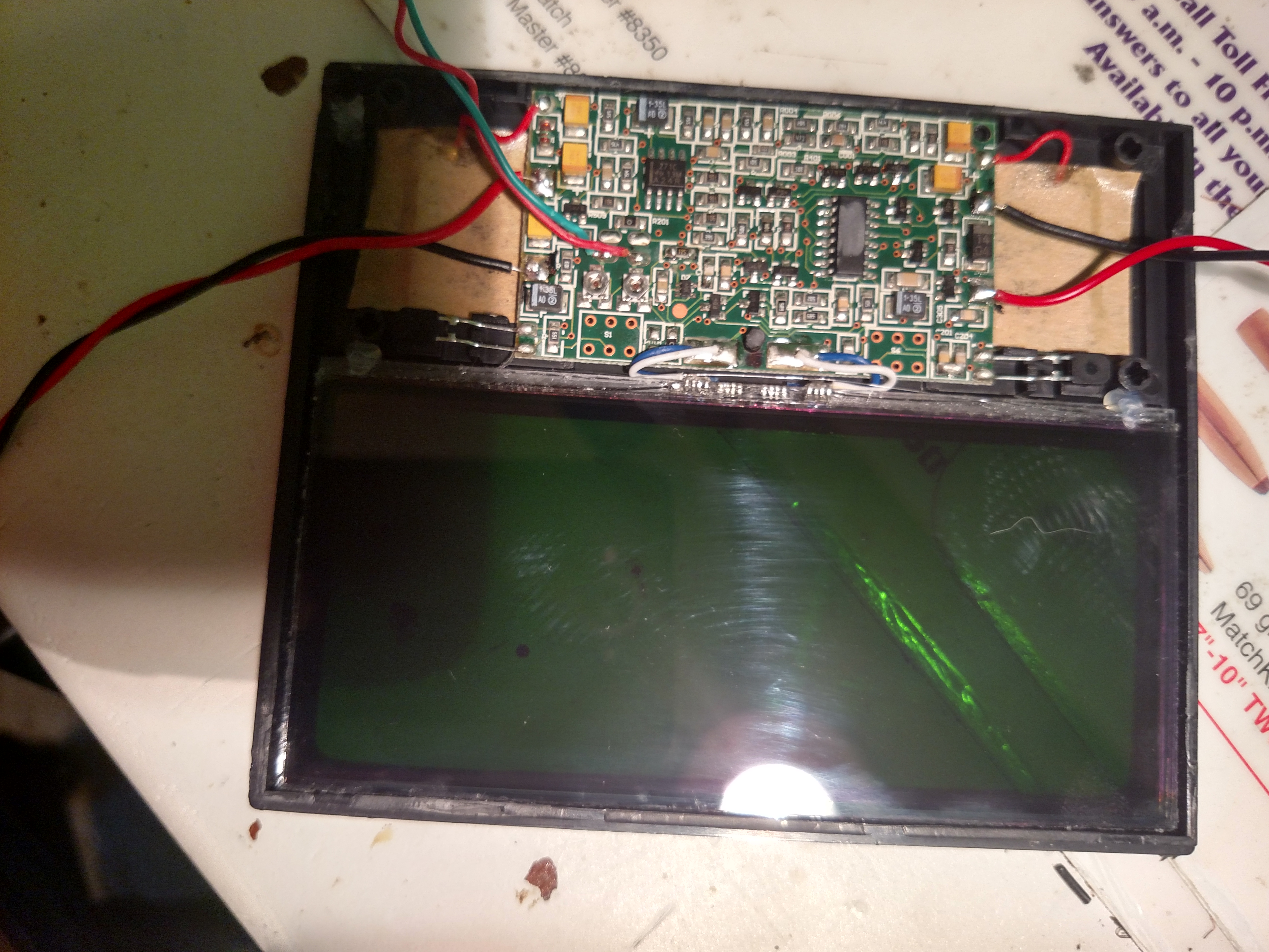

Okay Dokey, it is repaired. The two coin cells were dead. I installed two of the above twin AAA holders (with switches) into the helmet. The supplied tail wires were soldered in place of the coin cells, and notches made into the sides of the module to pass thru the wires. Four little tacks with the hot soldering iron in the corners to hold the module shut. Then install the module back into the helmet body and hot glued the AAA holders into the helmet body after roughing up the plastic on both pieces. Here are pics. Total cost to repair about $7 and I still have 3 of the battery holders left over. So I could repair 1 1/2 more helmets!:laughing: Total time about 30 minutes.

Wish I had saw this sooner. A couple manufacturers that I once worked for and won't mention ( Arc One and Optrel ) suggest putting the hood under a Halogen Work light for 24 hrs. It re-jump starts the lithium. It's not a sun issue it's about Lithium and Halogen. How ever it is pretty easy to undo the old lithium cells and solder in new ones. Or better yet, Don't buy a solar hood. I have a couple of Speed Glass. One from the late 80's and a 9000X from10 years ago. I hate the cheap Fibre Metal 3C type head gear but The lenses with replaceable batteries, Although much heavier, last a Long Time. I also have a Nex-Gen Jackson that is 14 yrs old. Not as good optical quality but still works.

Thanks. It was very easy to do. And now it uses AAA batteries you can buy anywhere, and replace them in seconds.

I bet you could connect the button battery holders together in parallel and feed them both with one battery pack. The unit draws very little power considering it had button cells and the AAA batts have much more capacity than the button cells. Less weight and less clutter in the helmet.
