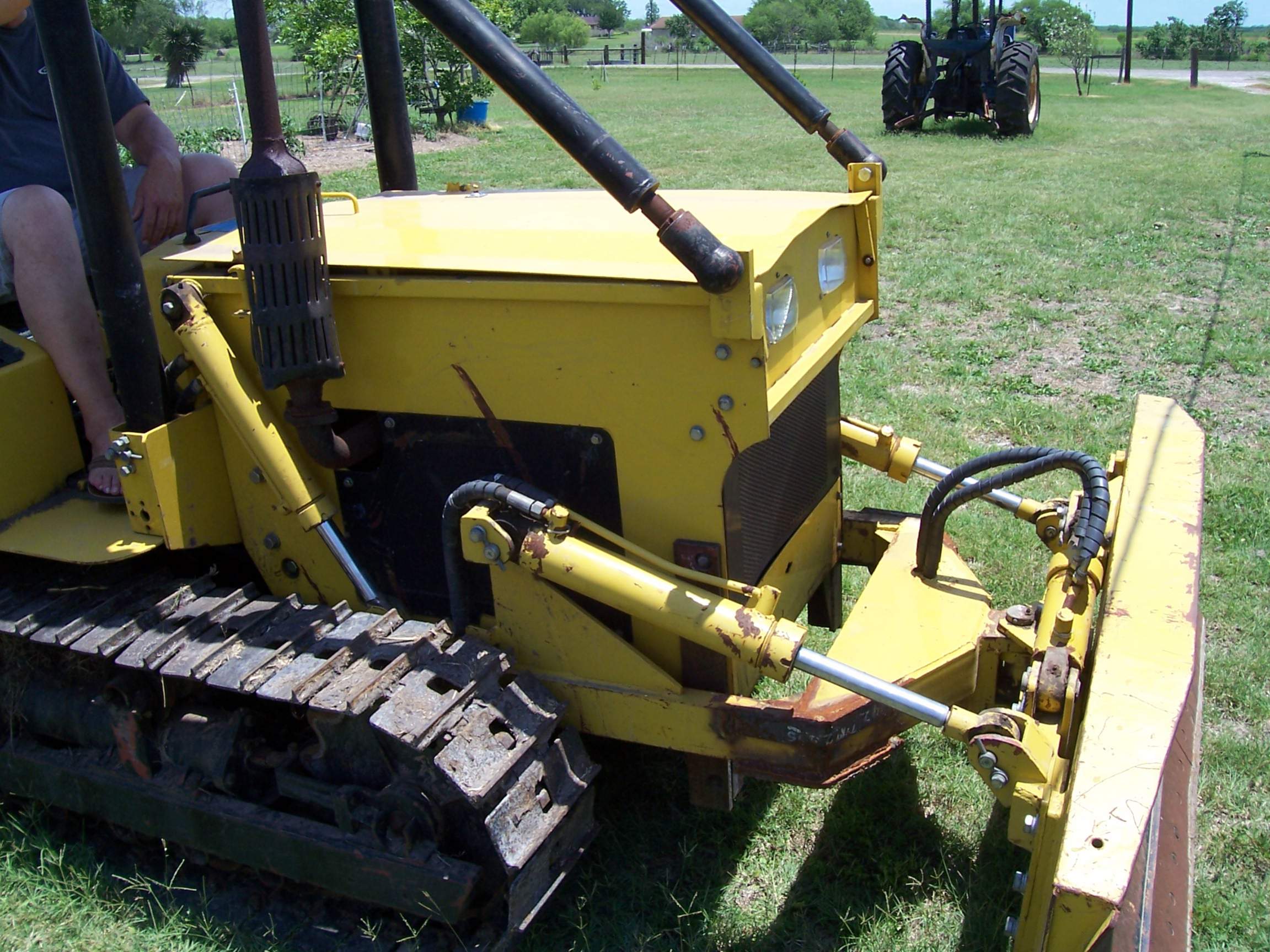

I am looking at a Nortrac NB 3500 dozer and need any and all advice.This machine is 03 or 04 model,150 hrs on the hour meter.Alternator is not working, fuel leak on fuel filter,lower links on 3pt need to be replaced, the rotary cylinders have been removed and both front corners (bumper?) have been welded with flat bar added, the cylinders were put on wrong sides and have wore the paint on the side cowling's, also appears that there's no bushings in the cylinder ends, alot of play when the blade is down.I would be using this little dozer to maintain 2 dry creeks,dig a small tank and cut several sendero's. The brush here is scrub brush and small trees.One concern that I have is if the hour meter has been changed out,the numbers on the tachometer are all white.Is there any way to tell wear (hours) by the tracks? Number of links in original tracks? The owner is asking $7000 or best offer.

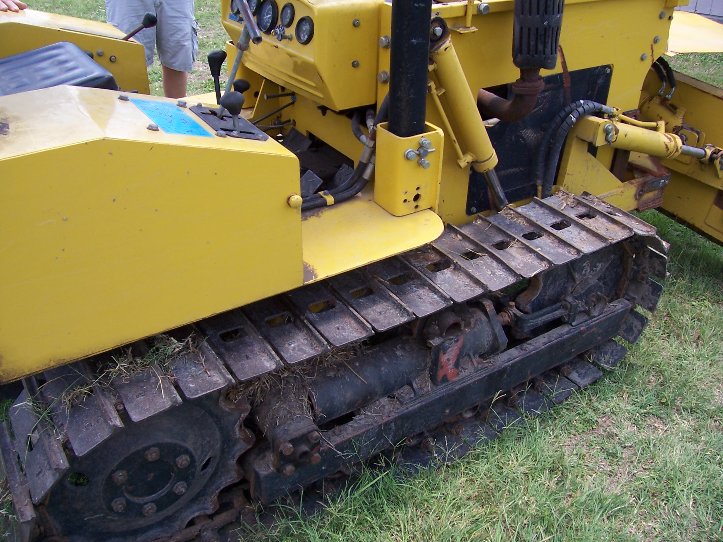

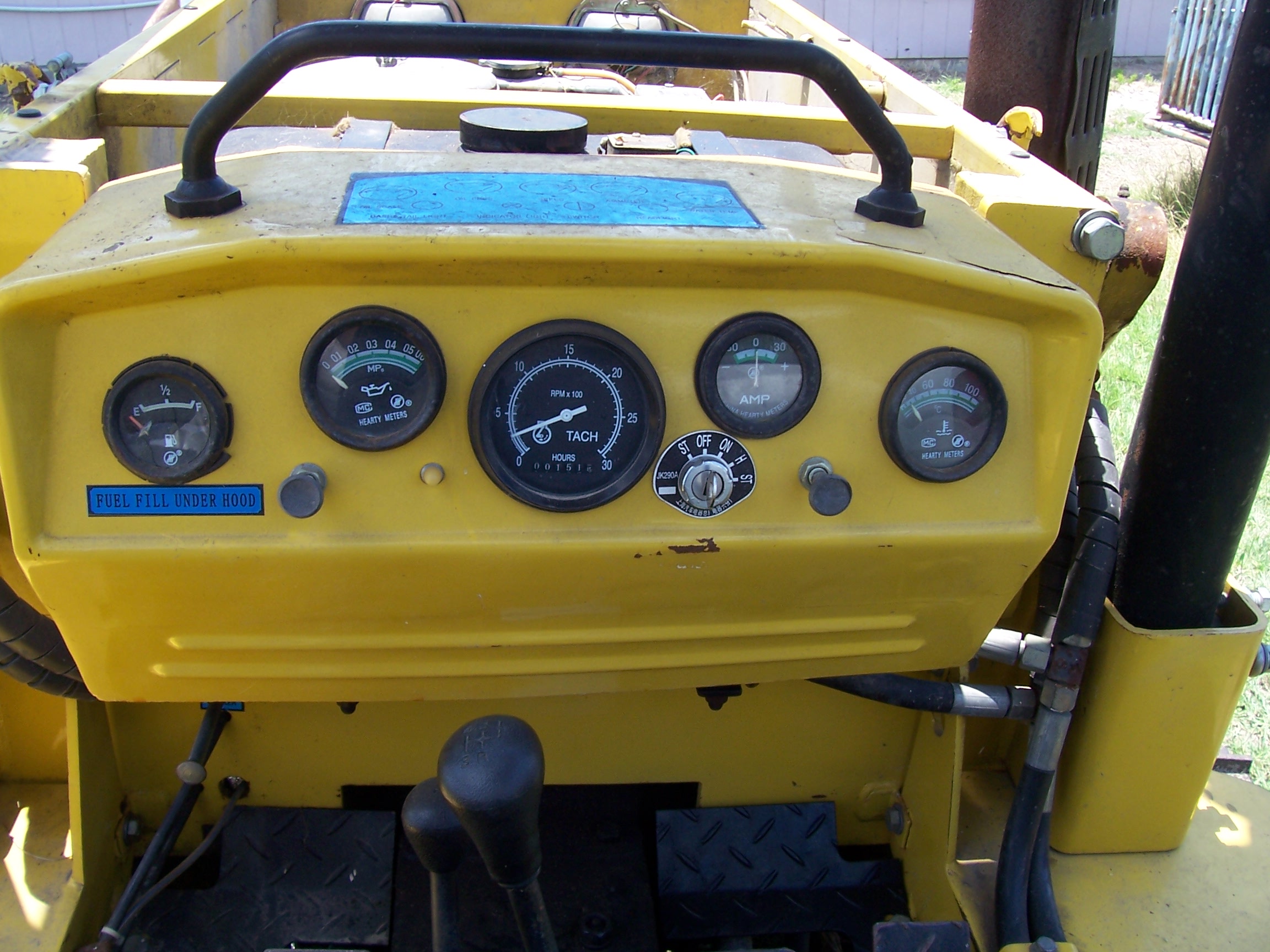

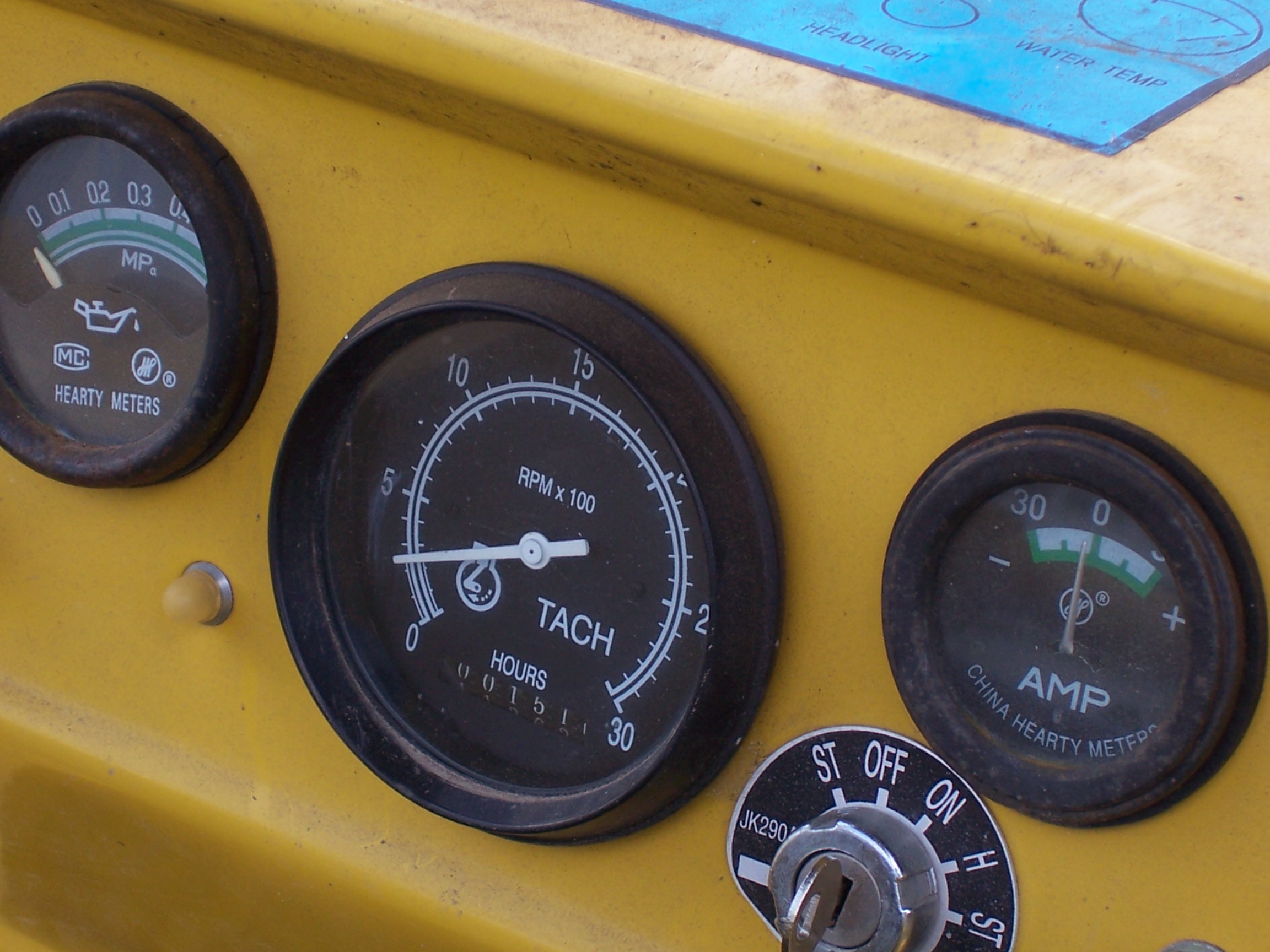

Here are the pictures, the first shows the welds.Could the tachometer with hour meter be original? The bezel appears a little different from the other gauges.

The tach appears to be OEM, looks just like mine. The tach can still function perfectly for r/m, but the hour meter can be bad. One way to check is to turn on the key switch and wait to se if the meter advances.
What I find disturbing is the scuff marks high up on the engine screens and sheet metal. This suggests gross abuse, pushing at a hard angle with the blade raised, which is probably attributable to the wishbone failure. One must remember that these are not a Cat D8, and must be operated accordingly. From what I can see the track shoes look good.

As for the alternator, the OEM has only a 14 amp output. Most likely it has a bad voltage regulator, or there is a bad connection to the field. I upgraded my alternator to a 78 amp Delco 12Si since I run an electric winch. Not hard to do.

From the looks of the welding on the wishbone, you can expect another problem in the same area again in the future. You can't weld a stressed joint like that without proper pre- and post-heating and correctly designed gussets. All that welding has accomplished is to shift the failure point a few millimeters away at this point. Not a total failure - it can be done right the next time and be just fine. Just be aware that whoever did that job wasn't a real welder or heavy equipment repair person.
I agree with Bob, it looks as though the machine was abused a bit, though not grossly. Probably owned by someone not familiar with the limits of a small dozer who tried to to do too much with it.

The engine fired right up,no smoke,it sounded good. I don't believe the owner used the compression release. He ran it for a short time, it turned on a dime.I think the scuff marks on the engine cowling came from the front cylinders, he must have removed them to do the welding and it appears he has them crossed.Looking at the first picture they are turned in, should be turned out.There is alot of slop on these cylinders, like the bushings weren't put back in, I presume bushings are used,are they available? I sure appreciate all ya'lls time and advice on this. Also this machine was supposedly bought new from N/T by the father in law, now the son in law has it, one family ownership, several users.
Mike45tx, I have the manual infront of me (but don't have my glasses) from what I can see there are NO bushing just the pins. My manual is for a newer machine but I don't believe they are all that different. I have made bushing for worn out cylinders so it can be done if your'e trying to sqeeze out that extra amount of life left.
While they had it running did the cylinders hit the cowling?
