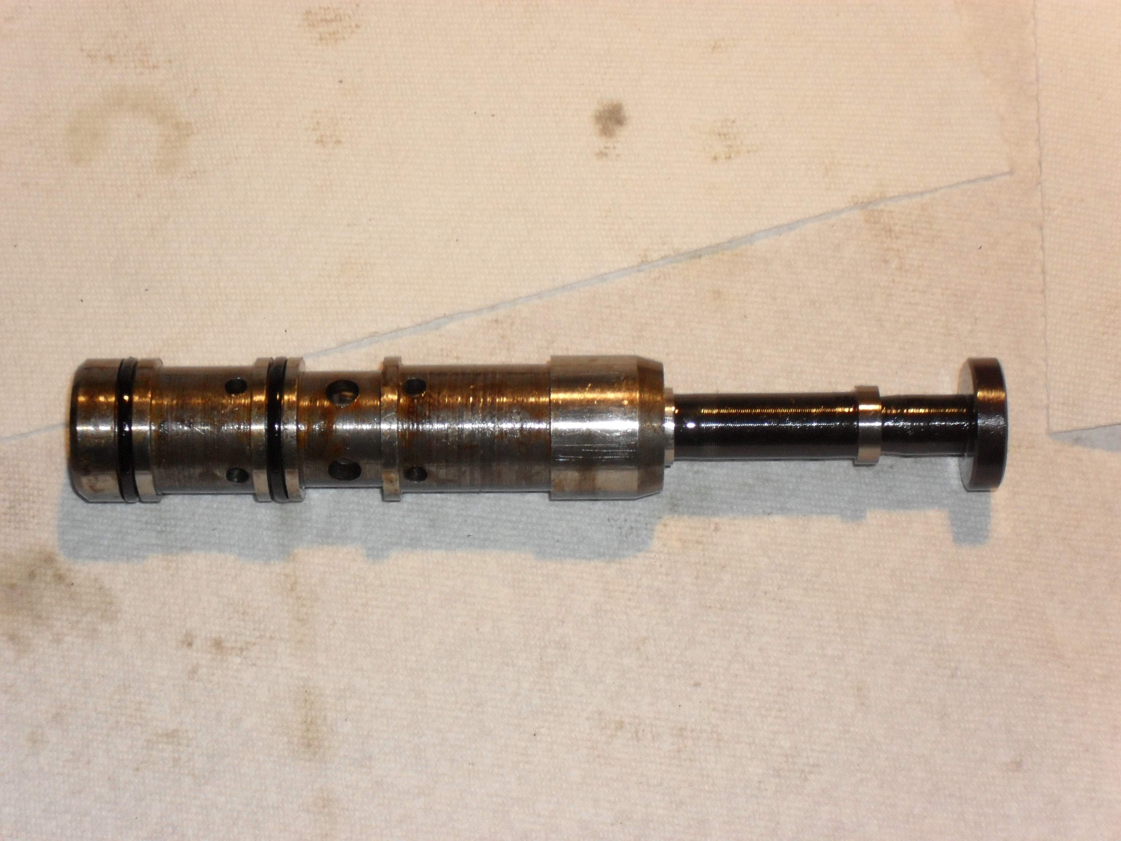

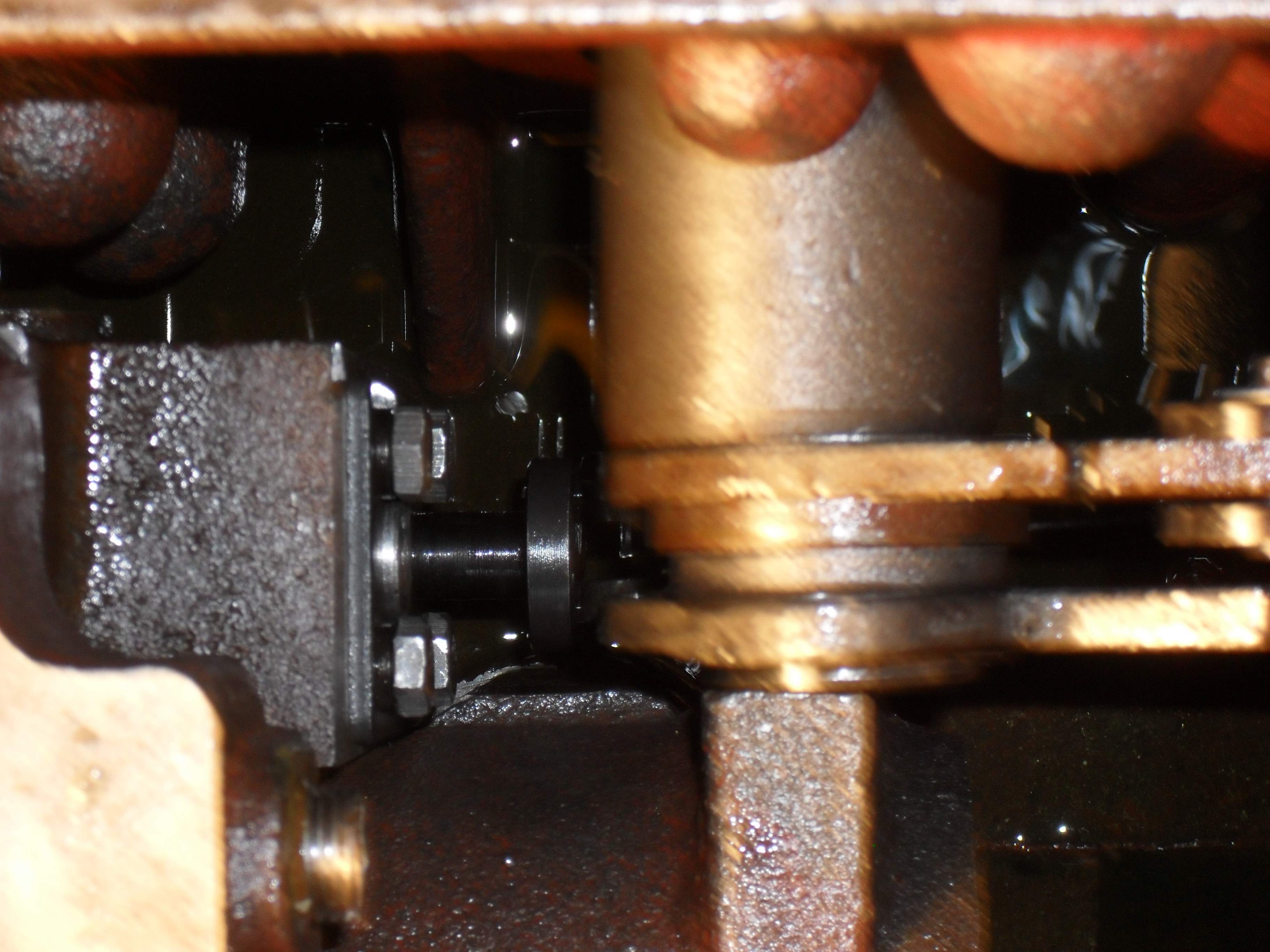

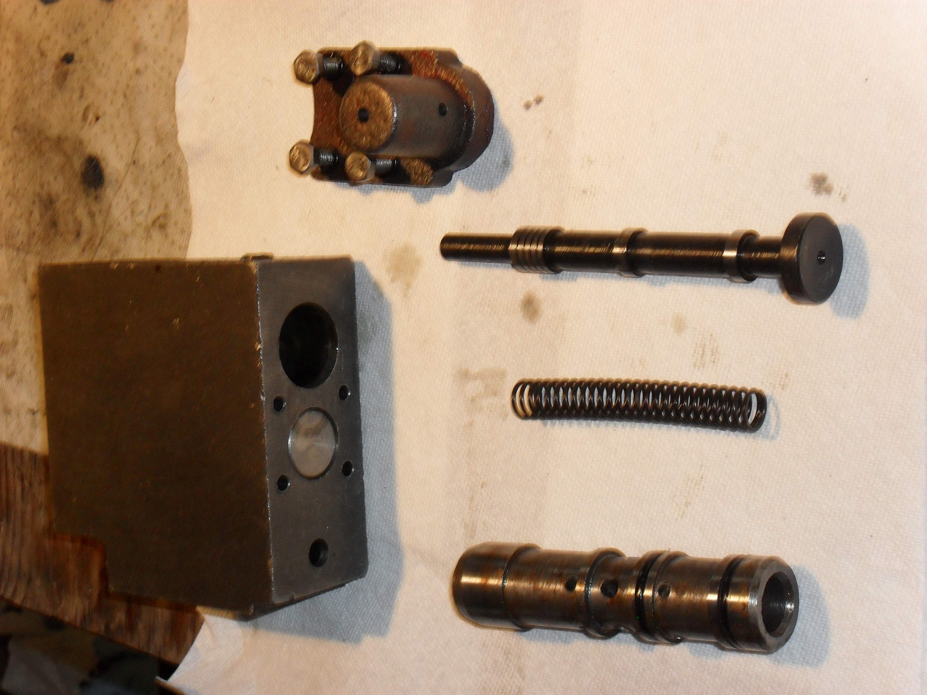

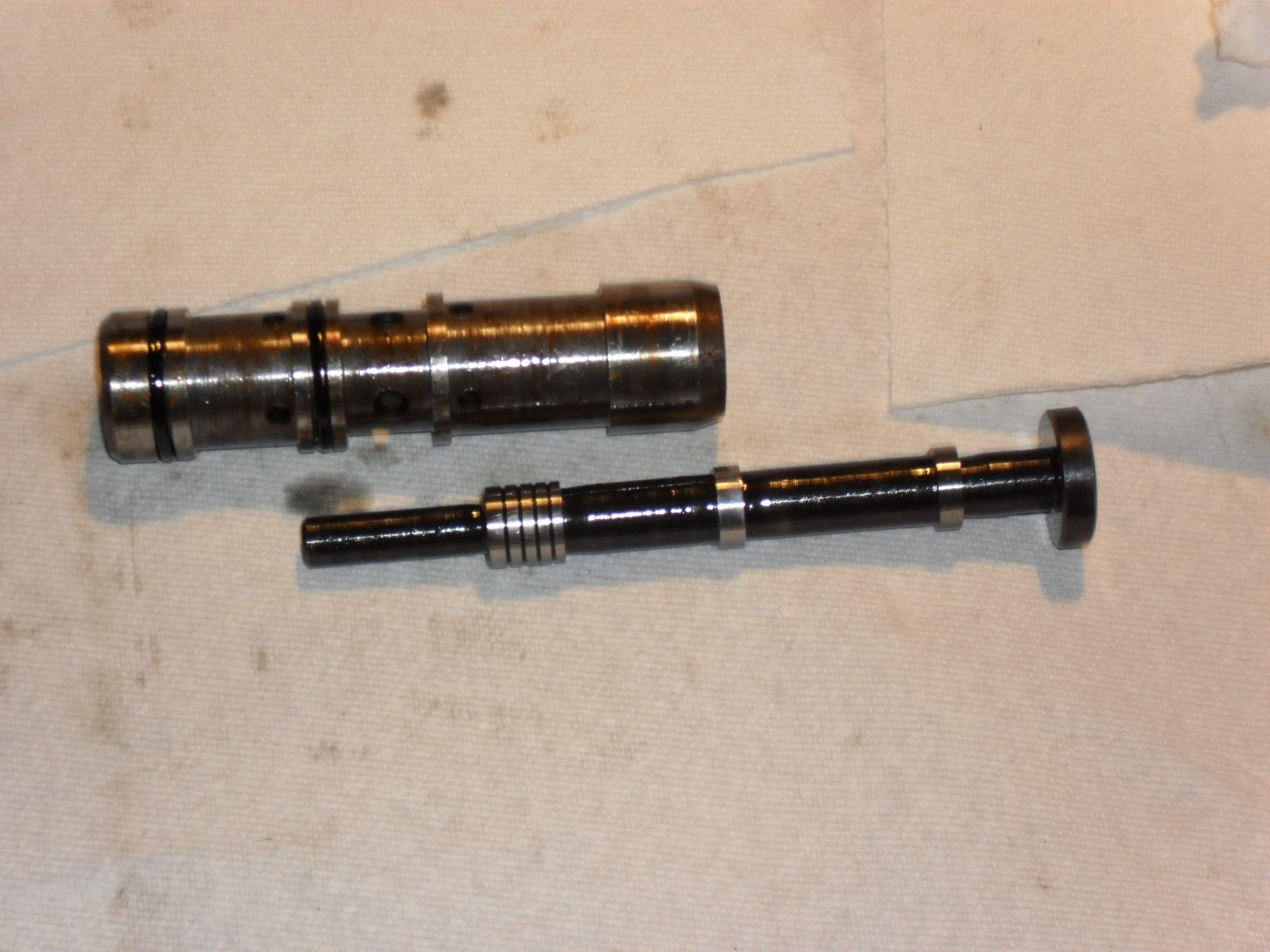

Hey Guys
Finally got the lift fixed. What took 3 weeks to do, could have taken me 4 hours. I took pictures of the tear down to make sure that I rebuilt it the way I tore it down. It wasn't very complicated, however it did take take some reasoning to figure out why the engineers decided to make something like this. I didn't take the reservoir of the tractor. I thought I would see if I could replace the cylinder seal. It was still good. It took 40 pounds of air pressure to get it out of the cylinder housing. This tractor only has around 67 hours on it, and I find it amazing that the part that I removed had rust on it. This part fits into the block housing that operates the stem which has the oil by pass ports. The controls where useless because the stem had stuck inside of the cylinder. The spring wasn't strong enough to push the stem back out to to touch the controls. In essence the oil was by passing the lift mechanism acting more like a relief valve. Here are some pictures in which you will see the parts that got stuck. a (11).jpga (12).jpga (13).jpg006.jpg After looking at the last picture you will notice that the stem is sticking out about 3/4 of inch. When I first started working on it I didn't know that it was stuck and needed to be out this far. It was push flat to the block. I hope this will help anyone else that is having a problem. I really can't explain why it has rust in it. I took a brass wire brush and to the cylinder and 1000 grade emery cloth to the stem. Thinking that I found the problem I re-installed everything and it started working again.
Stanley
   / nortrac NT204C #16
Hydraulic fluid is hydrophobic, which means your hydraulic fluid has been contaminated with water. When oil and water are combined with heat and vibration, they form an emulsion, sorta like a sticky foam. That crud will be sticking to any interior parts of the hydraulic system that are not keep clean by regular flow. Unless you get rid of it, it will continue to contaminate. You should perform a thorough flush with kerosene before refilling with fresh hydraulic fluid.
