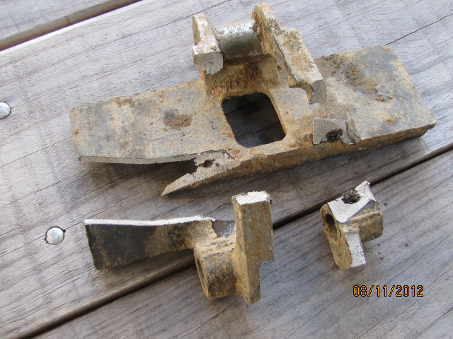

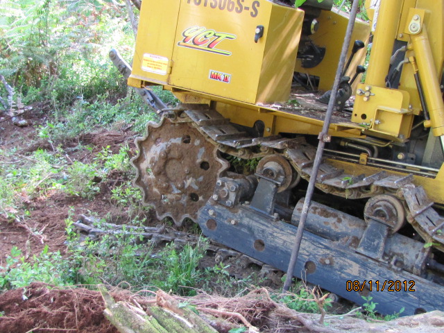

Broke a track shoe today not sure on the procedure to repair my plan is as follows any advise would be much appreciated
1. Back off the track tension adjuster as much as possible
2. Remove as long as length possible of track from the top by removing a track pin
3. Place the removed track behind the dozer and just under the drive sprocket
4. Drive/winch the dozer backwards onto the track
5. Join both sections of track together
6. Join the ends together and insert the replacement shoe making the joint with both ends half wrapped around the drive sprocket
7. Adjust the track tension back to the correct tension
I am not looking forward to putting the final pin in any tips where to position it and or how get the two ends together to get the pin in would be appreciated
http://i1262.photobucket.com/albums/ii610/timbatrader/IMG_0615.jpg
http://i1262.photobucket.com/albums/ii610/timbatrader/IMG_0613.jpg
   / Nortrac / Yuchai Dozer questions... #99
timbatrader just from the one photo I might just try to fix it without moving the machine or track more than enough to be able to repin from the bottom side by driving wedged shape timbers to force the link connection to line up using a drift punch?
are the black places defective places in the link? Did something get under that link or was it was torque pressure from braking/turning.
Do you have access to a backhoe?
How do you rate the under carriage? 100%, 50%, etc?
   / Nortrac / Yuchai Dozer questions... #100
Two heavy duty C-clamps (four total) on each side of the shoe at the free ends of the track holding a short piece of chain between them. Run a come-a-long between the chains on each track end and draw them together. You will probably have to depress the right steering clutch so the sprocket wil turn. I remember doing that stuff on D8's way back in the woods - back in the day. Blocking the dozer up will be a great help, but so far you've got the right plan going. Good luck.
That shoe edge is bent pretty badly, just what are you doing anyway? You have to remember that these are lightweight machines, so don't treat them like they are a D8 - they're not.
