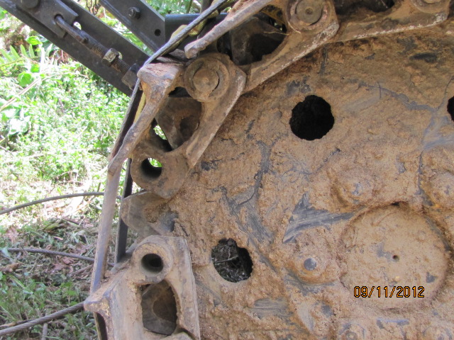

Thanks for the words of wisdom guys I’ll try to answer a few of the question
1 are the black places defective places in the link?[/I] It looks like pockets of black carbon in the casting I need to get checked out by an expert could be just how it broke
2 Did something get under that link or was it was torque pressure from braking/turning. Nothing caught in the tracks just pushing in a straight line a ball of scruby trees blade hit a bigger tree machine stopped then track snapped
3 How do you rate the under carriage? 100%, 50%, etc? the machine only has 30 hrs on it so carriage should still be 100%
4 That shoe edge is bent pretty badly, just what are you doing anyway? You have to remember that these are lightweight machines, so don't treat them like they are a D8 - they're not. Yes I know it is a lightweight machine but the scrub I were pushing over is no bigger than what I have done in the past with and old 743 Bobcat
   / Nortrac / Yuchai Dozer questions... #102
The part I think was defective was the cause of the failure. I have never seen a break like that even from abuse. It was just a failure waiting to happen I expect. It would be nice to know ASAP if this will be a repeating fail point of that set of tracks. At only 30 hours and doing a straight push I really really do not see any abuse.

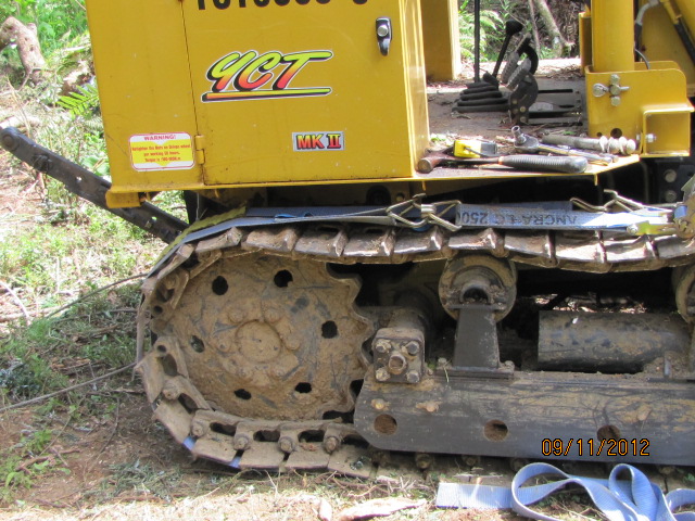

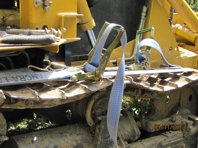

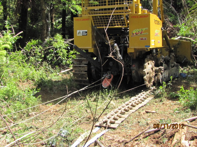

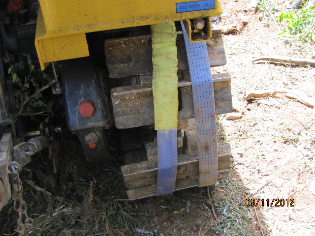

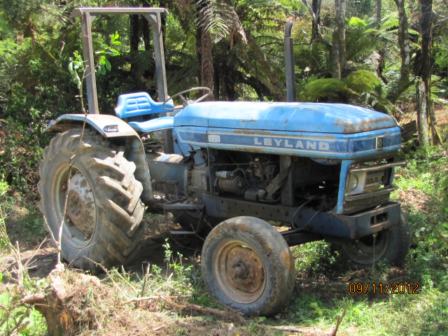

I followed through on my plan detailed in earlier post only difference I laid a couple of cargo ratchet tie downs under the tracks before driving/towing the dozer back onto the tracks
Photo of tracks laid out ready for a tug from my trusty (rusty) old Leyland 344
   / Nortrac / Yuchai Dozer questions... #104
another couple of photos missed from above postratchet.JPGcloseup.JPGIMG_0622.JPGIMG_0627.JPG

timbatrader that is an impressive solution and it looks like you now only need the new part.
That is a very nice looking dozer and as with most any machine made today you will just have to work through this type of factory defects.
Did you order a spare link. :)

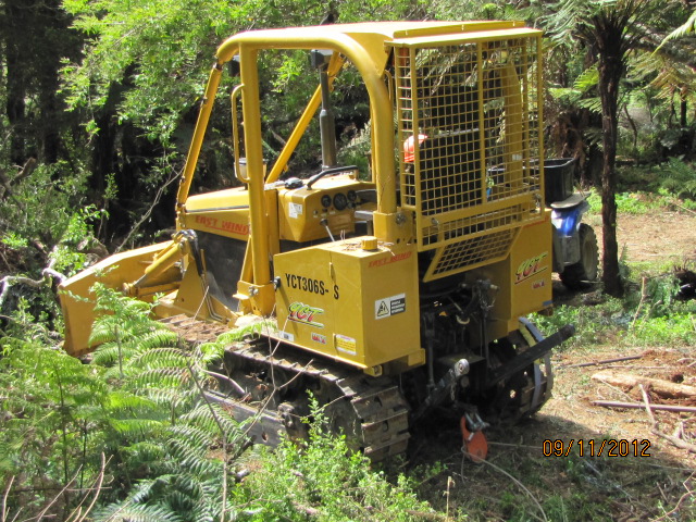

Those Eastwind people really know how to set up a dozer. Nice touch with the pre cleaner coming through the hood.
   / Nortrac / Yuchai Dozer questions... #107
Yes the pre-cleaner is nicely tucked away out of harms way the downside being every time you open the hood to check the water you have remove it
