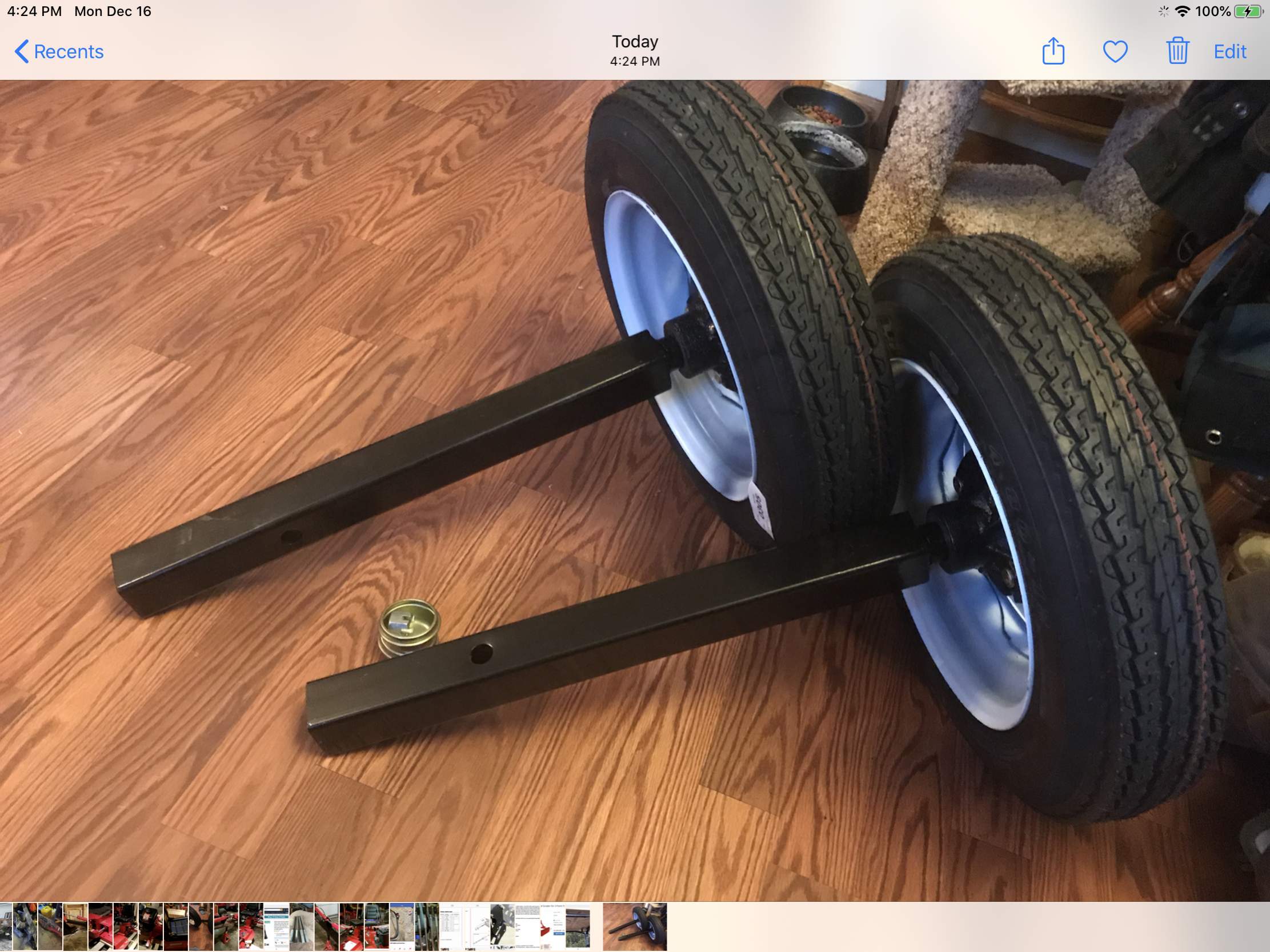

My two extra axles showed up today so now I have four wheels on it so I can move it without starting it up.
