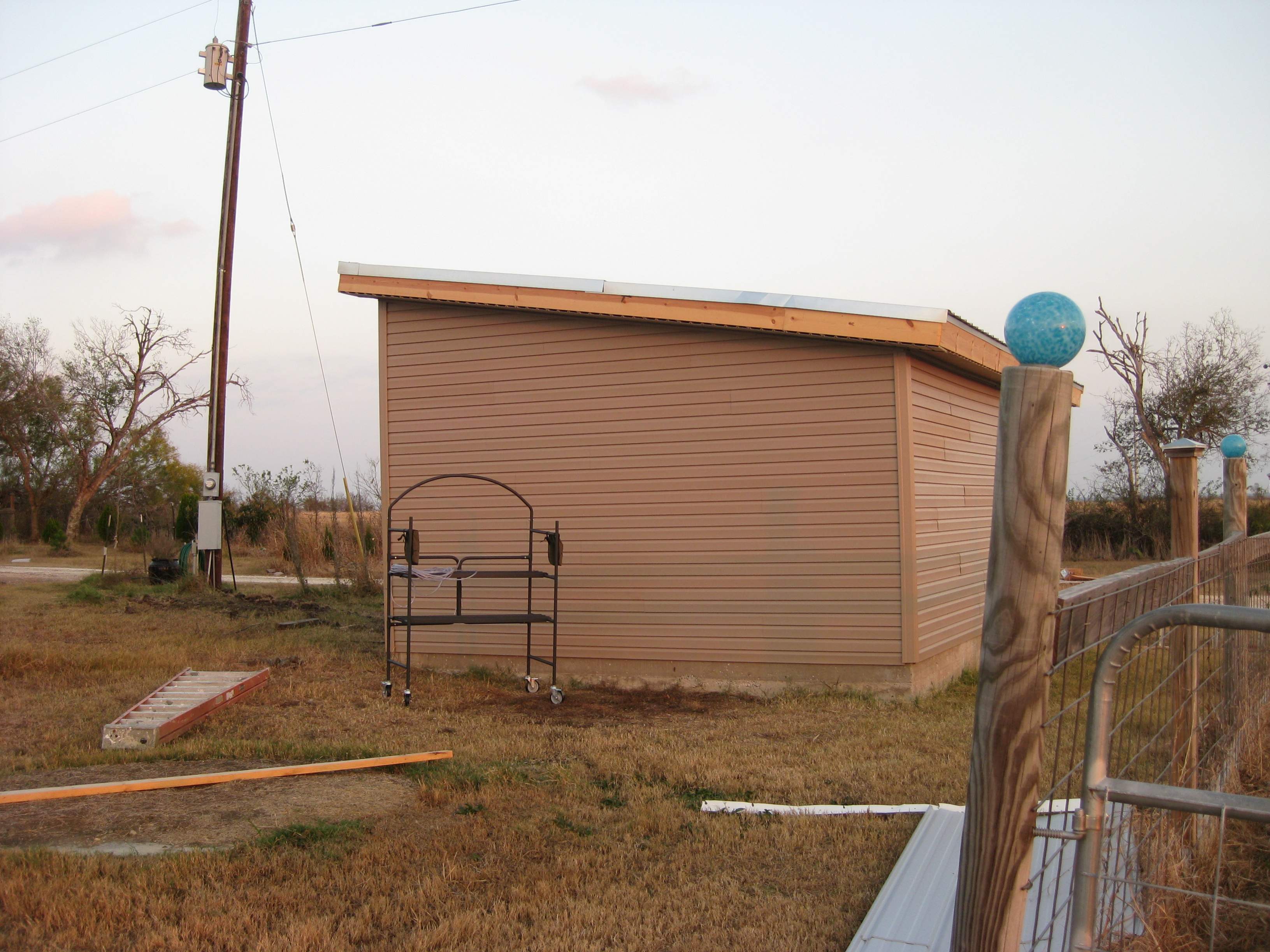

Nice looking building--looks to be strongly made!! Just out of curiousity, what are the turquoise balls on top of the fence posts for?
I could say that is my wife keeps them, but this is a somewhat family oriented group.:laughing:
The fence is around a garden and they are for decoration. I like putting some type of cap on a wooden post to keep water from pooling and spliting/rotting the posts. Even with PT posts, it can be an issue

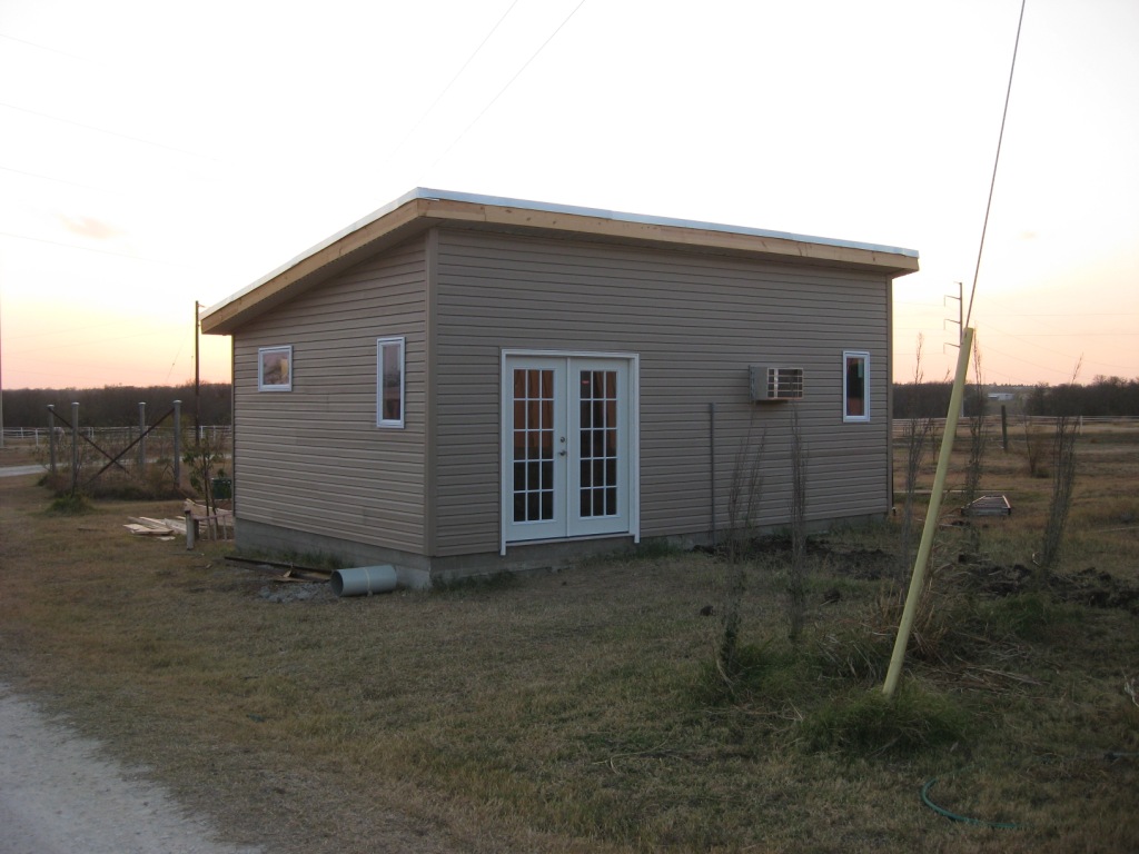

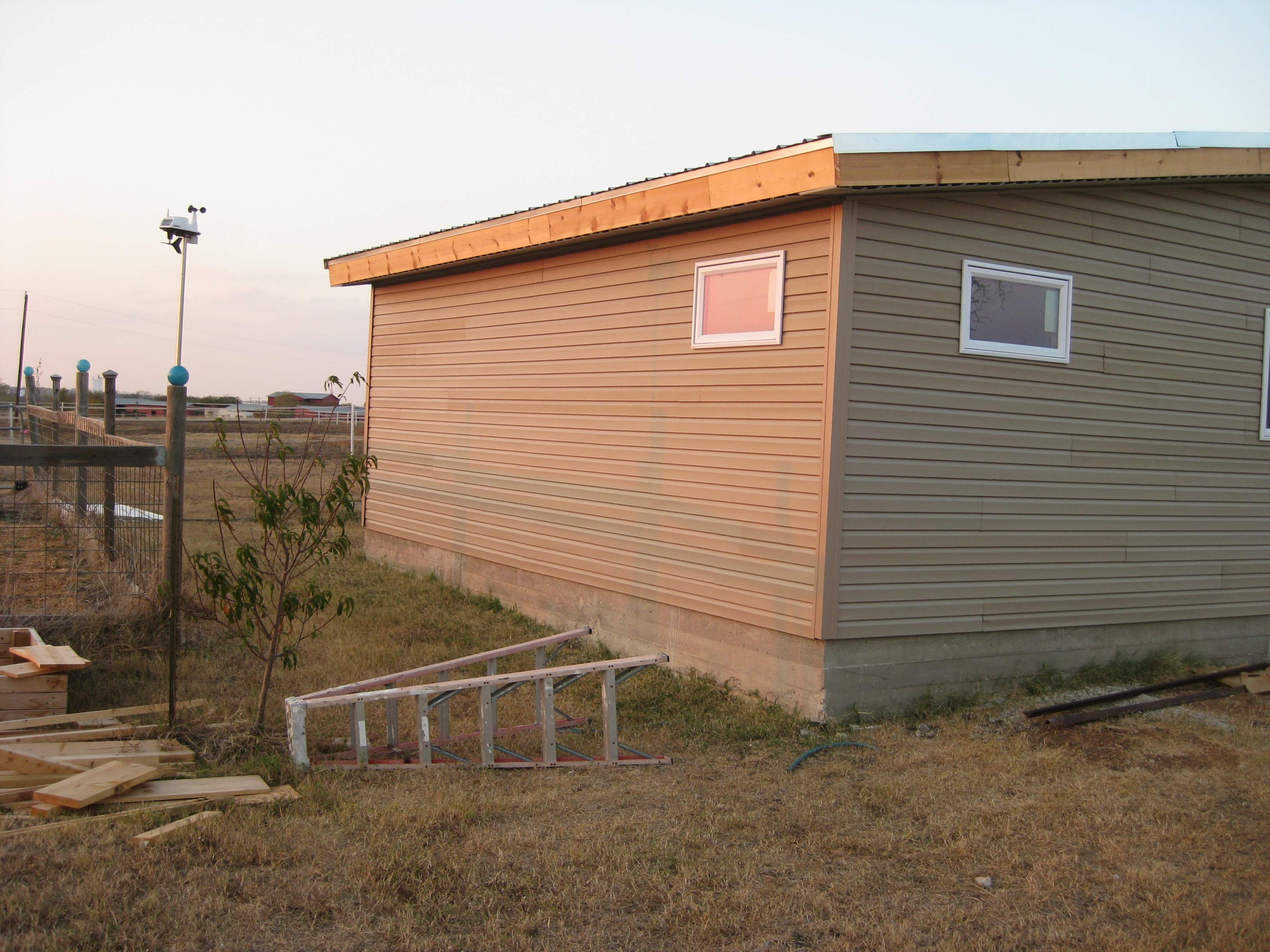

Finally got the siding on last week.
I decided to go with vinyl. I thought about Hardi Plank, but I already had ~ two squares of the vinyl left over from the house :D, please the vinyl is much easier to work with.
I had the electrican out last Friday and he did a very professional job roughing out the building-did everything to IBC even though I do not have to have an inspection. He did it a very good price.
Next up insulation and drywall (oh my back)

I bet those long gable cuts on the sides were tough if you were using snips to cut the siding. Looks good.
   / Not big, not pretty, but it is mine
#30
Only used the snips for some small cuts.
Dor the long angle cuts, I used a paneling blade (in backwards) in the skillsaw.
For the cross cuts, I decide to bite the bullet and force myself to buy a sliding compound miter saw :cool:
