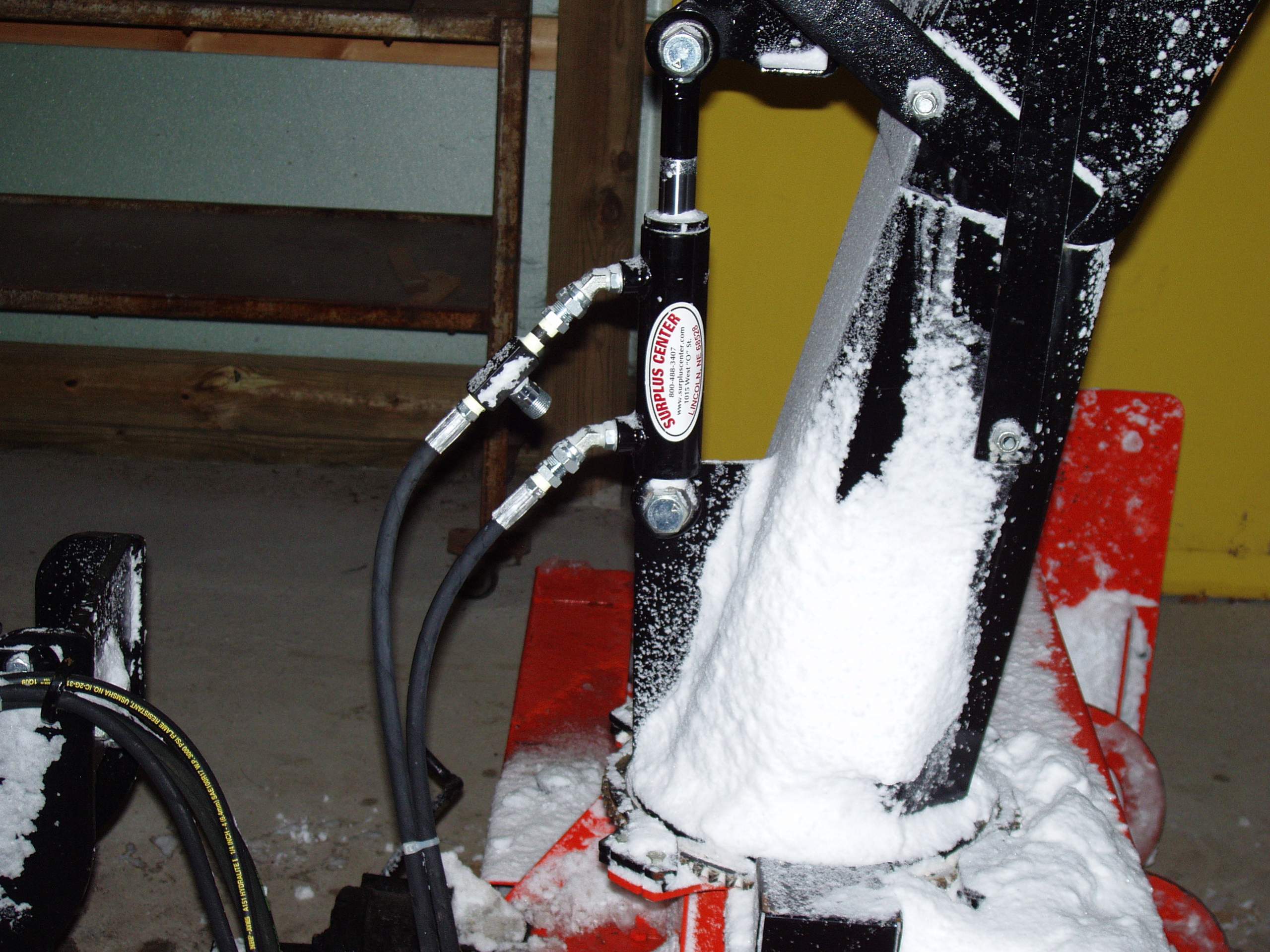

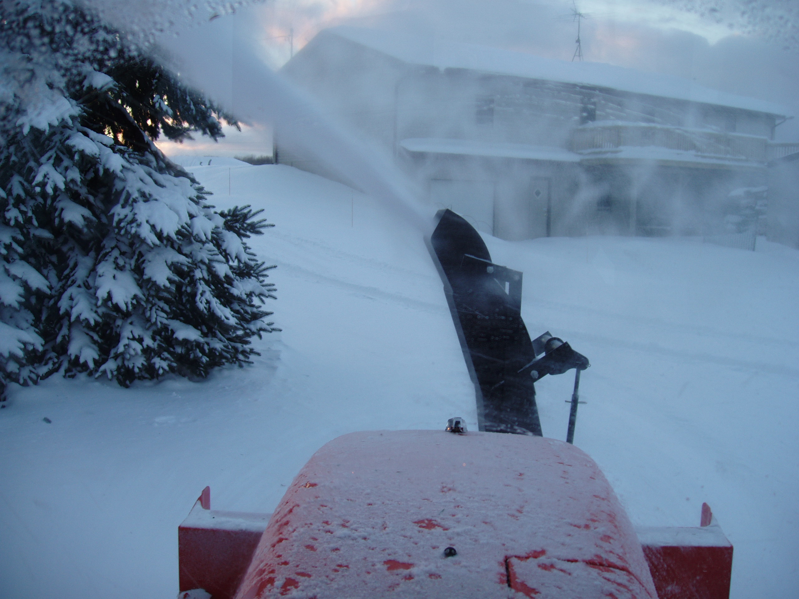

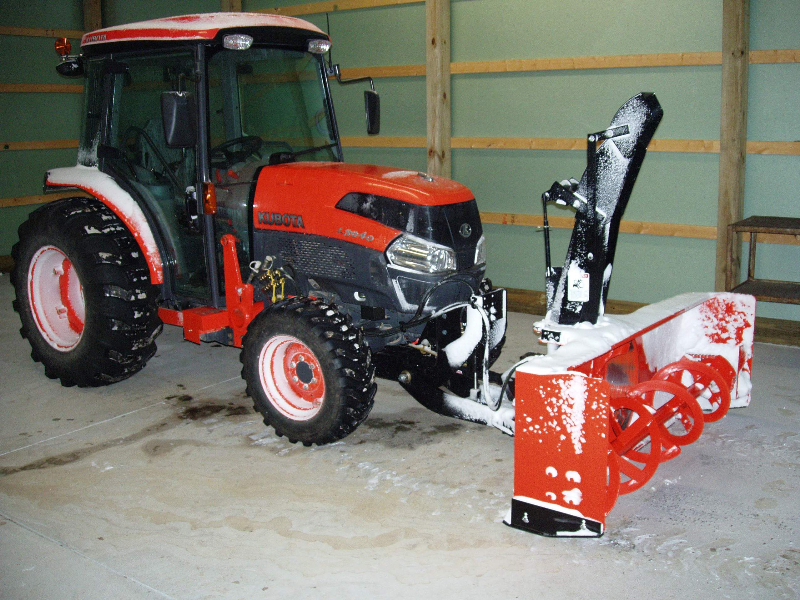

   / Not enough tractor or bad strategy? #49
The OP needs one of these:thumbsup:
I added hyd to the flipper last year.

I have a cab:thumbsup:
Yes, in some situations a plow is faster. In mine it is slower and the banks make the drifting that much worse.
I have a drive down around the walk out and my shop is down there so when the snow blows over the buildings in can get deep!!

Front blower, with a cab, will work. :thumbsup:
Unless you have a gravel drive :thumbdown:
