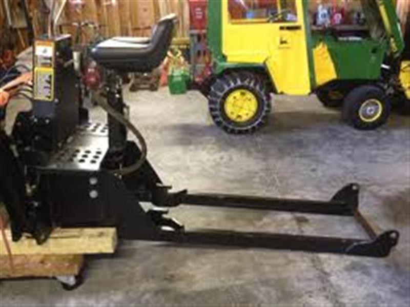

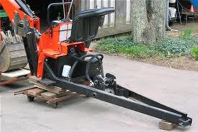

A subframe is critical on most tractors because it protects the tractor from breaking in half!!
The Hoe on the rear puts a lot of strain on the center of the tractor that it is not designed for so the subframe adds strength and removes shock to the middle.
   / Not my day #20
Well I must be retarded cuz I don't know what a subframe is. The first time I hooked the backhoe up I did use a piece of pvc pipe, but from the seat I reached down and moved the three point arm over in position. The biggest thing for me is I can't see the when the holes line up so I get up and down numerous times til I get it right. I have four cinder blocks, two on top of the other two with a couple 2 x 4's. When I get thru with the tractor I back up over blocks and ease it down to get the pressure off. Not sure what was meant by Mahindra backhoe attachment setup, its just another three point implement. Pump on pto so no hoses to attach.
Mine had a PTO pump, back up close, put the pump on, use the backhoe hydraulics and the PVC pipe on the lift lever to align the lift arms and the solid top link.
Subframes:
