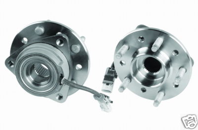

Very interesting. I have never seen a sealed bearing in all the trailers I have worked on and that has to be well over 200. I always said I was going to make a Disc Brake conversion using GM front bearing off front wheel drive cars like Malibu's. They are a dime a dozen but have a high failure rate, maybe 65,000 miles or so on average, but plenty long for the average trailer user.
It would give trailer users the best of everything, sealed bearings and disc brakes.
GRAND AM MALIBU ALERO CUTLAS FRONT WHEEL HUB BEARING :eBay Motors (item 320395530637 end time Aug-07-09 09:27:13 PDT)
Chris
