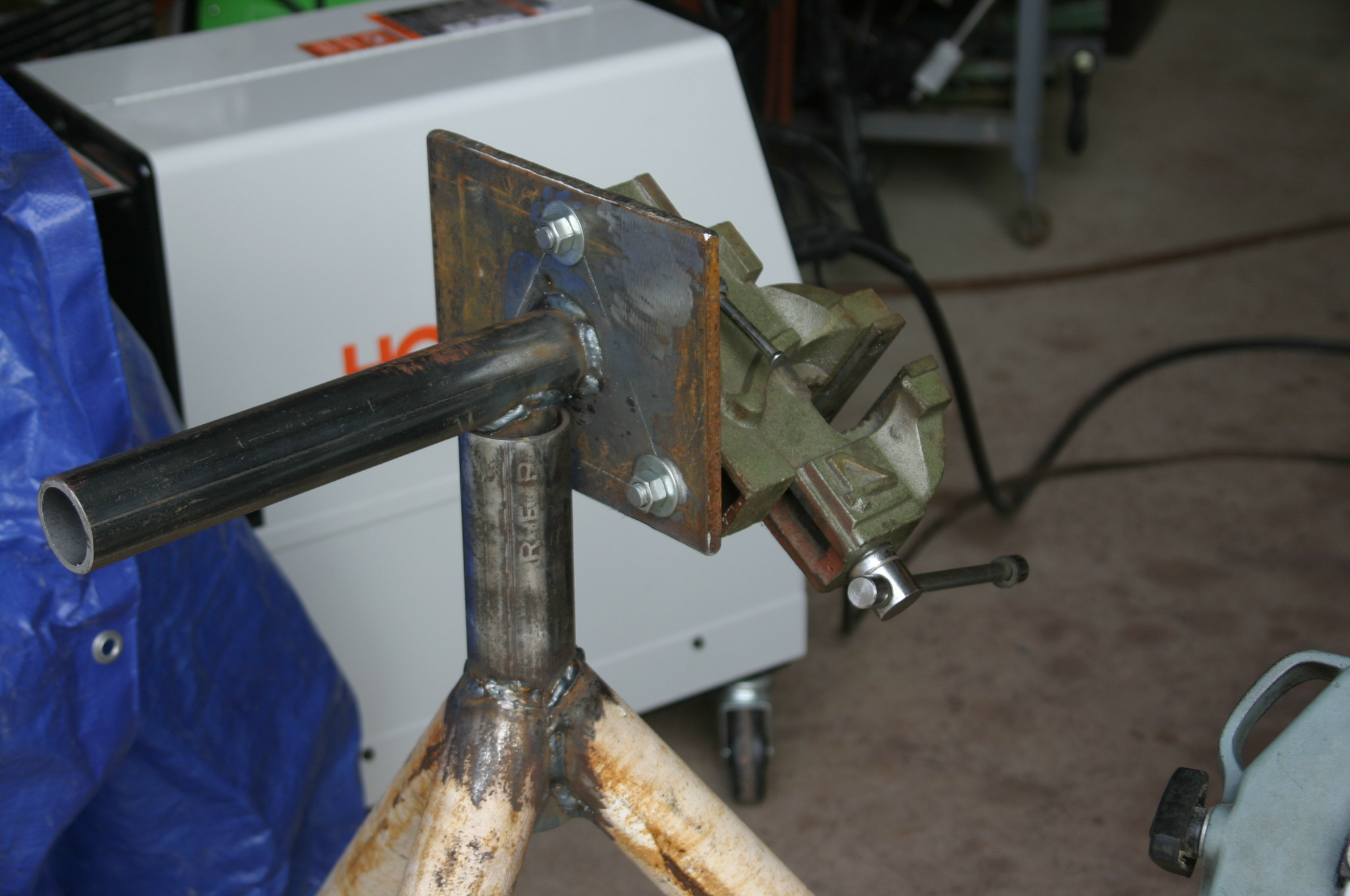

I was looking at these notchers and thought I should be able to use a drill press for this. I needed to notch 1/2 pipe at 45%. I tilted the table to 45% and clamped my vise in place. On the third try I had a good cut. It was more time consuming than a notcher but It worked. the first two tries were not accurate because I use the wrong size whole saw.
