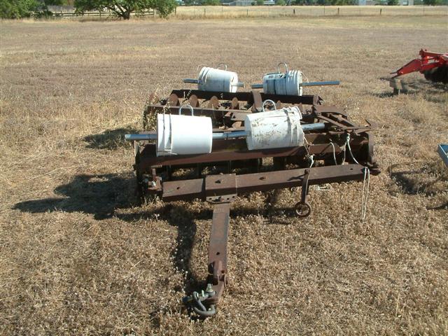

Weight and high ground speed are the first considerations. My old 6.5 ft Towner offset pull disc has smooth discs and is pretty heavy itself (they used a lot of iron back 70 years ago). I added about 500 lb of extra weight (four 120 lb concrete weights) and run it 5-6 mph with my Mahindra 5525 to get it to bite decently.
