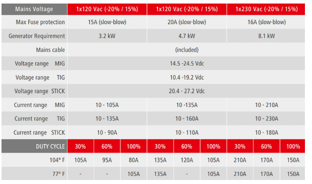

Look at the Fronius TransSteel 2200. Multi process, multi voltage, very good duty cycles. 150 AMP on 220 is 100%. See other duty cycles below.
Can put 4 and 8" spools on it.
I never welded before I purchased mine. So far have just used the synergic modes. I only do aluminum, and that's why I purchased it. It has 13ft lead, no spool gun needed. Does all your steel wires and such, has a ton of synergic modes as well as manual settings.
They do seem a bit pricier than other brands, and I have no experience with other welders, but I'm very happy with it. Very nice welder, quiet, fan on demand, easy to use.
Downsides, you likely won't find a local retailer selling consumables... but honestly, I don't have any other brands close, and everything is online anyways.
Does not have AC tig (for aluminum), but can do DC tig.
TransSteel 2200 - duty cycle. I would be very frustrated if I had a welder where I hit the duty cycle a lot. I do mostly 1/8" walled tubing... so I never hit it.
Portability is great, bakersgas has/had a video demonstraing how they used it on 300ft of extension cord on a 110v circuit. I mostly just use mine on a 220v 50 amp oven outlet. Though, I have welded with it on a 110... your only limitation is how high you can go with your amps.
