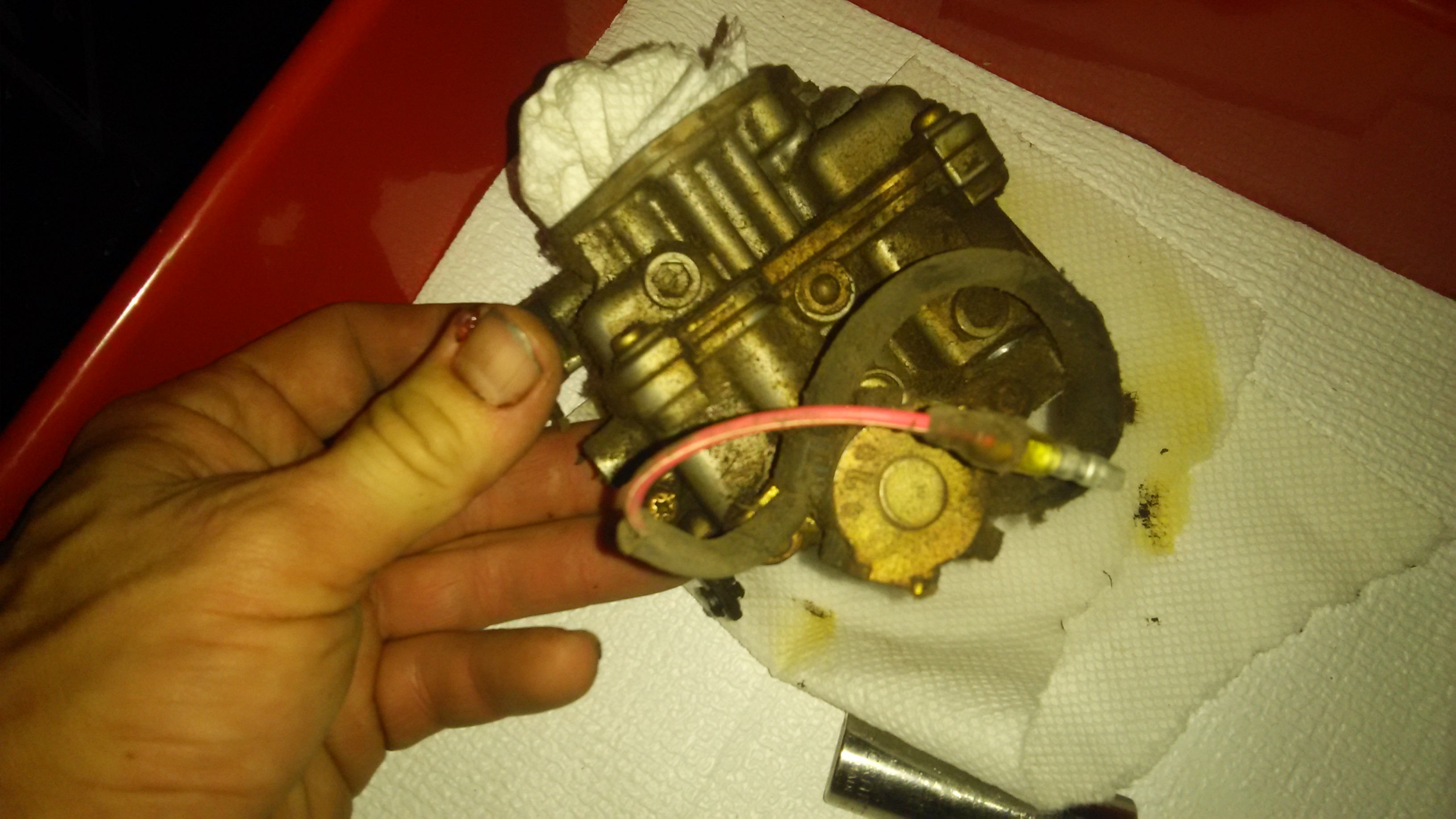

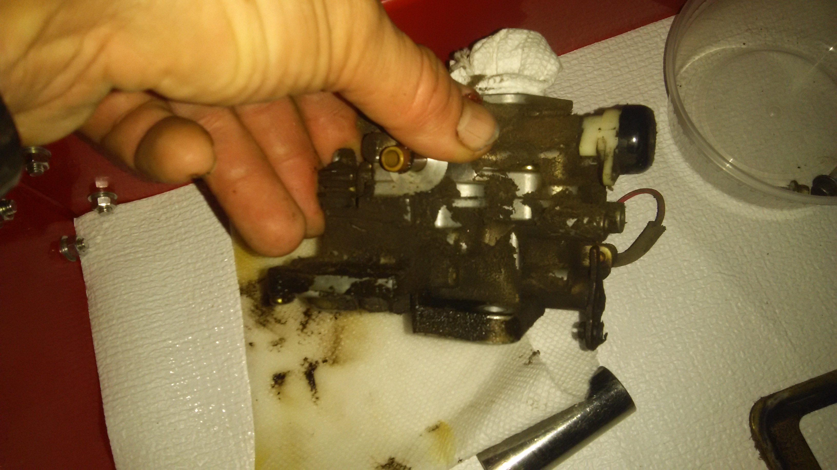

when I hold the spark plug against the head bolt and crank, I get a big fat spark. I have fuel spitting out of the fuel line downstream of the pump. I have 85-90 lbs of compression. I figured it's gotta be the carb. When I got home, I charged the battery, checked for spark again, and sprayed some carb cleaner right into the cylinder through the plug hole - then put the plug back in and tried to crank. Nothing.
So I started taking the carb off. When I got the carb off, I noticed a bit of fluid in the intake manifold. The carb was filthy on the outside. Took it to a clean bench with lots of tupperware containers . . . DSC_0017.jpgDSC_0018.JPGDSC_0019.JPGDSC_0020.JPG

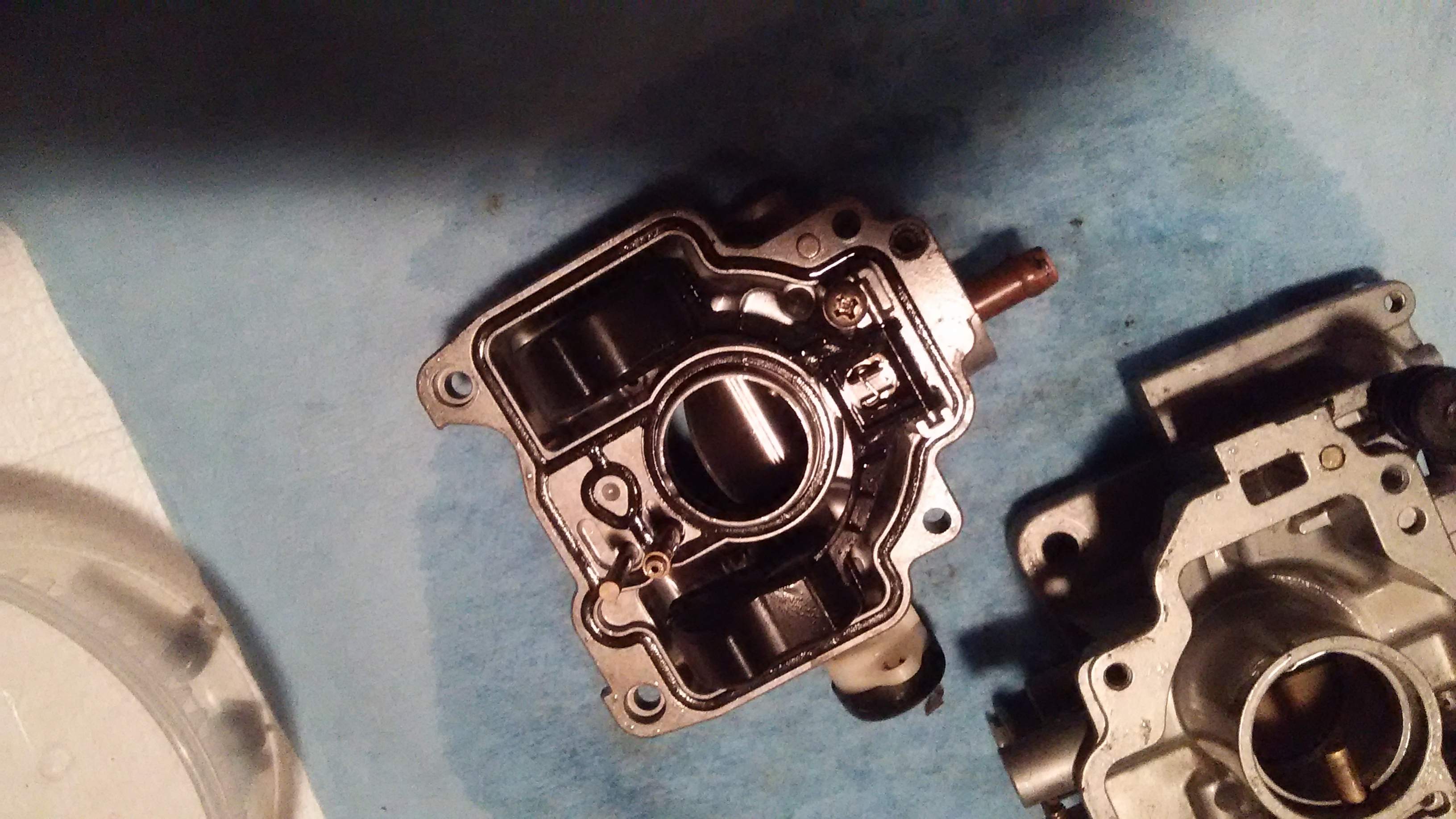

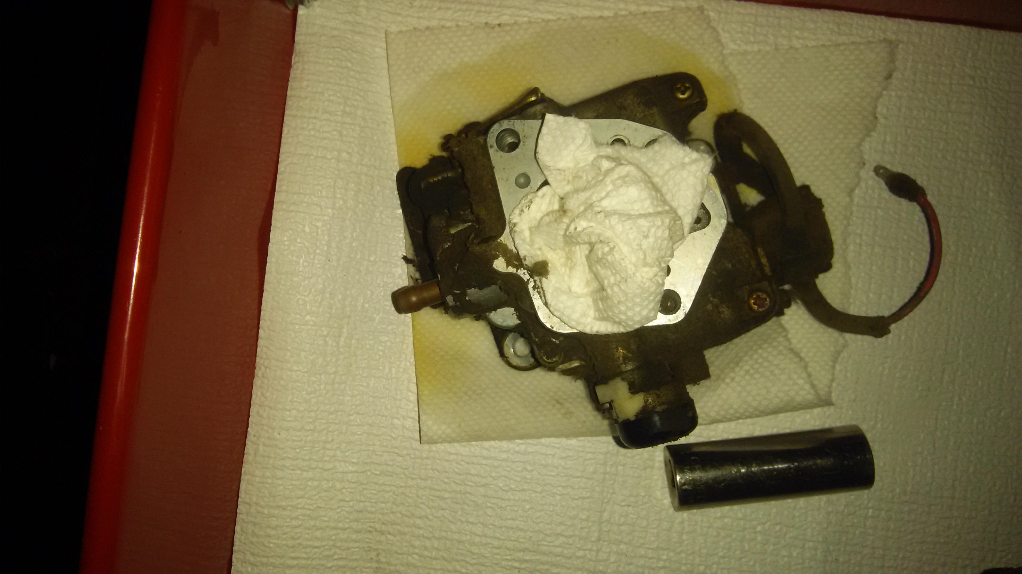

The carb was so dirty on the outside, I was convinced something was sticking in there. I took off the accel pump on the bottom and separated the main carb body to get to the floats. It appears immaculate in there! I am completely stumped. I guess I should clean out the carb really good with fluid and air, and put it back together to see what happens. I'm not sure what the electrical component is on the carb that I had to unplug, or if it has any bearing on my problem. Haven't searched the engine manual yet though. (and because Murphy rules, I "temporarily parked" the PT in front of other vehicles I need to move!) It's gotta be either something tragic, or something simple . . .DSC_0022.jpgDSC_0021.jpg

The thing about a carb is that all it takes is something small... Really small. I would do the teardown just for good measure. And yes, you will soon learn that the only time the PT lets you down is when you desperatly need it or it is completely inconveniant to repair (Actually I think this is a rule for any tractor - Never had one break down in the shop, it was usually fully loaded in the back 40 in the middle of a muddy field).

I'd be checking that fuel solenoid to make sure it is functional and not sticking on you.
X2 on Woodlandfarms comments about how small a particle you need to gum up a carburetor jet. It can be really, really tiny, which means when you do the tear down and rebuild, the area has to be really, really clean and free of dust, including cleaning the fuel lines and solenoid so that you don't wash more crud into your nice clean carburetor.
