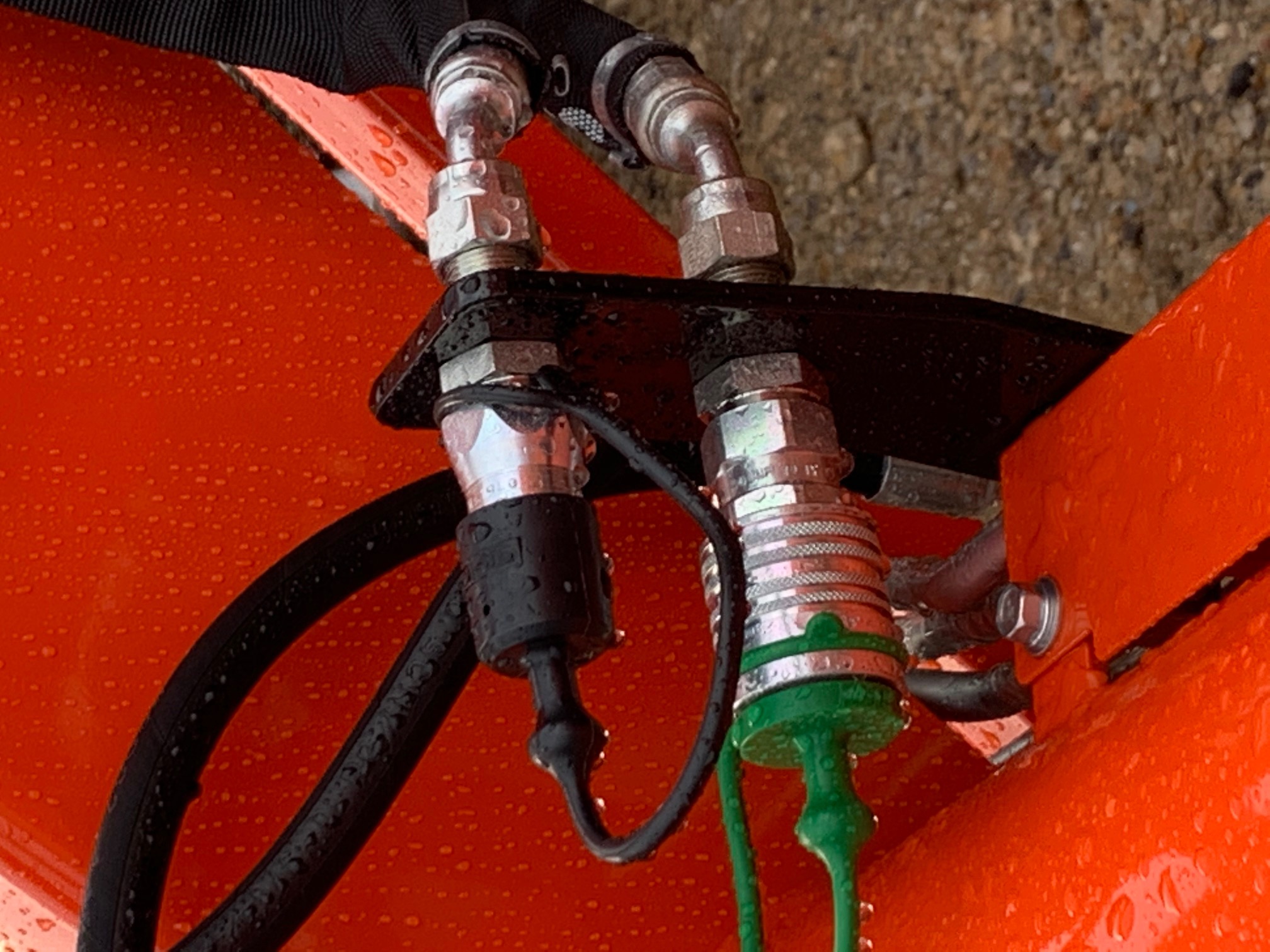

Boy Howdy I am really finding out things I didn't know, I didn't know. Here are the connections they put on. I am assuming these are the correct fittings.
Before you order try to figure out which style and size connections you have and request compatible connections be installed on the grapple. Alternately ask them to leave them off and apply a credit so you can buy your own fittings local. Differences in Quick Couplers Hydraulic Valves - Dynamics You can flip the connectors to either hose to change which button opens or closes to meet your preference.
I assume your tractor has the skid steer quick connect but make sure of that when ordering.

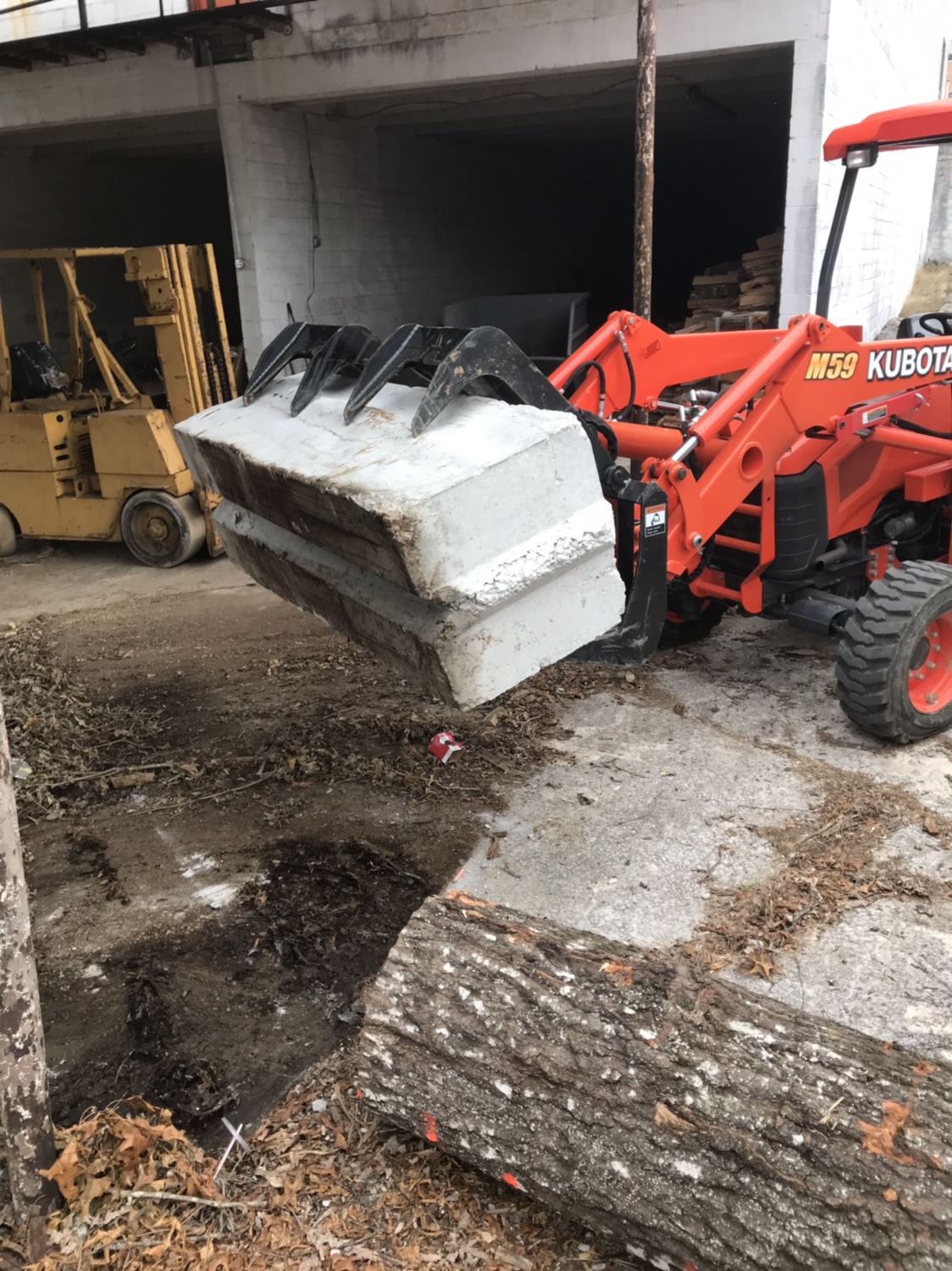

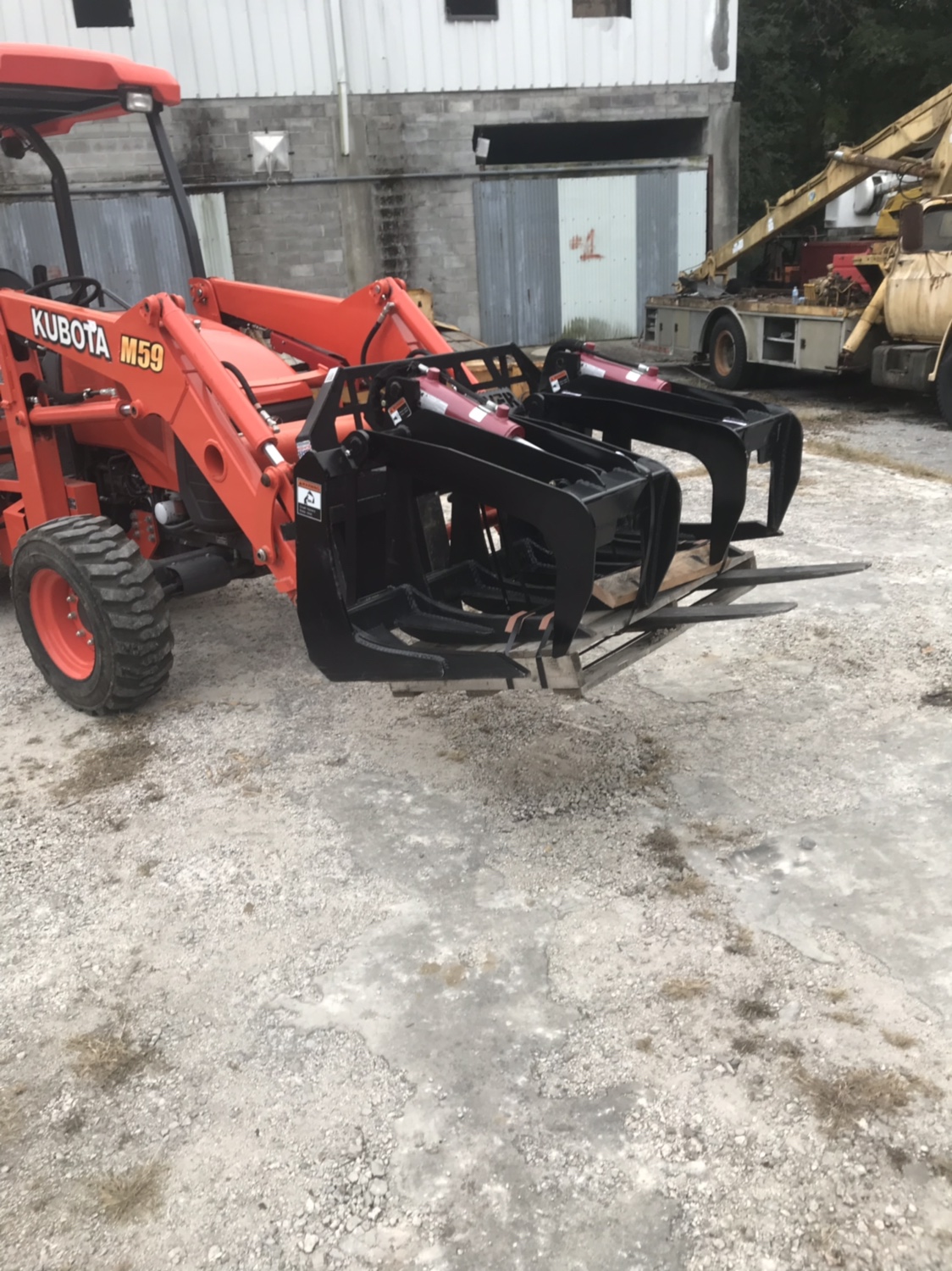

If and when I need a grapple I run to the wife's work and pick one up.............. 0828160917-00.jpg
