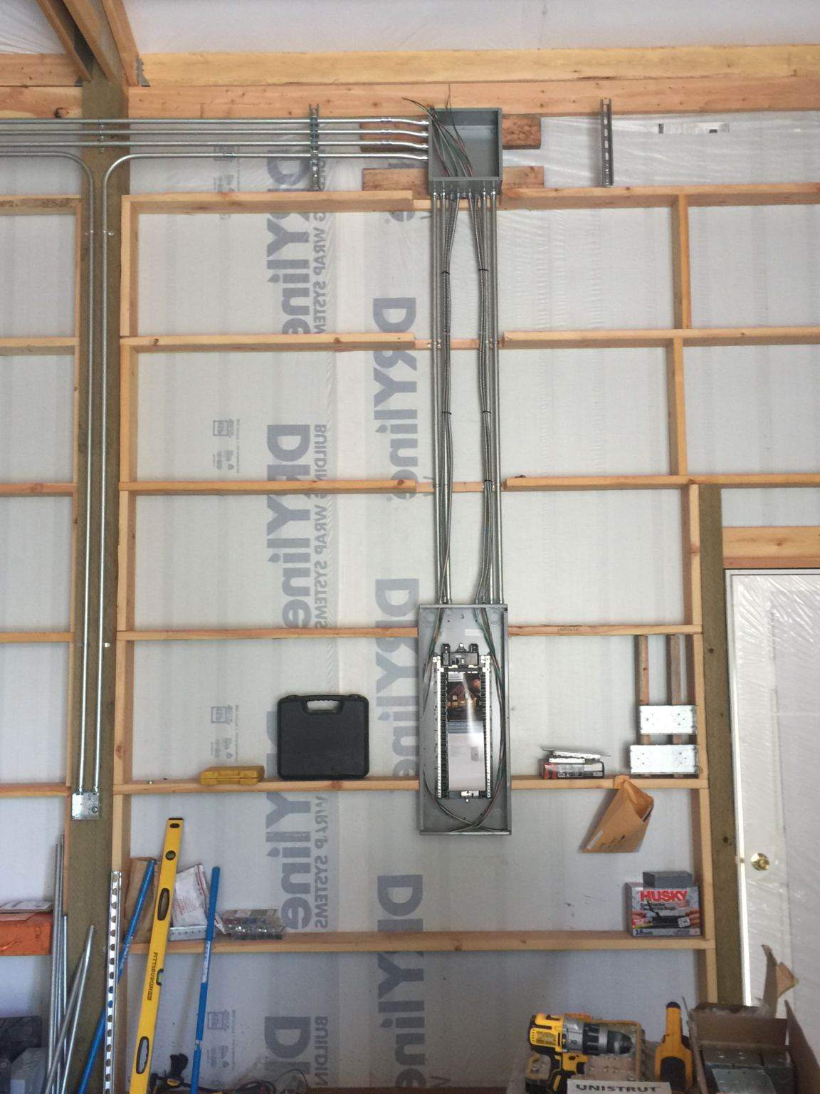

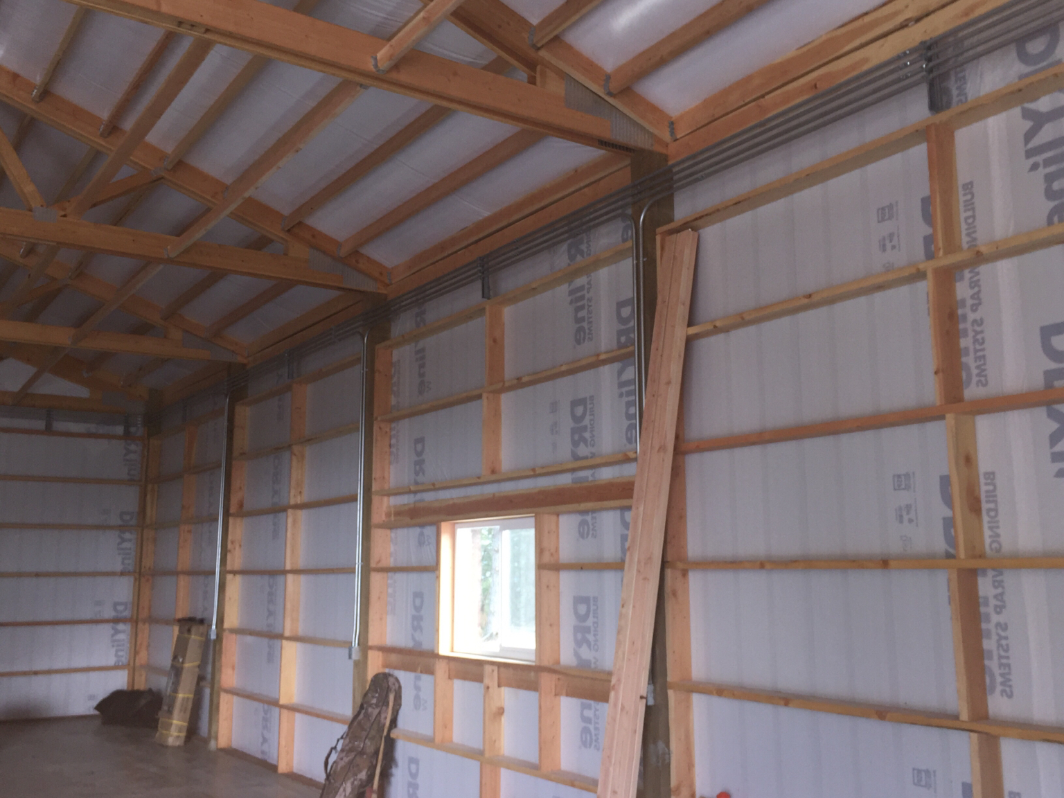

I went the conduit and up/over route- I would argue much easier to expand and or troubleshoot than buried but to each his ownImage1534425939.602945.jpgImage1534426017.419790.jpg

   / Now ready for the concrete in the pole barn #58
Agree, very nice looking conduit. It even looks hard piped commercial. Nice.
   / Now ready for the concrete in the pole barn #59
It is commercial-decided that the cost differential wasn’t significant enough not to step up
   / Now ready for the concrete in the pole barn #60
Well, you will never have a problem with it, well protected. Well worth it.
