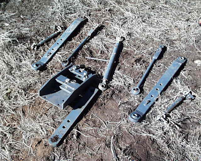

Part of why I have so many questions and so few few answers for those helping me is that I've never removed the hoe. A new adventure awaits. Hope to get to that today or tomorrow. Going out to take pics of blade and what I can see w/hoe in place. Also the components I have to, hopefully, assemble the 3pt. hitch. Film @ 6
This is what I have. I came with the tractor and I don't know if anything is not there. There is one item with pillow blocks on either end and it's sort of like a turn buckle. Is that the top link? I have a position contol lever with numbers on it on my right. I assume it's to raise and lower the hitch. PIC00013.JPGPIC00016.JPG
It the hitch parts shot there are two long grey arms about an inch thick with pillow blocks at the ends. The large pins in the blade attachment brackets fit these holes. Another good thing I guess.

From your picture, the outer two goldy colored pieces are the lift arm sway links. They mount to the lift arms and to the tractor frame to the outside of each lift arm mount. These keep the implement, in your case the back blade, from moving or swaying to the left or right The next two in are the lift arms. These mount to the tractor where you should have two pins and the other end mounts to the implement lift pins. The third in from each side are lift arm links that attach to the tractor's hydraulic actuated lift and the lift arms themselves. Normally one of these are adjustable so you can tilt the implement up or down from side to side. The center one is the top link. Mounts to the rear center of the tractor just below the hydraulic lift arms and above the PTO shaft. The heavier looking box piece in the center is the draw bar mount that mounts/bolts to the center underside at the rear of the tractor frame. The heavier bar just to the right of the mount is the draw bar itself that goes into the draw bar mount and is held in place by the approximately 1 inch diameter pins with the wire retainers. The front plate on the draw bar mount has one hole where the draw bar can pivot. It's towards the front of the tractor. The rear has three holes allowing you to move/pivot the draw bar so you can pull directly in line or off to each side.
Is there a way you can look at someones tractor or stop at a dealer? Even if it's a different model or other brand, all these parts will become very apparent as to where they go and how they work. By the way, the blade looks nice.

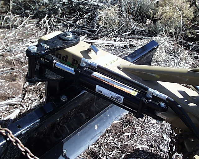

What sort of control valve specs would I need to operate that cylinder on the rear blade if I can find something at northern tool? There is a Brand Directional Control valve rated @3000 psi @ 99 bux. I'd prefer a dedicated valve over swaping hoses from the Joy stick if it's financially possible at a figure WAY under 600.00
Ck20 specs call for 7 gpm and 2500 psi :cool:

Thank you very much Victor. One of the trade offs of living in a very low pop. density area is long trips for nearly anything. I do have a friend who works a the county maintenance yard and he may be able to help with the assy. if I get in trouble. Your description of them will get me most of the way, and, just standing there and looking at the thing in my hand and the tractor may get me the rest of the way.
I got very discouraged this afternoon looking an Brian's fitritehydraulics page. The hitches on those tractors look to me military grade and way out of my price range. I worried that this stuff in the picture would not support that blade properly, but your description gave no indication of inadequacy. Hope I read you right. I'm getting beyond my finances with this endeavor as it is. But I sure would like one of his set ups. Looks like he does very nice work.

You'll have no problem lifting the blade with your 3PH. The capacity is high, so don't worry about it working. (for instance, my DK-40 can lift 2500 lbs. at 24"). I would bet your blade weighs around 6-800lbs. max?
The little welded on chain clips of the 2 lift arms face IN toward each other so a chain can be used, if desired, to keep them from moving apart. Chain optional. The adjustable link, (part 31, see diagram in link below) for the lift arm goes on the right side when facing the back of the tractor.
