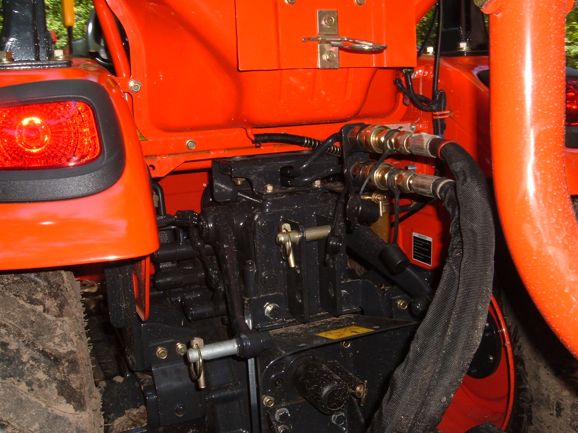

Also I was concerned about the two B.H. supply hoses being hard to get at where they live on the rear axel.
Ron

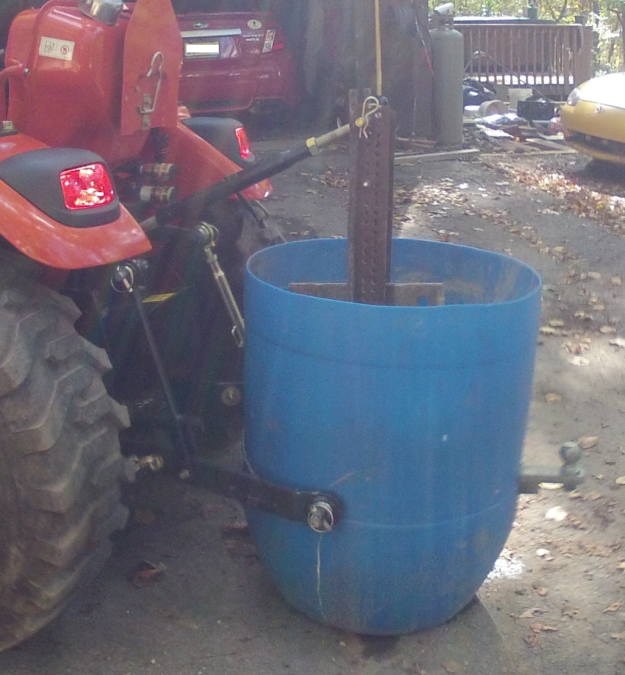

Removing the BH is pretty simple. A first step (I have forgotten) is to make sure the two pins (#7 in the diagram) are free, not under stress so they are easy to pull out. Then it's a question of using the stabilizers and the bucket to unload the BH weight from the tractor, and as CM said slowly drive forward to disengage the subframe from the rear and center connectors. When it's clear, shut off the tractor and disconnect the QC joints (I release the pressure in the lines with the remote valve control. IDK if that standard or necessary).
I find connecting the BH again to be more challenging. Having a level space to disconnect/connect makes it much easier as would blocking it up with pallets or 6X6 blocks.
This pic shows enough of the lift arms as well as my ballast bucket GOPR2003.JPG

I've pulled my hoe on and off a bunch and I've used box blade tiller and snow blower with my tractor
When removing hoe don't forget to unplug the line going from the loader to the hoe and plug the loader line into the valve block under your right foot
Your three point will lift a ton of weight literally I think rated at just over 2k
Lifts and supports my 800lb blower like it's not there
