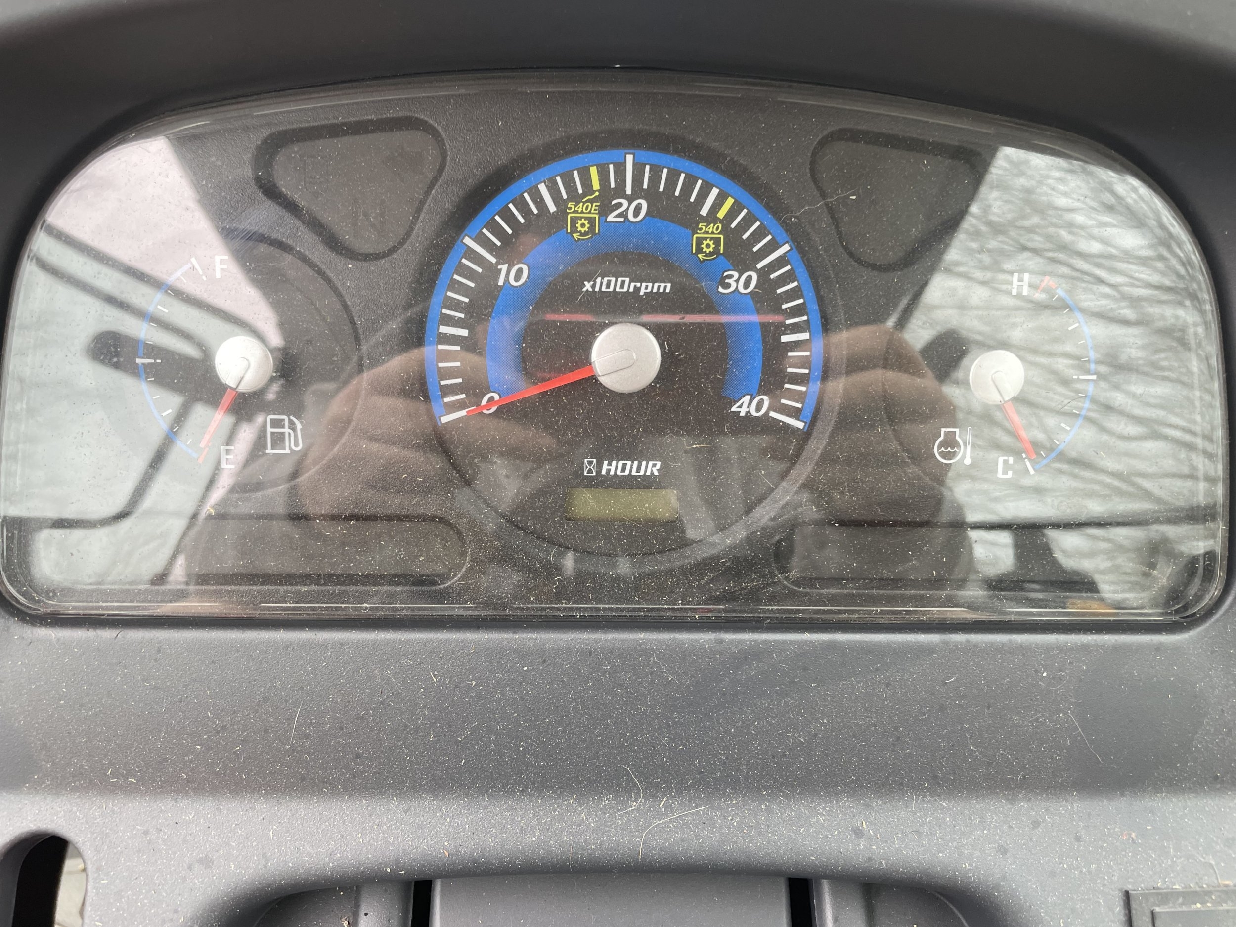

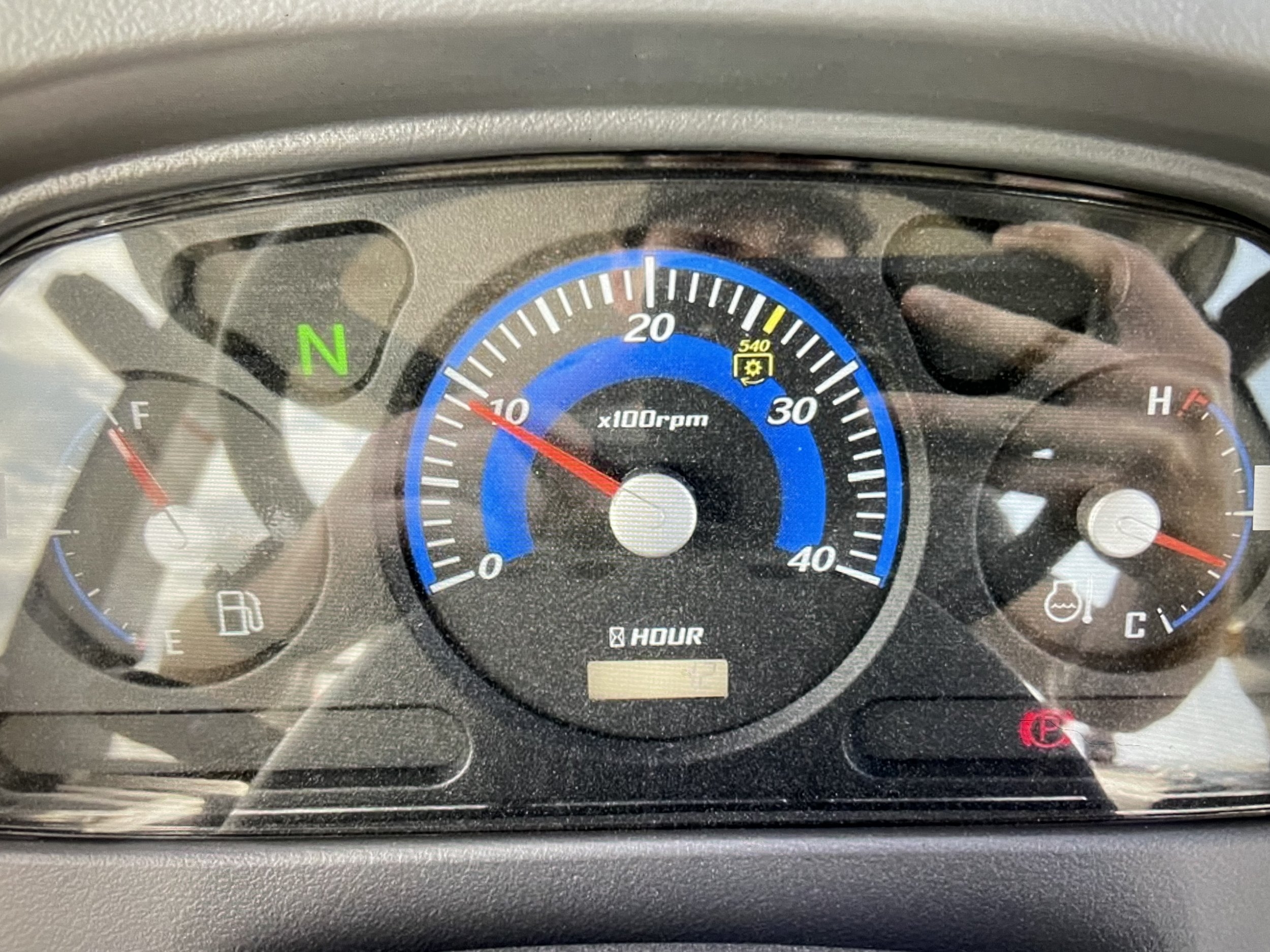

I didn’t see anything about this in my owners manual, however, the DK does have an indicator at the 1800 mark. Now that I’ve looked, I am surprised they use 2 different meters. I run mine at and above 1800 and no I am not a believer of the e-pto. IMO, pto powered is at full pto speed, not a guessing game on torque curves.

But, EPto is full 540RPM. Just like PTO is 540RPM.
I use EPTO when tilling our non virgin clay loam. I really don’t need full power to do it.
The A2300N2 chart shows max torque/hp is at 1900 RPM. So Epto on many compacts will actually maximize torque, with less HP for sure, and better economy.
