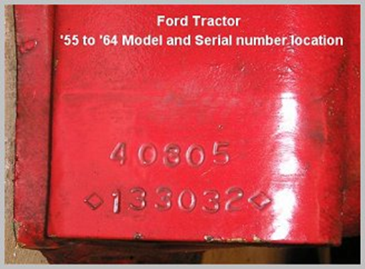

Had to remove a lot of paint. Found the Ser.#'s I believe. L. side Trans Housing. By the Starter 1201 ? Then below it 31038? On the Eng. block L.side CONN 60150. Clutch is stuck and with a FEL. front mount Hyd. pump it's going to the shop this Wk.. Major Fbomb. Man had it for months and no mention of it. Shifter problems is what was told to me. My search which I only had it a few days. I come up with 1963 ? 4cyl. gas. 4Spd. Rev.. Best place for manuals would be nice info. for it Both Owner Parts/repair if need be. Loaders working and seems to be running good. 12V. also. There is a Rev. problem. Have to turn it off to get it to lock in ? That's wierd to me of course. I'm thinking Shifter problem ?. Any Info or IMHO would very Appreciated.

You can download a free owner's manual for it here: https://www.ntractorclub.com/manuals/tractors/Ford 4000 Owners Manual.pdf
Here's how to decode the model#:
First number (1 digit)
2**** - 134 ci gasoline or 144 ci diesel engine
4**** - 172 ci gas, LP-gas or 172 ci diesel engine
Second number (1 digit)
*0*** - Industrial models produced prior to 1963
*1*** - Industrial and agricultural models produced after 1963
Third number (2 digits)
**10 * - Row crop
**11 * - Offset
**20 * - Utility-type w/adjustable front axle
**21 * - Orchard type w/ non-adjustable front axle
**30 * - Utility-type tractor w/non-adjustable front axle (light industrial)
**31 * - Low center of gravity (LCG tractor)
**40 * - Heavy duty industrial tractor w/sub frame
**41 * - Heavy duty industrial tractor w/sub frame & cast grille
Last number (1 digit)
*1**0 - Four-speed w/o PTO
*0**1 - Four-speed w/o PTO or hydraulics
*1**1 - Four-speed w/PTO
*0**2 - Four-speed w/hydraulics, w/o PTO
*1**2 - Five-speed w/live PTO
*0**3 - Four-speed w/hydraulics and PTO
*0**4 - Select-O-Speed w/o hydraulics or PTO
*1**4 - Select-O-Speed w/o PTO
*0**5 - Select-O-Speed w/hydraulics and single-speed (540 rpm) PTO
*0**6 - Select-O-Speed w/hydraulics, 540 and 1000 rpm PTO and ground-speed PTO
*1**6 - Select-O-Speed w/two-speed (540 and 1000 rpm) independent PTO
*1**7 - Select-O-Speed w/540 and 1000 rpm independent PTO and ground-speed PTO
*0**9 - Five-speed w/live PTO
Suffixes
-1 - Tricycle with single front wheel
-4 - High clearance with wide front
-L - LP gas engine
-D - Diesel engine
Thousand Series tractor serial numbers -
1962 Serial number 1001 - 11947
1963 Serial number 11948 - 38930
1964 Serial number 38931 - up
Part number identifiers cast into 134 and 172 engine blocks (lower right side)
EAE 6015 - 134 1953-1957
EAF 6015 - 172 1953-1957
310905 - 134 1958-1959
310609 - 172 1958-1959
B9NN-6015C - 134 late 1959 early 1960
B9NN-6015A - 144D late 1959 early 1960
B9NN6015J - 172 late 1959 early 1960
B9NN6015B - 172D late 1959 early 1960
C0NN-6015G - 134 sleeveless late 1962-1964
C0NN-6015H - 144D late 1960-1964
C0NN-6015C - 172D-G late 1960-1964
C0NN-6015J - 172 late 1960-1964

This Info. is what I found to get the Yr. model. Thanks for the Manual Much better. I may have seen this one but it didn't have the 2000 label. Have some good reading to do now. :)
