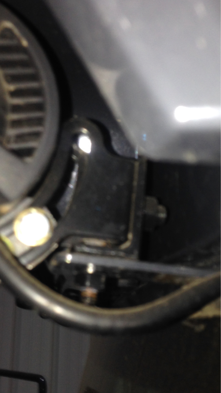

I used short pieces of aluminum angle to bolt the original led brackets to.
