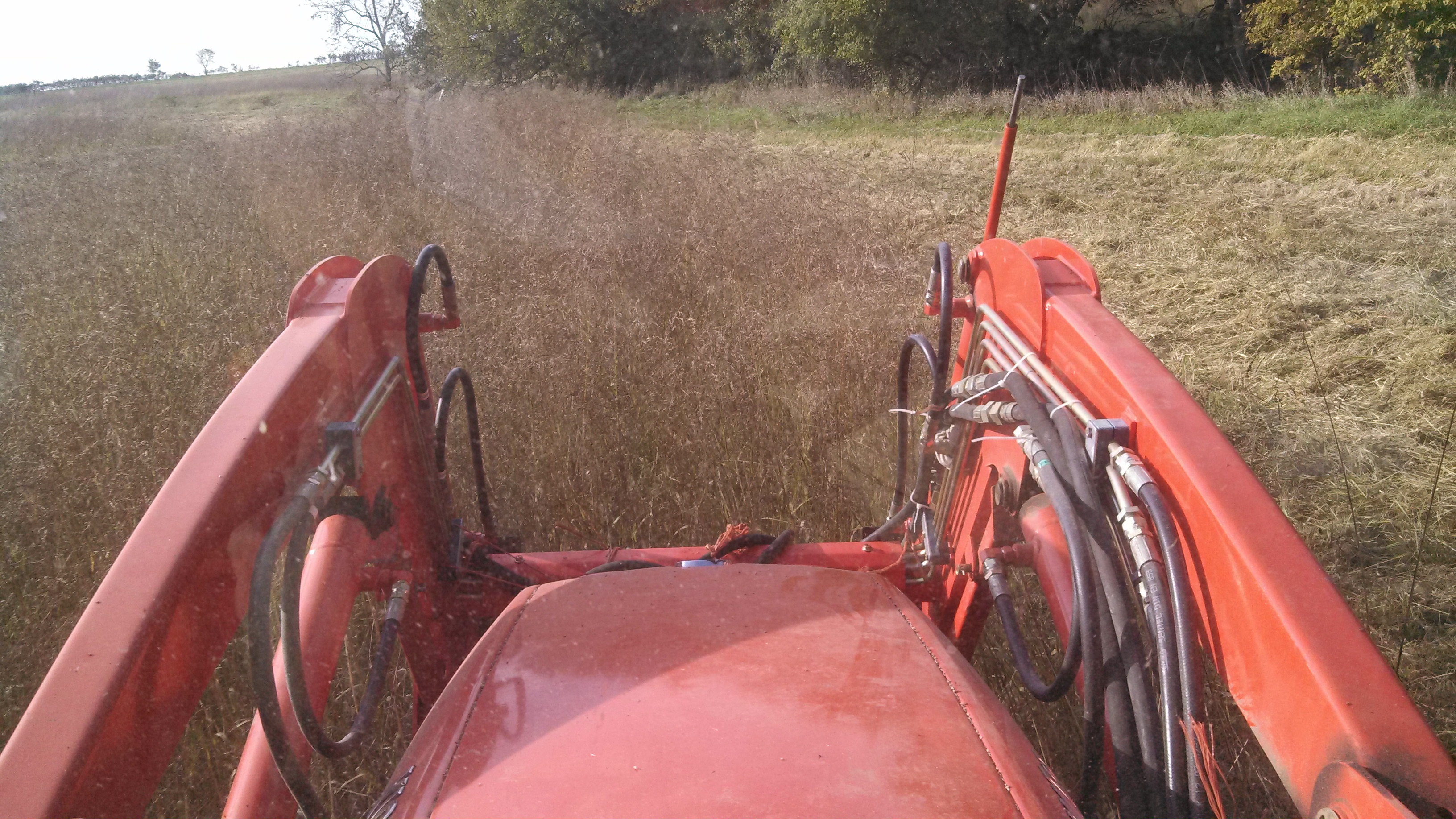

I like my 7 foot pull mower for the DK 45. Heavy enough to stall the tractor if I run it in the dirt without breaking the mower. picture is 5 foot bluestem and able to mow just fine. Neighbor was talked into a light 6 foot 3 pt kubota and has sheared bolts and had the rear wheel welded twice in two years. IMG_20161003_163310_461.jpg
