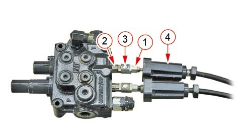

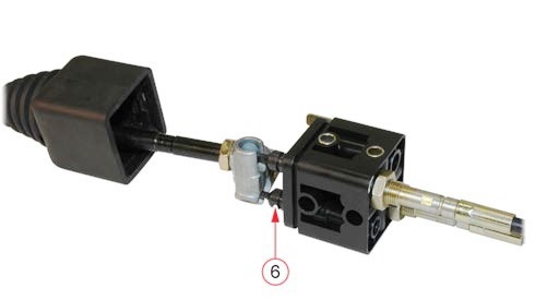

Jim and DieselBound, I haven't had to deal with this, thankfully, so I'm not visualizing which end of the cable broke. The shop manual shows the valve end, and the lock nuts that tighten against the cable covers (pic 1 below). Was the break just inside the cable covers, above where the cable pins to the spool? Or at the joystick end (pic 2 below).

Threepoint,

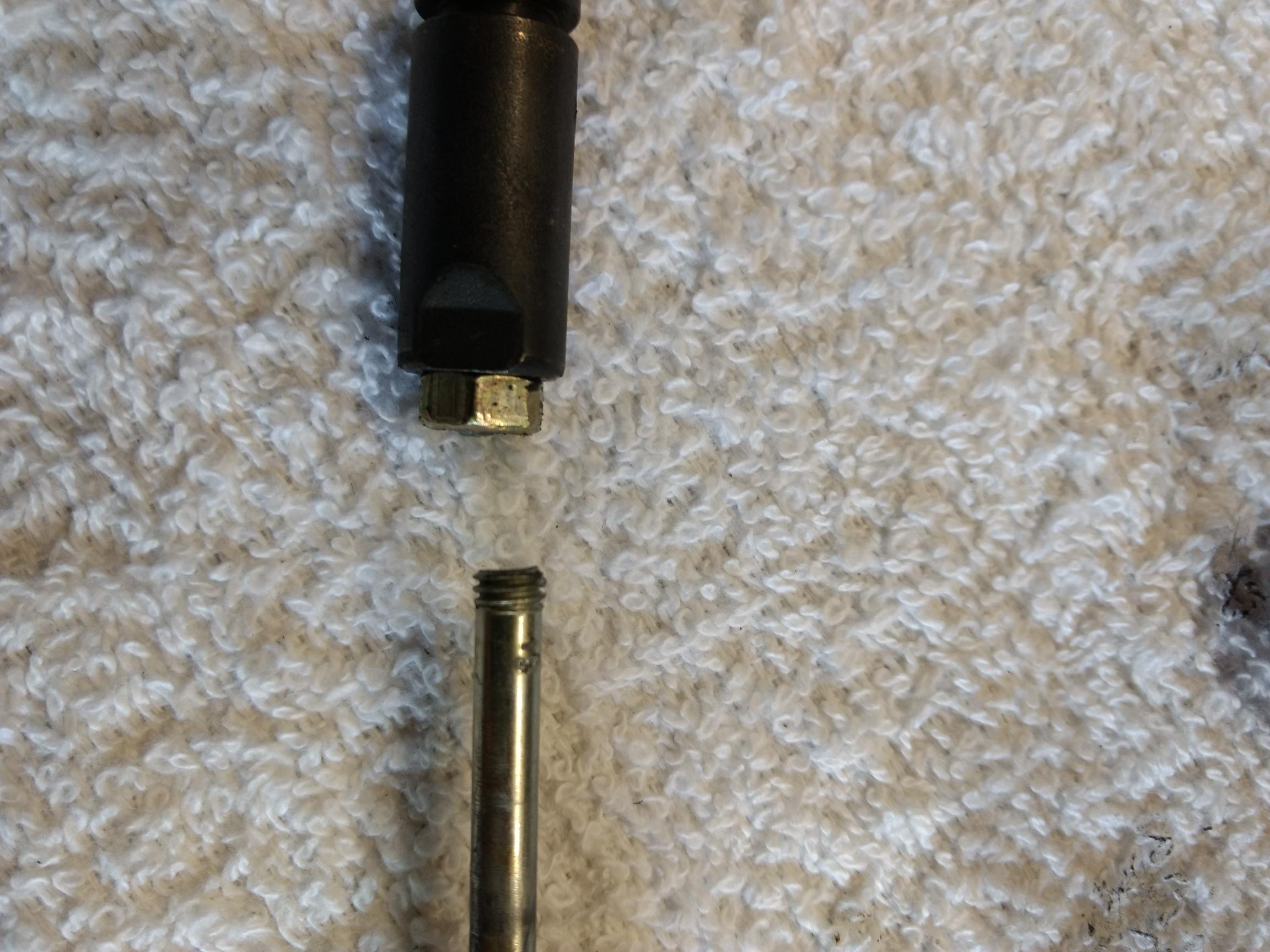

The break is occurring at the joystick end, just past that large adjustment nut. The cable has a threaded shaft end on it that screws in to the plunger(? not sure terminology), and that shaft also has a locking/stop nut on it: the break is right where that small (internal) nut and the plunger meet. Here's a picture of mine (hopefully it helps):

One note to help folks in replacing cables is that you have to remove the dummy plunger (joystick end). There's a screw (allen; really hard to see) in that plunger that one has to remove in order to free up that plunger. The service manual wasn't really clear on this (for me anyway) and I struggled a bit to figure things out.
Also, be sure to adjust the cable BEFORE buttoning things up! I adjusted the new cable based on measurements from the old cable and then buttoned things up only to find that I still need to adjust it (handle runs way to far to the right, to the point of hitting the handrail on the door:eek:).
That is exactly where mine broke also. The lock nut on the external cable sleeve was tight so that wasn't the issue. I knew about the Allen screw down under as mine had fallen out shortly after buying my tractor. The handle goes loose when that happens.
