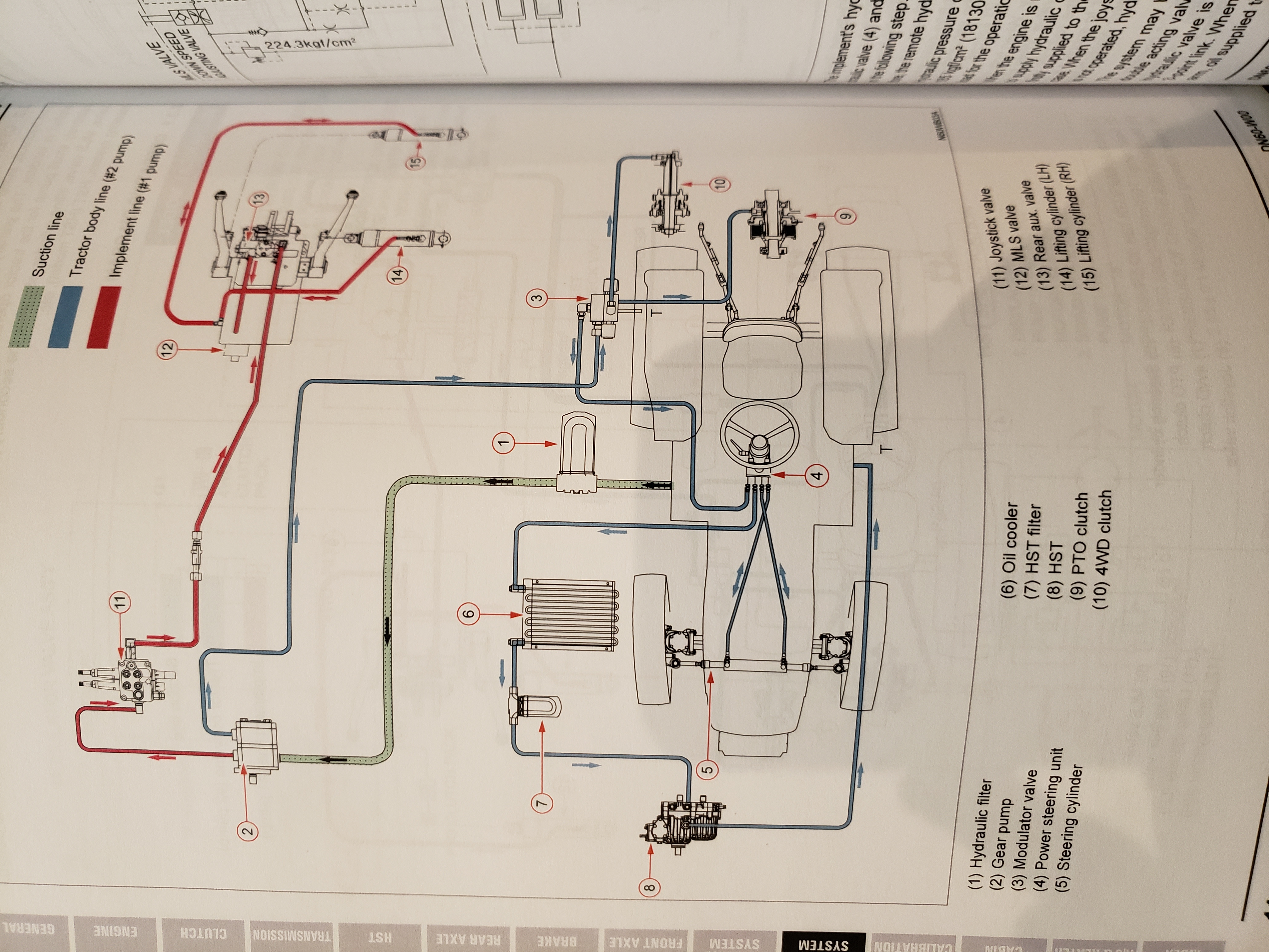

I suppose the most interesting thing to me is that both of the hydraulic pumps have failed. I suppose that points to particular causes of the failure. Other than the hydraulic pumps being bad, the only other possibility on my mind would be return fluid from the joystick valve or power steering unit. Depending on your tractor, both these return fluids from these two systems are routed not to the sump, but to the suction side of the hydraulic pumps. Meaning, that if the joystick valve relief, or the power steering relief were to be chattering with issues, foamed oil could be generated quickly by the immediate re circulation. As things warm up, the valves seat properly.
You will have to look at your particular tractors hydraulic diagram to know if this is possible, as not all tractors are this way. But as an example, here is a diagram of a tractor that has this type of setup.
It wouldn't be too much trouble ruling that possibility out with some basic knowledge. Finding the relief valves and simply feeling them for flow/noise while your issue is under way.
My money is still on bad pumps, but I think this is a possibility worth looking into.
   / NX6010 suction side hydro leak
#24

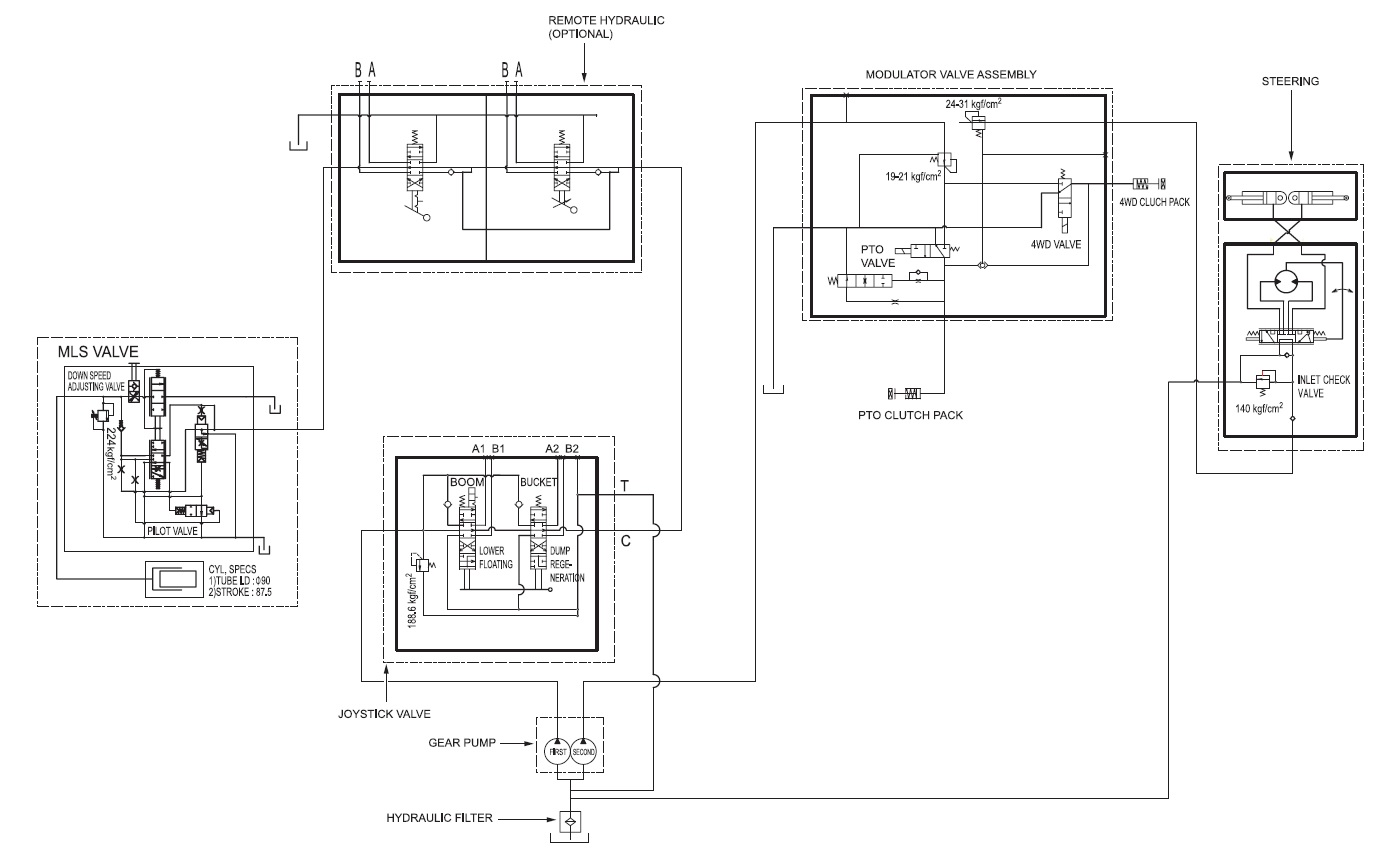

Not sure I know enough to read this correctly, but it looks like the 1/2 pumps are ganged together. Perhaps someone else can provide more details here?
   / NX6010 suction side hydro leak #25
Yes, its called a Tandem pump, as you can see in your drawing, pump #1 services your loader valve, then your 3pt hitch, pump #2 services your modulator valve for the pto, 4wd clutch, power steering, and then onto your Hst. If this is your tractors drawing, I can see that the particular situation I was mentioning earlier is not quite possible, as there are no immediate re circulation lines at play here.

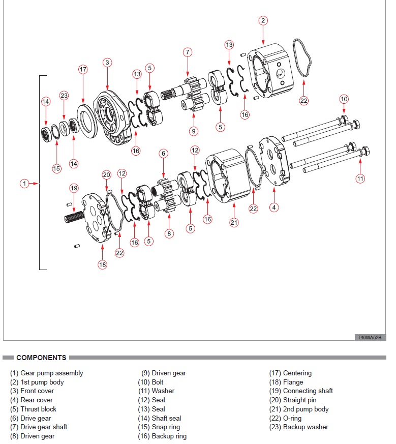

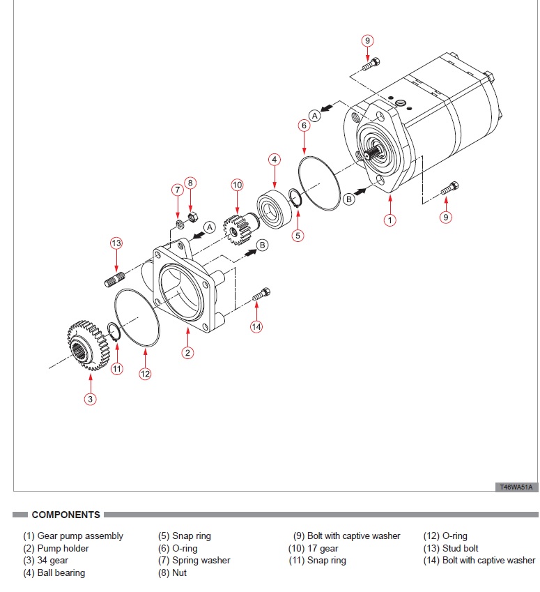

Here you can see the pumps exploded view

OK, makes sense, I wondered why I couldn't find the "other" pump, they are all in one housing. Learning something new. ;) Anyway, yes, the way I read that diagram, it's pretty much a straight shot from the sump to the pump(s). The only thing in between is the hydro filter, which, of course, is where I thought for sure I'd find the problem (especially the soft connection that I showed in the video). The dealer thought "chattering valve" too initially, but I suspect when he looked closer at the flow diagram, that was ruled out because there's no where for air to get in the suction because of the valve, they are all on the pressure side and return to the sump; a leak would be a stream of fluid, not air sucking in, right?
And yes, this is the drawing for my tractor, it's from my service (the big one) manual.
